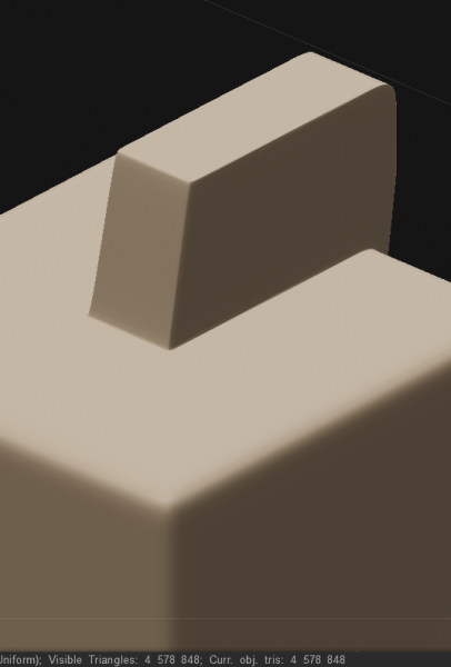

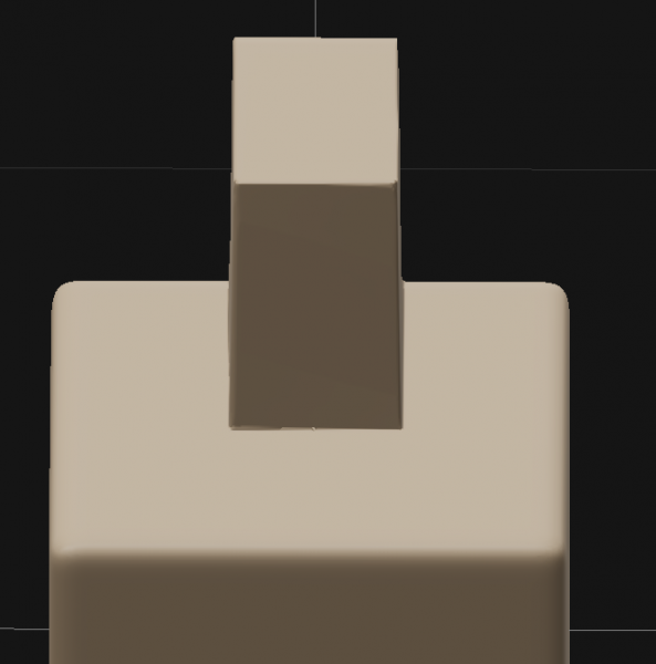

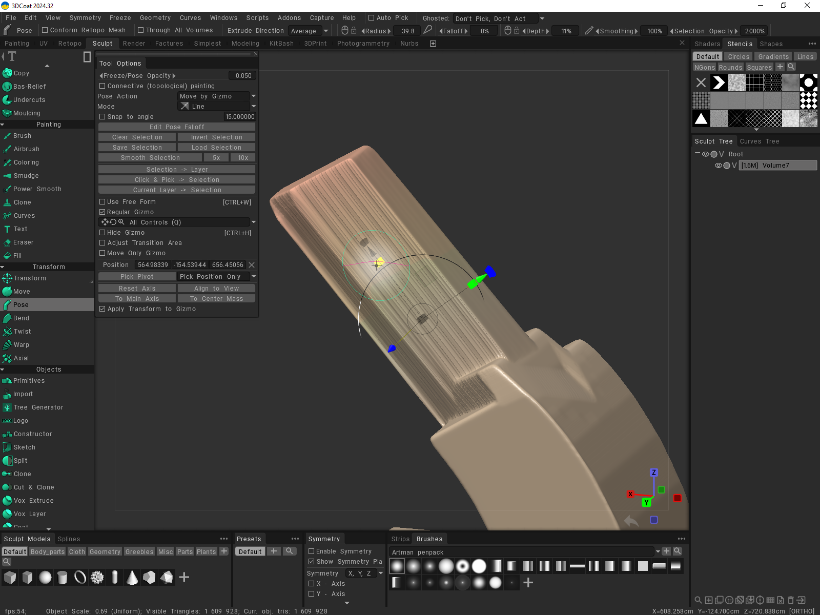

Member DiJa Posted February 16, 2025 Member Share Posted February 16, 2025 Hello I'm working with voxels in the sculpt room. When I extrude a section of a mesh using the Pose tool with different selection types I get alot of noise Doesn't matter if I smooth or not but I usually get a broken result, attached results Even if I increase the resolution the extrusion always comes up with alot of artifacts Is there any solution for this? I'm loving this tool but it's so unstable. Thanks! Quote Link to comment https://3dcoat.com/forum/index.php?/topic/31251-pose-tool-smooth-selection-noise/ Share on other sites More sharing options...

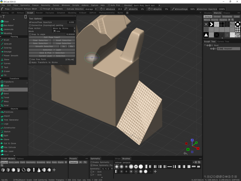

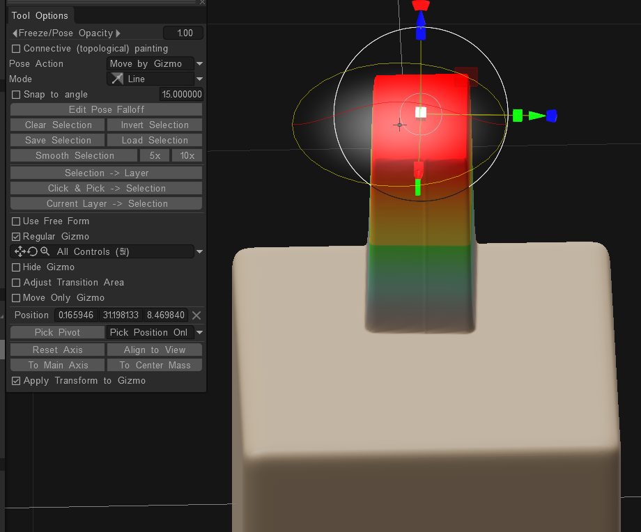

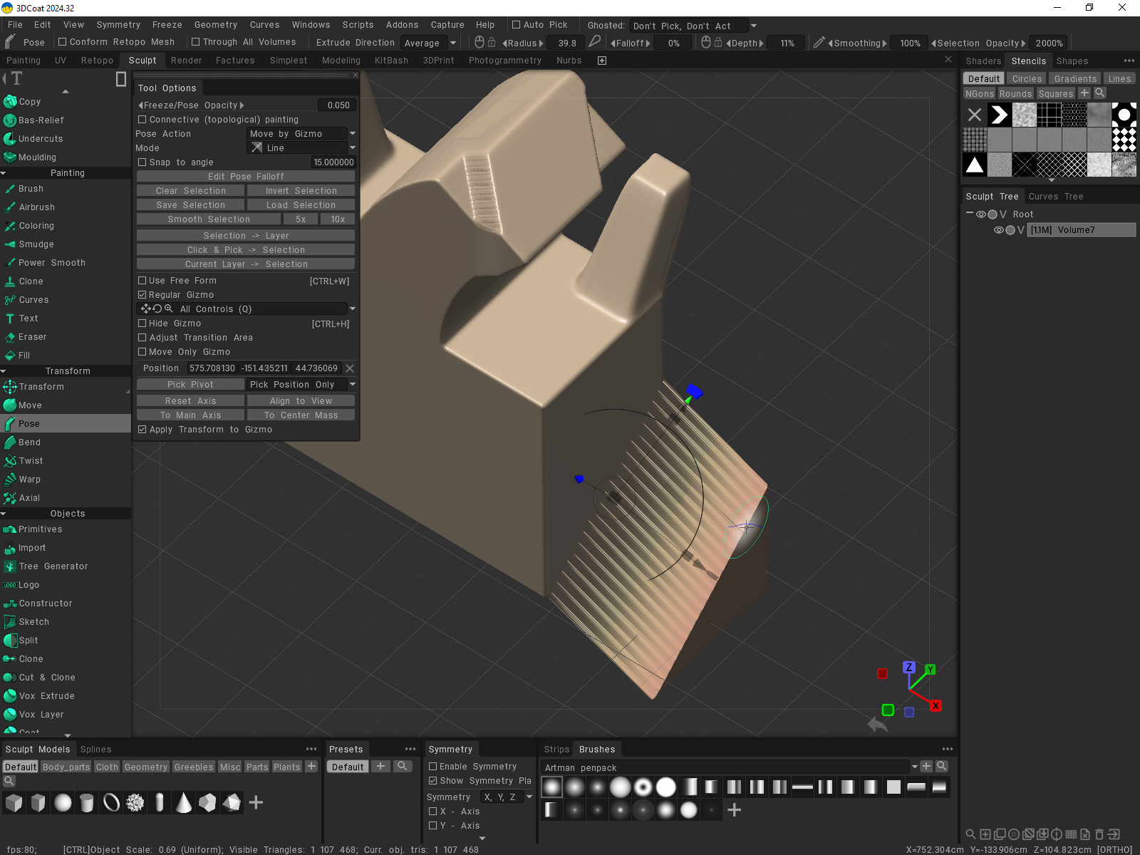

Member DiJa Posted February 16, 2025 Author Member Share Posted February 16, 2025 Hello Carlosan Confirmed selection smooth and no stencil selected, attached video to show my problem Meshes are correctly reset to global space / Uniform space It happens with dense meshes and lower density meshes, any direction of extrusion, no matter which alpha is used and with no stencil ative Posetoolnoise.mp4 Quote Link to comment https://3dcoat.com/forum/index.php?/topic/31251-pose-tool-smooth-selection-noise/#findComment-198216 Share on other sites More sharing options...

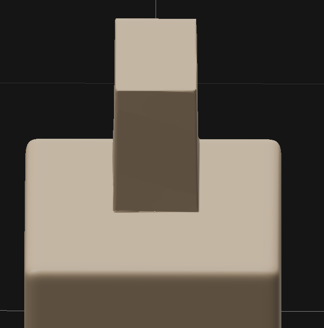

Carlosan Posted February 16, 2025 Share Posted February 16, 2025 With the default cube (you can also try with that model on a fresh new scene) After move the faces y pressed enter key Quote Link to comment https://3dcoat.com/forum/index.php?/topic/31251-pose-tool-smooth-selection-noise/#findComment-198225 Share on other sites More sharing options...

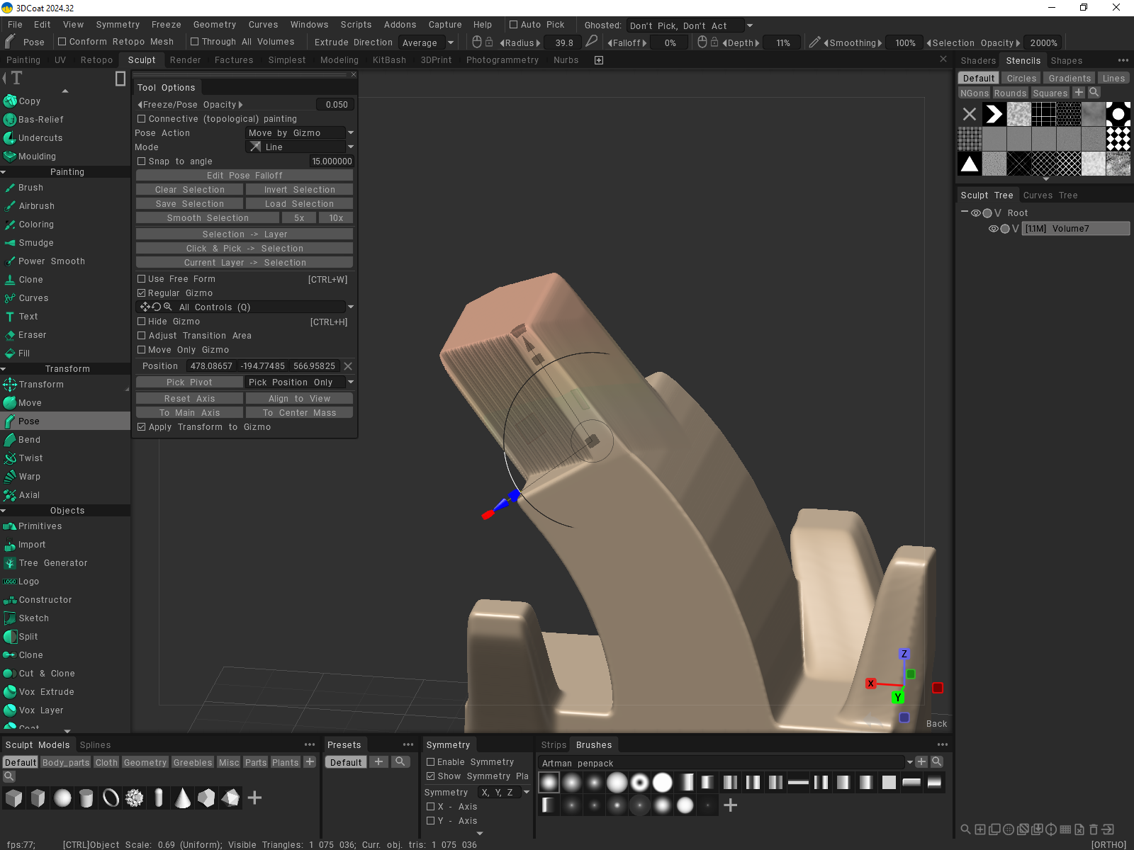

Member DiJa Posted February 16, 2025 Author Member Share Posted February 16, 2025 using the same settings and fresh scene, or with new shapes I generate, Extrusion always comes with an error and when working more on the mesh it's more apparent the errors. Attached demostration Posetool.mp4 Quote Link to comment https://3dcoat.com/forum/index.php?/topic/31251-pose-tool-smooth-selection-noise/#findComment-198226 Share on other sites More sharing options...
Carlosan Posted February 16, 2025 Share Posted February 16, 2025 yes, it is the nature of voxels this extrusion surpass the voxel cage one solution will be to change resolution to 11M+ or more but this step is hardware intensive Quote Link to comment https://3dcoat.com/forum/index.php?/topic/31251-pose-tool-smooth-selection-noise/#findComment-198227 Share on other sites More sharing options...

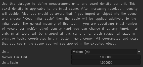

Carlosan Posted February 17, 2025 Share Posted February 17, 2025 What are voxels I am afraid it is not possible. Voxels produce a virtual grid in 3D space, and the mesh then occupies sections of this grid to form its shape. Voxel density and resolution Because the density of the mesh (the amount of cubes into the grid) is absolute and it is not relative, to smooth the geometry of a model you need to increase the density (grid resolution) of the entire model. Under the "Geometry menu > Define Measurement Units" are your voxels per unit and units scale ( not scene scale). Or you can get a better result working on Surface mode. This can be done by clicking on the [V] icon next to the particular layer you would like to work the surface of, and it will change to a [S] that represents this “Surface mode”. Extrude the model using pose tool and then use Smooth all command Hope this help Quote Link to comment https://3dcoat.com/forum/index.php?/topic/31251-pose-tool-smooth-selection-noise/#findComment-198236 Share on other sites More sharing options...
