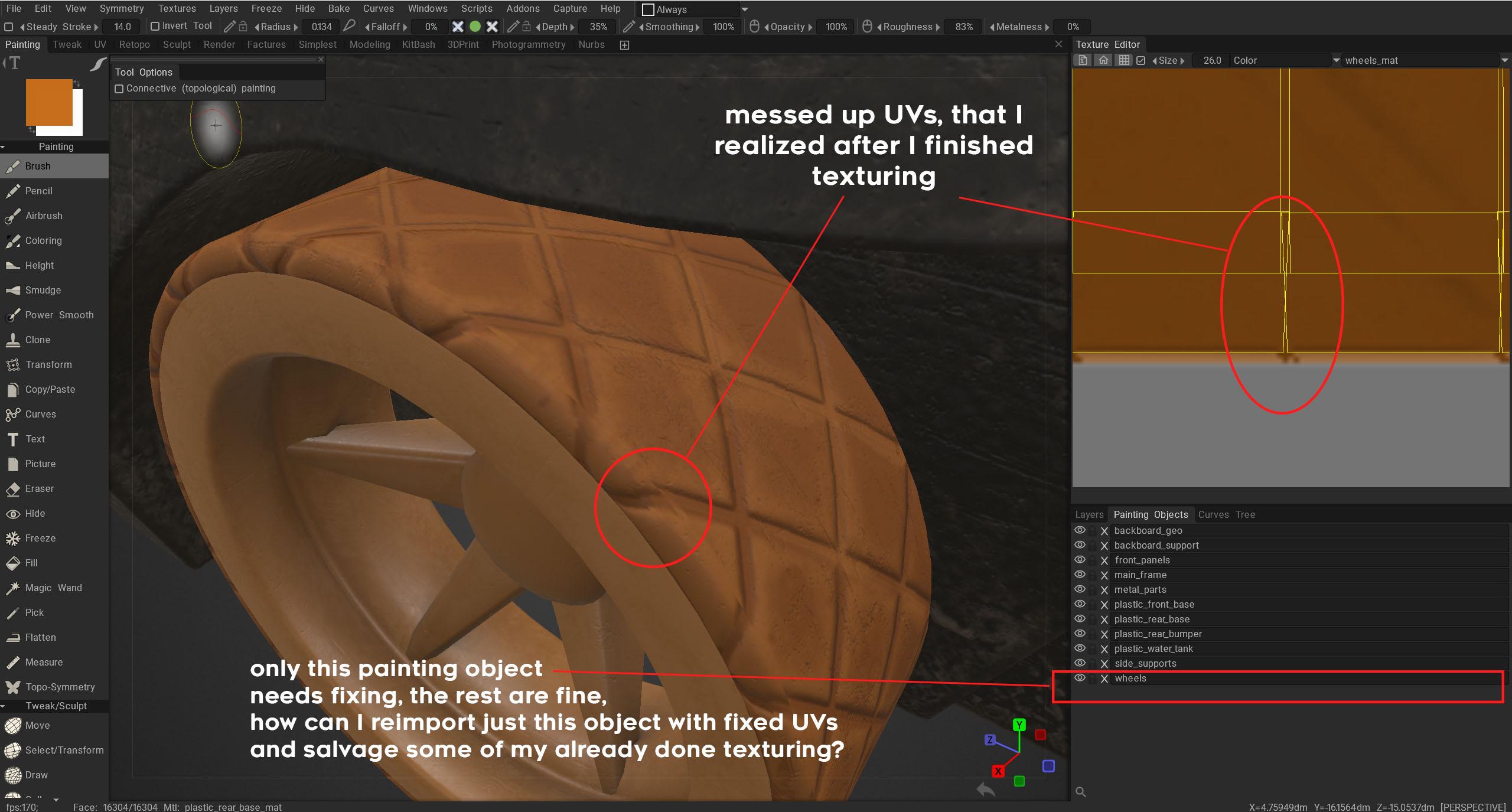

Advanced Member yoohasz Posted February 16, 2025 Advanced Member Share Posted February 16, 2025 (edited) Hi! I spent a fair amount of time texturing an asset, and only noticed that my UVs were messed up on a certain painting object. I thought that 3DCoat was buggy, and had to realize MY user error. I would love to be able to only reimport that single part of the asset if possible. These painting objects are all part of a single .FBX file So if anyone can help me on this topic, I'd be greatful. Thanks for any help in advance! Please see image attachment for clarification: Edited February 16, 2025 by yoohasz Quote Link to comment https://3dcoat.com/forum/index.php?/topic/31253-how-can-i-reimport-a-mesh-with-fixed-uvs-and-save-some-of-my-texturing-solved/ Share on other sites More sharing options...

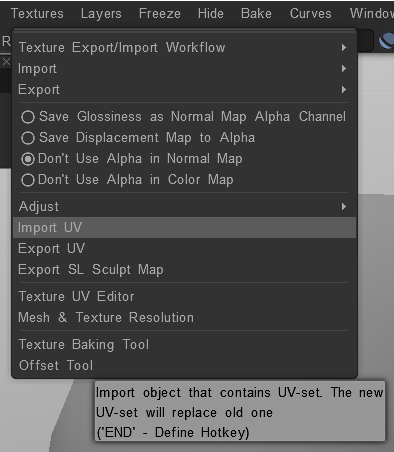

Carlosan Posted February 16, 2025 Share Posted February 16, 2025 Hi Hope this help (warning: try on a new copy of the project to avoid problems. Its a trial and error) 1 Quote Link to comment https://3dcoat.com/forum/index.php?/topic/31253-how-can-i-reimport-a-mesh-with-fixed-uvs-and-save-some-of-my-texturing-solved/#findComment-198215 Share on other sites More sharing options...

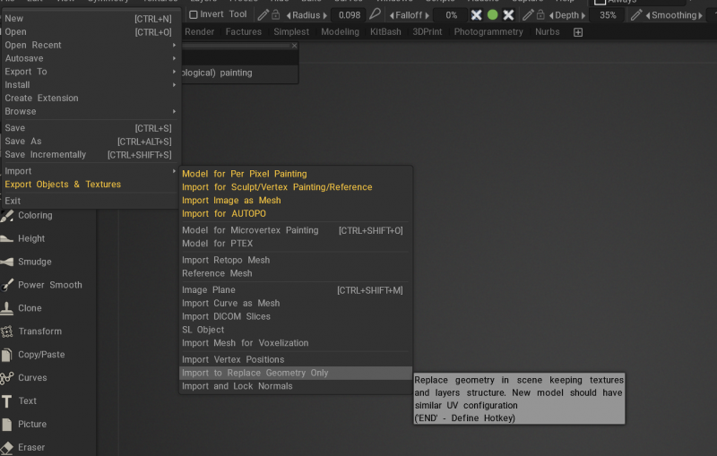

Advanced Member Solution yoohasz Posted February 16, 2025 Author Advanced Member Solution Share Posted February 16, 2025 Hey @Carlosan thanks for the tip, in my case unfortunately import UV didn't work because I had to slightly modify the geo in blender, and the vertex count, and vertex IDs became different than what I already had in 3DCoat, BUT! This did work, and I could keep my painting and layer structure thank God! 1 Quote Link to comment https://3dcoat.com/forum/index.php?/topic/31253-how-can-i-reimport-a-mesh-with-fixed-uvs-and-save-some-of-my-texturing-solved/#findComment-198217 Share on other sites More sharing options...
