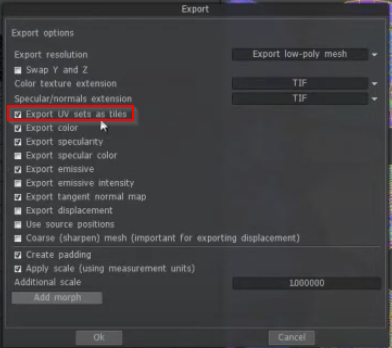

Carlosan Posted February 27, 2025 Author Share Posted February 27, 2025 This is the way 3DCoat supports udims, in other software may be different Quote Link to comment https://3dcoat.com/forum/index.php?/topic/31289-udim-uv-mapping/#findComment-198384 Share on other sites More sharing options...

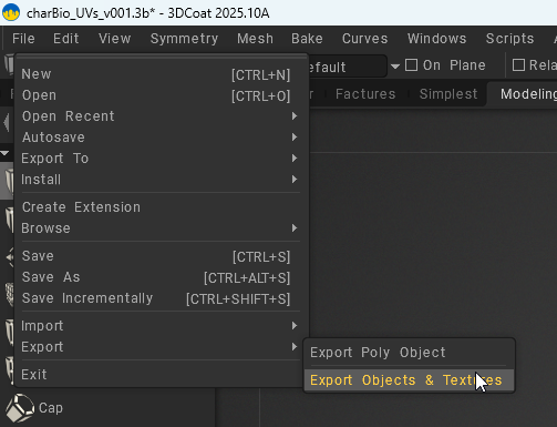

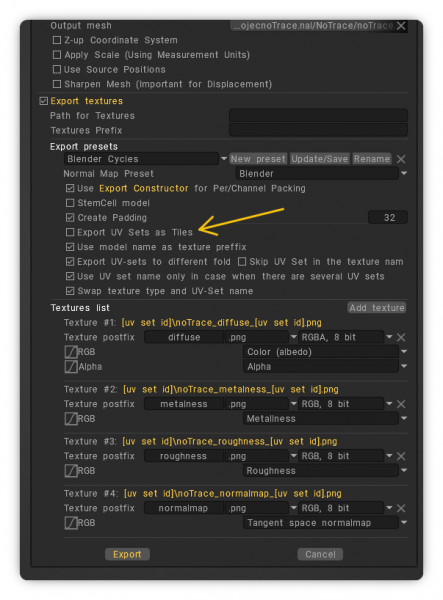

Contributor SreckoM Posted August 1, 2025 Contributor Share Posted August 1, 2025 What version of 3Dcoat are you using? I can see it on my side when I try to export object and textures. Quote Link to comment https://3dcoat.com/forum/index.php?/topic/31289-udim-uv-mapping/#findComment-200328 Share on other sites More sharing options...
Advanced Member MJonathan Posted August 1, 2025 Advanced Member Share Posted August 1, 2025 I'm using 2025.10A, I've created the model and UVsets in Modeling Room. Export Poly Object and Export Objects & Textures: Exports my polygroups but in UVsets instead of UV tiles, there are no a dialog with options. I don't have textures. Quote Link to comment https://3dcoat.com/forum/index.php?/topic/31289-udim-uv-mapping/#findComment-200342 Share on other sites More sharing options...

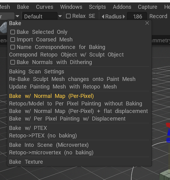

Featured Comment Dmitriy Nos Posted August 2, 2025 Featured Comment Share Posted August 2, 2025 @MJonathan Before exporting, you first need to bake the retopo mesh from the Retopo/Modeling room into a polygonal object. 1 Quote Link to comment https://3dcoat.com/forum/index.php?/topic/31289-udim-uv-mapping/#findComment-200350 Share on other sites More sharing options...
Contributor SreckoM Posted August 2, 2025 Contributor Share Posted August 2, 2025 Yeah move it in the Painting room and than do File -> Export. But I do think that this should be option in Modelling room too. Quote Link to comment https://3dcoat.com/forum/index.php?/topic/31289-udim-uv-mapping/#findComment-200351 Share on other sites More sharing options...
Advanced Member Elemeno Posted August 2, 2025 Advanced Member Share Posted August 2, 2025 3 hours ago, SreckoM said: Yeah move it in the Painting room and than do File -> Export. But I do think that this should be option in Modelling room too. yea a universal menu not specific to rooms would be a lot better , especially if you're looking in one room and the options is in another room , it does get complicated Quote Link to comment https://3dcoat.com/forum/index.php?/topic/31289-udim-uv-mapping/#findComment-200353 Share on other sites More sharing options...
Advanced Member MJonathan Posted August 2, 2025 Advanced Member Share Posted August 2, 2025 Thanks guys!! And I'm agree! this should be working in every room! If that's the uniq way to export my objects with uvtiles(UDIMS) instead of uvSets, modeling room should be capable to export them with those settings. Quote Link to comment https://3dcoat.com/forum/index.php?/topic/31289-udim-uv-mapping/#findComment-200355 Share on other sites More sharing options...
