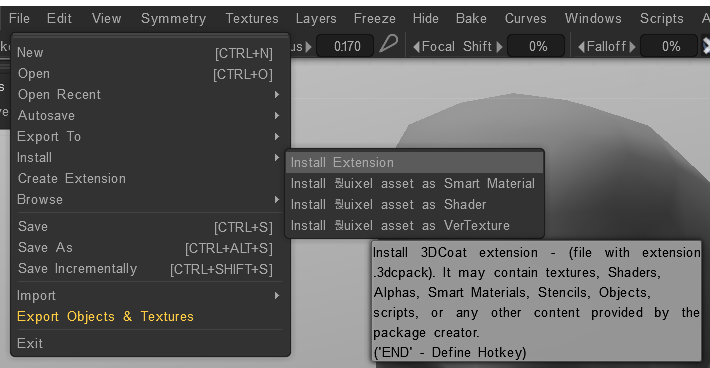

Carlosan Posted March 4 Share Posted March 4 Install this SM and take a look on the SMEditor, hope this help Hope this help MetalLight.3dcpack Quote Link to comment Share on other sites More sharing options...
Member RN3000 Posted March 4 Author Member Share Posted March 4 Thanks for the answers, I've tried it but looks like has no effect Quote Link to comment Share on other sites More sharing options...

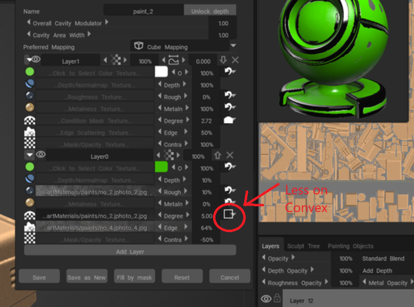

Oleg Shapov Posted March 4 Share Posted March 4 48 minutes ago, RN3000 said: I've tried it but looks like has no effect Try changing this setting. Quote Link to comment Share on other sites More sharing options...
Member Featured Comment RN3000 Posted March 4 Author Member Featured Comment Share Posted March 4 For some reason Ambient Occlusion and Curvature weren't correctly calculated. Deleted them and redone and works now 1 Quote Link to comment Share on other sites More sharing options...
