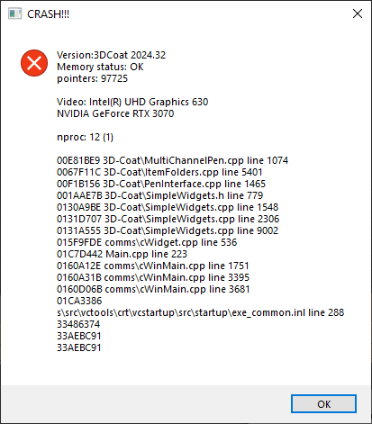

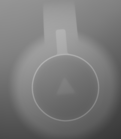

but this time I get an instant crash when loading the psd folder, and even if I leave 1 psd inside the folder it still crashes, attached the psd and the error window

155_Mech_Alphas Set_02_001.PSD

Hello! I have a crash too. Thank you! I will pass it on to the developers.
Crash confirmed and reported.
.psd at 16bit & grey scale cause errors at import.

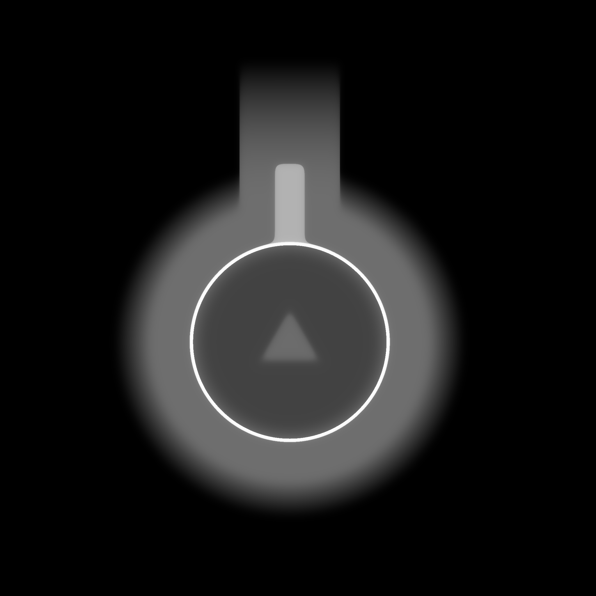

Converting it to png solve the issue (need to batch convert the 150 files)
