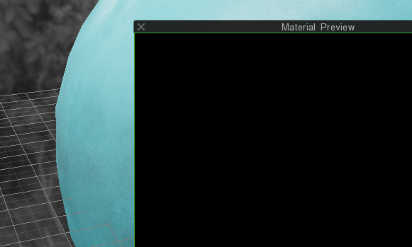

Carlosan Posted March 20 Share Posted March 20 Material preview panel show black image Also Smart Material previews turn black 2 Quote Link to comment Share on other sites More sharing options...
carrots Posted March 20 Share Posted March 20 (edited) On 3/20/2025 at 5:04 PM, Carlosan said: Material preview panel show black image Also Smart Material previews turn black Fixed //edit on next release Edited Saturday at 05:42 PM by Carlosan added information 1 Quote Link to comment Share on other sites More sharing options...

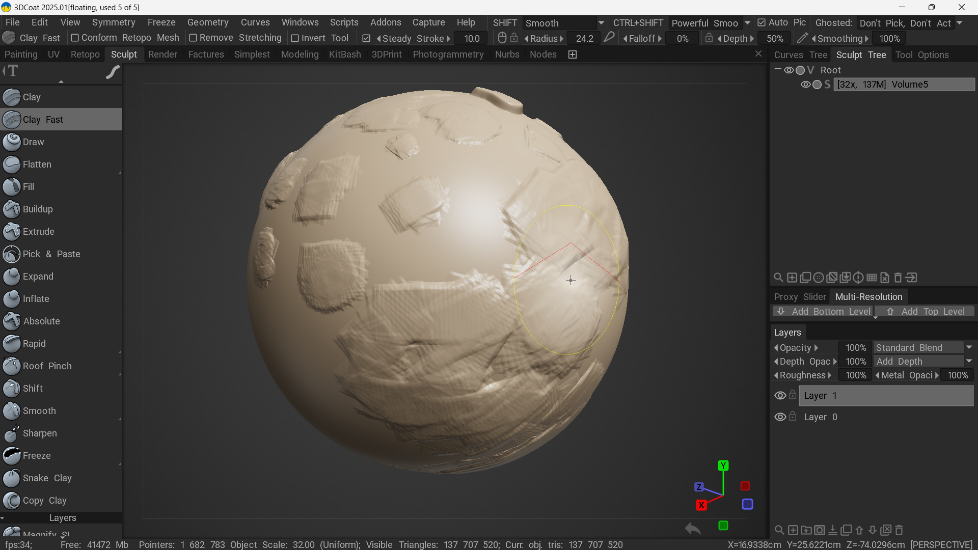

Reputable Contributor AbnRanger Posted March 24 Reputable Contributor Share Posted March 24 This post was recognized by Carlosan! AbnRanger was awarded the badge 'Great Support' and 1 points. 21 hours ago, Elemeno said: Desktop 2025-03-23 19-59-34.mp4 4.96 MB · 0 downloads mesh breaks while high poly sculpting. Can you go to the GEOMETRY menu > Uncheck INCREMENTAL RENDER and test it again? I think it is possible that this is just a display glitch and not necessarily a real mesh breakage. 2 Quote Link to comment Share on other sites More sharing options...
Advanced Member Elemeno Posted March 24 Advanced Member Share Posted March 24 2 hours ago, AbnRanger said: Can you go to the GEOMETRY menu > Uncheck INCREMENTAL RENDER and test it again? I think it is possible that this is just a display glitch and not necessarily a real mesh breakage. that fixed it <3 1 Quote Link to comment Share on other sites More sharing options...

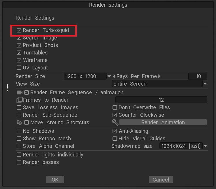

Carlosan Posted March 25 Share Posted March 25 - Will be nice to disable any extra lighting that interacts with the mesh besides the matcap information (mimic zbrush lighting). - [Solved] Render room > Realtime render can't be selected...see below - Paint room > Freeze > Smooth/Sharpen/Expand commands are not working. 2 Quote Link to comment Share on other sites More sharing options...
Oleg Shapov Posted March 25 Share Posted March 25 1 hour ago, Carlosan said: - Render room > Realtime render can't be selected This is because of the new StemCell Certification feature. It needs to be disabled in the Render settings. 1 Quote Link to comment Share on other sites More sharing options...

Advanced Member Mihu83 Posted Saturday at 12:48 PM Advanced Member Share Posted Saturday at 12:48 PM On 3/20/2025 at 11:14 PM, carrots said: Fixed I'm on 2025.01 and preview still doesn't work. Quote Link to comment Share on other sites More sharing options...
carrots Posted Sunday at 05:38 AM Share Posted Sunday at 05:38 AM 16 hours ago, Mihu83 said: I'm on 2025.01 and preview still doesn't work. We haven't uploaded a version with these fixes yet. Here is today's build, if you're interested, you can try it, but it could potentially have a lot of bugs since the interface has been completely rewritten in pythonhttps://drive.google.com/file/d/1GyKa_GNaeN97igoWnI03ue8-MwRIPnhc/view?usp=sharing 2 2 Quote Link to comment Share on other sites More sharing options...
