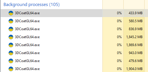

3dcoatGL64.exe remains open in the background even when the application is closed
//edit
fixed on 2029.03
It is back again... after closing 3DC...

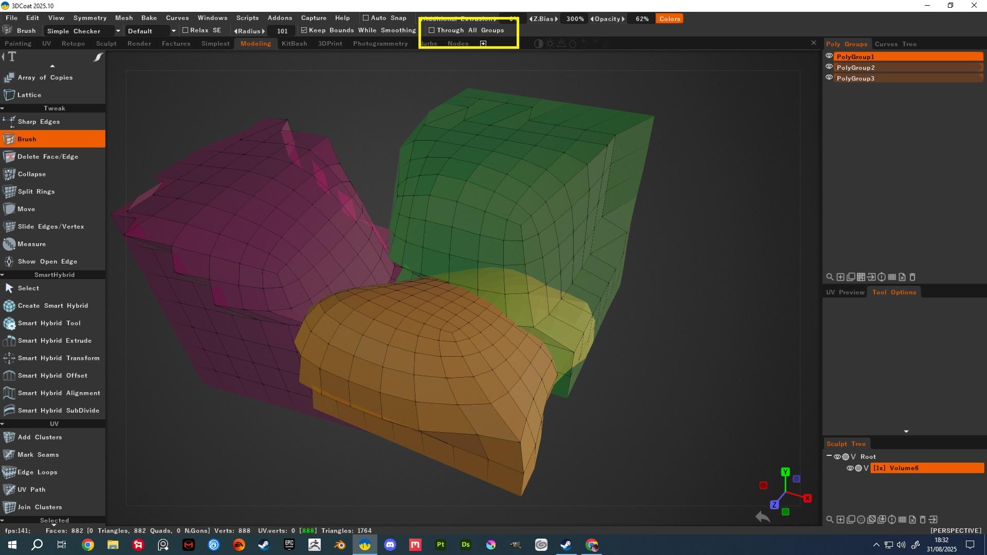

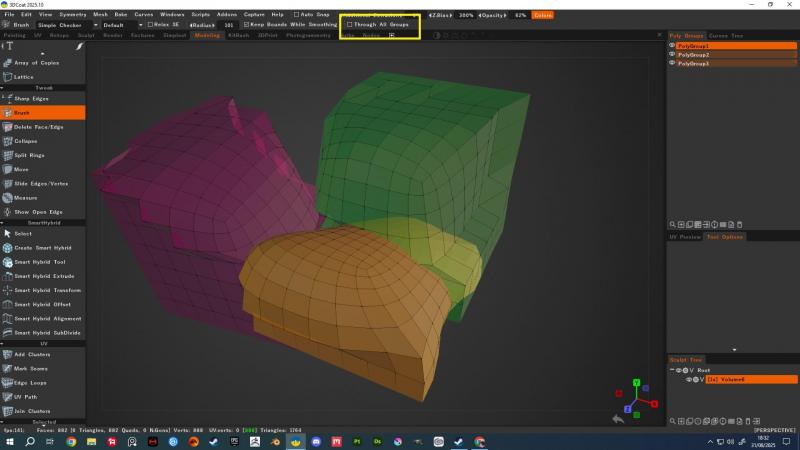

a. Brush tool - prevent it from picking every visible polygroup. Pretty annoying when you try to adjust one polygroup and it's picking every visible group.
b. Relax tool - same as brush tool. Subdividing mesh works as expected, affecting only current polygroup, but when you hit Relax, it's affecting all visible polygroups.
    I need to check if it also influence hidden polygroups.
  • Thanks 2
the brush tool , make sure this box is unchecked and it wont interact with other polygroups ...
Posted (edited)
this also applies to most of the tools too, as for layers and sculpting , they are separate and can even be moved or removed ...
Edited by Elemeno
Oh, yeah, I've missed that setting...
Separate, as separate panels - now it's pretty easy to mess painting and sculpting.

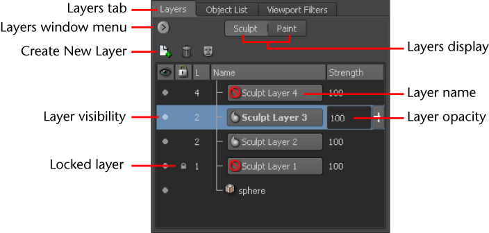

You have one panel called Layers, which combines both sculpt layers and paint layers, so when you have complexe models with tons of parts, it's very easy to make a mess. Yes, you can group, make folders, etc., but that still isn't very convinient.
+1
Work as similar as Mudbox layers will be a great addition
42 minutes ago, Carlosan said:
+1
this would also be nice for sculpting objects and polygroup
1 hour ago, Carlosan said:
+1
Yep, that would be nice.
  • Reputable Contributor
You already have that in the LAYERS panel. It contains DEPTH, COLOR, GLOSSINESS, and METALNESS information, so it is both for SCULPT and PAINT information...and even better than that Mudbox example above, it keeps that information on the same layer, so you can simultaneously sculpt AND paint. In Mudbox, you could not. It was one or the other...not both. And you don't have to click the SCULPT/PAINT buttons above the layers, like you see in that example.
Personally, I would not want to see a hierarchy/outliner mixed in with the Layers panel. They are entirely separate functions and should be kept neatly in their own category (OBJECTS and PAINT/SCULPT LAYERS). This is how ZBrush and all other sculpting apps (besides Mudbox) handles them, also. What we need, IMO, is 1 single OBJECTS panel, with the different mesh types separated in their own section of the panel...just like the Tool Panel is made up of tool sections, that you can expand or collapse to conserve UI space.
So polygroup,voxel etc all one list , if so yes i would also prefer this.
I was focusing only on "Layers display" section(Sculpt/Paint), though I'm not a Mudbox user and it seems like it works in a different way than I was expecting, so... I still think, Paint Room should have separate panel/tab for Sculpt and Paint layers to avoid one big mess.
Don't know if I understand your idea of combining Objects into one panel, because it sounds to me like even bigger mess, especially with projects that contains over hundred of objects, but then again, as I have said, I might not see it clearly.

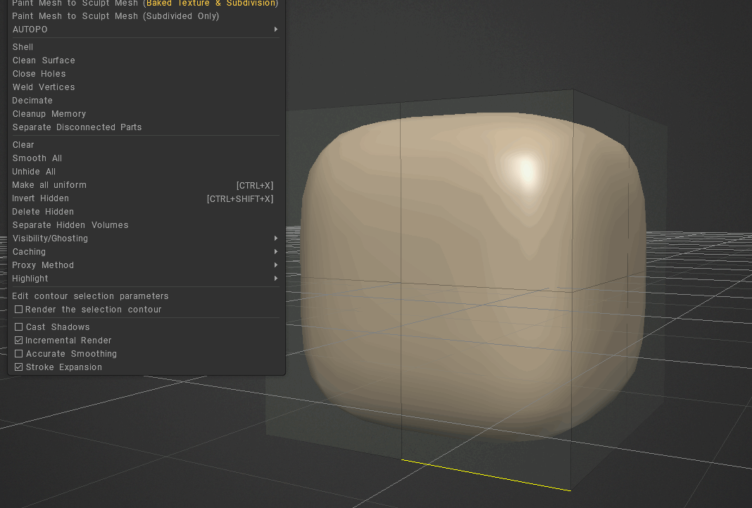

Question to 3DC users - anyone noticed issues with symmetry and primitives/objects placement?
Whenever I add an object/primitive to the scene it seems ok, but when you choose transform tool or try to make symmetrical changes, it's never in the center, it's always off (more or less)...
i thought i was doing something wrong yesterday lol , yea specifically for me it was radial symmetry was off ...
Yep, I was thinking the same, but nah, there is something messed up and it's there for quite some time. I've had a project, quite complicated one and I've noticed this on a very advanced stage... long story short, almost everything was off-center.
you can choose " pick from bounding box" inside the symmetry options and that should fix the issue , its not my meshes origin though or anything like that ... its a strange onne
Yep, I know about that, but no, that doesn't fix the issue. I'll put some video a bit later - with simple primitive off-center isn't big, but further into project it will pile up and constantly fixing that sh*** during sculpt process isn't nice( to put it mildly).
