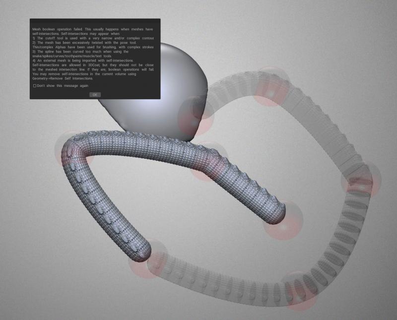

Is there a way to disable boolean when using tools that append new meshes like spline / import? Fairly simple test cases fail to boolean when using repeated shapes
  • Reputable Contributor
Surface (mode) Booleans are less reliable than Voxel mode Booleans because of self-intersection issues and such. Try to switch your Sculpt Tree layer to Voxel Mode first. If you need to switch it Surface mode thereafter, you can.
Hey there! The reason I'd want to keep it in surface mode is to preserve the topology: As soon as something becomes voxels I have to retopo it before it can be used. As such I try to keep things surface mode as much as possible unless I'm sculpting details or already have a retopo ready. If there was a way to expose whether or not the new meshes get booleaned when applying it would allow me to preserve the mesh topo in the sculpt
It doesn't matter if you keep it in Surface mode or Voxel mode, it is still gonna be a triangulated mesh and you will need to do retopo, or bring it into Zbrush, duplicate the subtool, Zremesh it and Project details or something similar.

If you can preserve the original topo, even if it's triangulated, it's much easier to make the gamerez than if you are just using voxelized mesh, because sharp corners are preserved.  I could take my mesh into zbrush to polygroup -> zremesh -> quadmesh for my sub-d high / lowpoly foundation, but at that rate you may as well just do all your detailing in ZB. Small edits to 3dc sculpt tools like this are probably pretty easily doable but would save a lot of time getting the final mesh out, because you have a foundation instead of starting from scratch with your retopo.

Unfortunately for me im not a concept artist, and it comes down to time. Working in voxels require 100% manual retopo, especially for hard surface. The more sculpt mode surface based features, the easier it is to use 3dc for final work. I def think 3dc supporting subdivision level sculpting is a massive step in the right direction, but all the different "rooms" and data types that are 100% separated from one another are holding back a lot of advantages you get out of zb, like the typical workflow where you dynamesh sculpt a hardsurface thing and then polygroup -> cusp smooth -> zremesh, then detail with dynamic sub-d + zmodeler to make your production asset all in the same app you started. 3dcoat has a lot of these features already, they are just boxed off in their own rooms so you can't use them together seamlessly. Imagine if you could use retopo tools in sculpt mode, then add subdivision levels to it, or use 3DC's quad remesher in sculpt mode directly without having to leave to another room and pull it back? Imagine if 3dc had the equivalent of polygroups or face sets you could use to hide or show parts of your sculpt without having to separate them into other voxlayers? (I think this is also possible to be transferred back and forth to voxel space just like the colors are!) Anyway, that's a ramble. I just see a lot of potential, and I'm just suggesting some baby steps which would make it easier for me personally to stay in 3dc instead of bouncing between apps. For me that's "better surface mode stuff" and "better booleans in surface mode" or, alternatively "avoid booleans in surface mode"
