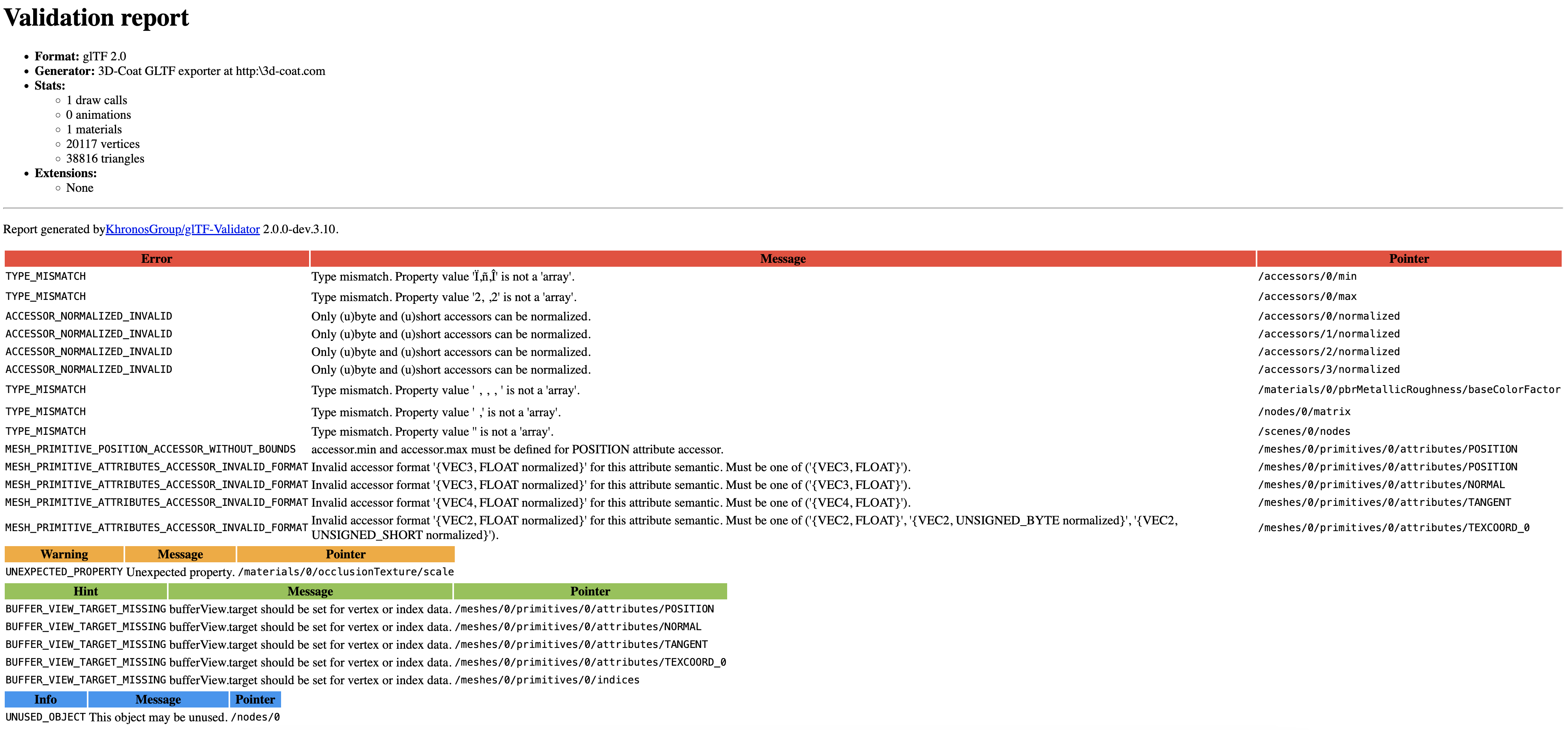

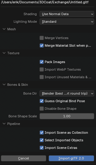

2025.17, apple silicon, Sculpt Mode, File -> Export -> Export to gltf -> Gltf embedded. Does not open in Blender 5, "Could not parse the file, check that it is valid."
I have the same problem on Mac Intel with Blender 4.5 LTS
But I also checked the GLTF produced by 3D Coat 2026.01 with the KRONOS GLTF checker.
Seems that the GLTF itself is the problem and not useable.
So maybe it's a bug in the GLTF export of 3D Coat?
