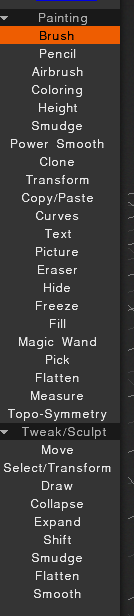

Contributor Rygaard Posted June 10, 2025 Contributor Share Posted June 10, 2025 Hi, in 3DCoat-2024, (surface mode) in the left panel of tools, brushes and commands there is a section called "Custom", and within that section is the "base brush". As you can see in the image below: That said, now in the latest build of 3DCoat-2025 I can't find the Custom section and the base brush within it. What happened to the section and the base brush? Was this section with the base brush builder accidentally removed? Please, could someone check this in the latest build of 3DCoat-2025? Thank you very much. 1 Quote Link to comment https://3dcoat.com/forum/index.php?/topic/31353-3dcoat-2025-development/page/9/#findComment-199641 Share on other sites More sharing options...
Carlosan Posted June 10, 2025 Share Posted June 10, 2025 you are right, base brush is gone :( 1 Quote Link to comment https://3dcoat.com/forum/index.php?/topic/31353-3dcoat-2025-development/page/9/#findComment-199644 Share on other sites More sharing options...
carrots Posted June 10, 2025 Share Posted June 10, 2025 2 hours ago, Rygaard said: Hi, in 3DCoat-2024, (surface mode) in the left panel of tools, brushes and commands there is a section called "Custom", and within that section is the "base brush". As you can see in the image below: That said, now in the latest build of 3DCoat-2025 I can't find the Custom section and the base brush within it. What happened to the section and the base brush? Was this section with the base brush builder accidentally removed? Please, could someone check this in the latest build of 3DCoat-2025? Thank you very much. Maybe it's because of the switch to python. I'll check today. 1 Quote Link to comment https://3dcoat.com/forum/index.php?/topic/31353-3dcoat-2025-development/page/9/#findComment-199648 Share on other sites More sharing options...
Contributor Rygaard Posted June 10, 2025 Contributor Share Posted June 10, 2025 29 minutes ago, carrots said: Maybe it's because of the switch to python. I'll check today. You are right! Thank you very much for checking this. 1 Quote Link to comment https://3dcoat.com/forum/index.php?/topic/31353-3dcoat-2025-development/page/9/#findComment-199649 Share on other sites More sharing options...
