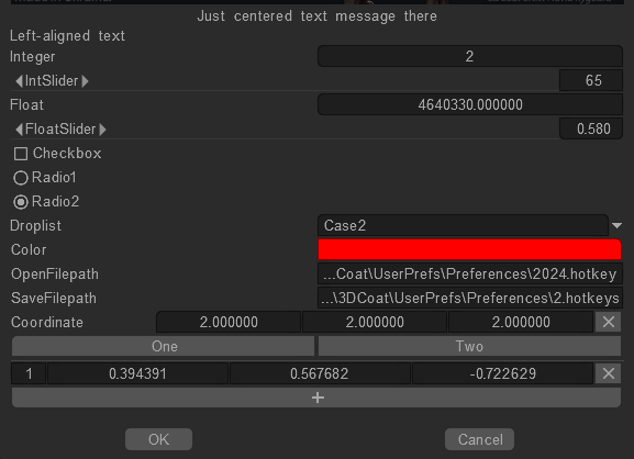

Okay, I found a solution in the documentation. To prevent the pop-up dialog menu and pass the file path, we can use the following method:
coat.ui.setFileForFileDialog(se.exportMesh)

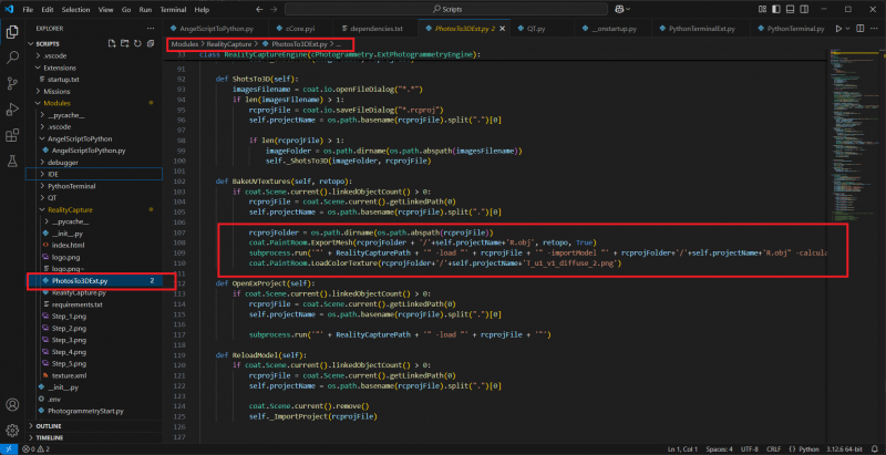

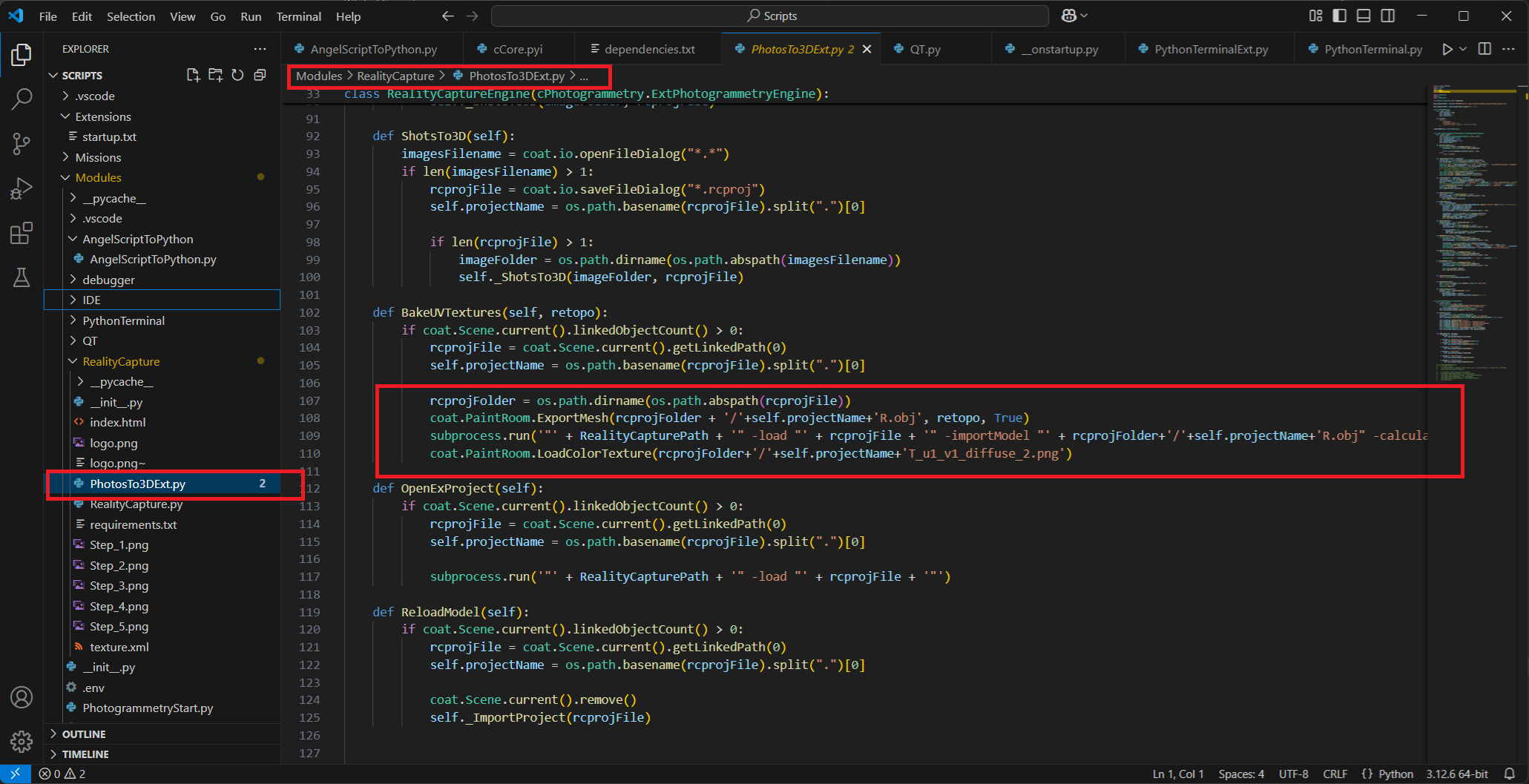

You can use low-level APIs, as it is done in the Reality Capture module.
3DCoat_install_folder\UserPrefs\Scripts\Modules\RealityCapture\PhotosTo3DExt.py
https://pilgway.com/files/3dcoat/PythonAPI/classcoat_1_1_paint_room.html
if you need additional low-level API functionality - let me know

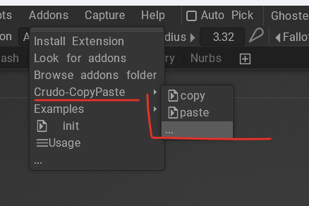

I just found your add-on system quite similar to something I built for Autodesk Maya, which helps manage scripts in a more simplified way. If you're interested, I have an article about it link
Also, I’m wondering if it’s possible to create a custom context menu with submenus, separators, etc.? I saw that it's possible to insert menu items, but I couldn’t find how to manage submenus, separators etc.

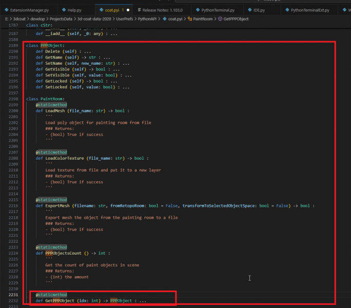

Thanks, Ok, I'll add this to the Python API
  • Thanks 2

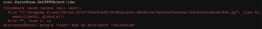

Hi @MJonathan , please try this version https://drive.google.com/file/d/1_wyvaT-A0OGOrcPffSew3vkEJRc7qemu/view?usp=sharing
To access the Paint object model, you can use the coat.Model.fromUv() function
To access the Paint object properties, you can use the coat.PaintRoom.GetPPPObject(idx) function
Also fixed an issue with changing the visibility of retopo groups
