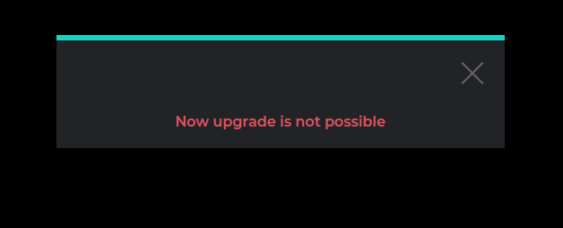

I'm bumping this topic again because even if I use the distrobox workaround to run 3D Coat, it crashes and doesn't work.
the 2025.01 version works -- BUT I CAN"T EVEN UPGRADE MY LICENSE TO USE IT!!
so now I have a nearly finished project that I can open in the 2025.01 version - but can't export - and I can export it in the 2024 version -- but it crashes when it opens due to a bug that was fixed sometime during the 2024 series.
As it stands today, on April 15 2025, 3D Coat is simply not usable on Ubuntu 24.04 LTS.
At this point I would happily pay for the upgrade - I love 3D Coat! But I can't even do that, and it is frustrating.
