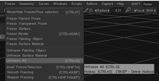

Carlosan Posted April 2 Share Posted April 2 Hi Is Freeze active ? try turning Freeze mask off Quote Link to comment Share on other sites More sharing options...

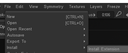

Carlosan Posted April 5 Share Posted April 5 Install the missing smats as extension dirtdust.3dcpack Quote Link to comment Share on other sites More sharing options...

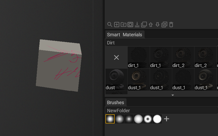

Member sheeplion Posted April 6 Author Member Share Posted April 6 (edited) I tried a quick cube in blender, UV auto wrap, send to 3D coat with 3D coat Applink drawn a few lines onto it, then tried dust particles. it works. Only the smart materials preview globes in the 3D coat the stay black and grey. This preview problem is still not solved. all imported dirt shaders from your file show as checkerboard. cannot preview. what i did: Blender (3.621) use cube, UV auto unwrap, use 3D coat app link to send to 3D coat. Tried above dust particles and other smart materials, they work. Then delete all dust smart materials. close project, save the project because 3D coat asks for it. Reload 3D coat, import your smart meterial dust as an extention. Results: as said, no dust preview , preview is as attached picture "black-grey-checkerboard.png Edited April 6 by sheeplion Quote Link to comment Share on other sites More sharing options...
Carlosan Posted April 6 Share Posted April 6 It is ok, dust/dirt have a mask and must be applied on a new layer on top the previous one. Will be applied over the curvature/cavity of the mesh. The Material preview looks dark until you paint over the mesh (it is a bug and will be solved soon) Quote Link to comment Share on other sites More sharing options...
Member sheeplion Posted April 6 Author Member Share Posted April 6 (edited) Attached problem is recognised by your team? And is on the list of "todo" ? Edited April 6 by sheeplion Quote Link to comment Share on other sites More sharing options...

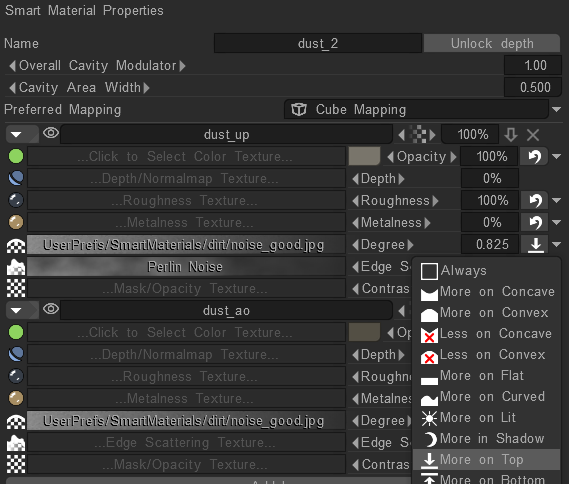

Carlosan Posted April 6 Share Posted April 6 It is not a problem (the black Preview is a bug and is in the todolist to be solved) Edit the Smart Material to understood how it works dust/dirt are SMaterials based on Conditions, dust_2 like example only act on More on Top and More in Shadow The squares means that this SMaterial don't affect the overall shape of the mesh but cavity/curvature. "conditions" refer to paint masking options that allow you to restrict painting to specific areas of a model based on surface curvature, lighting, or other criteria. 1 Quote Link to comment Share on other sites More sharing options...
