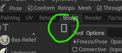

The tool get disselected right after you click "disable or enable "ignore back faces" This is the moment you are not actually changing the pose tool setting for selecting or not selecting the back faces.
Bug does not happen if:
If you have pose tool selected, and you go to menu to change "ignore back faces." and pose does is still selected.
It happens because I click the rectangle. To access the setting "ignore back faces." you must not click this, just mouse over it!

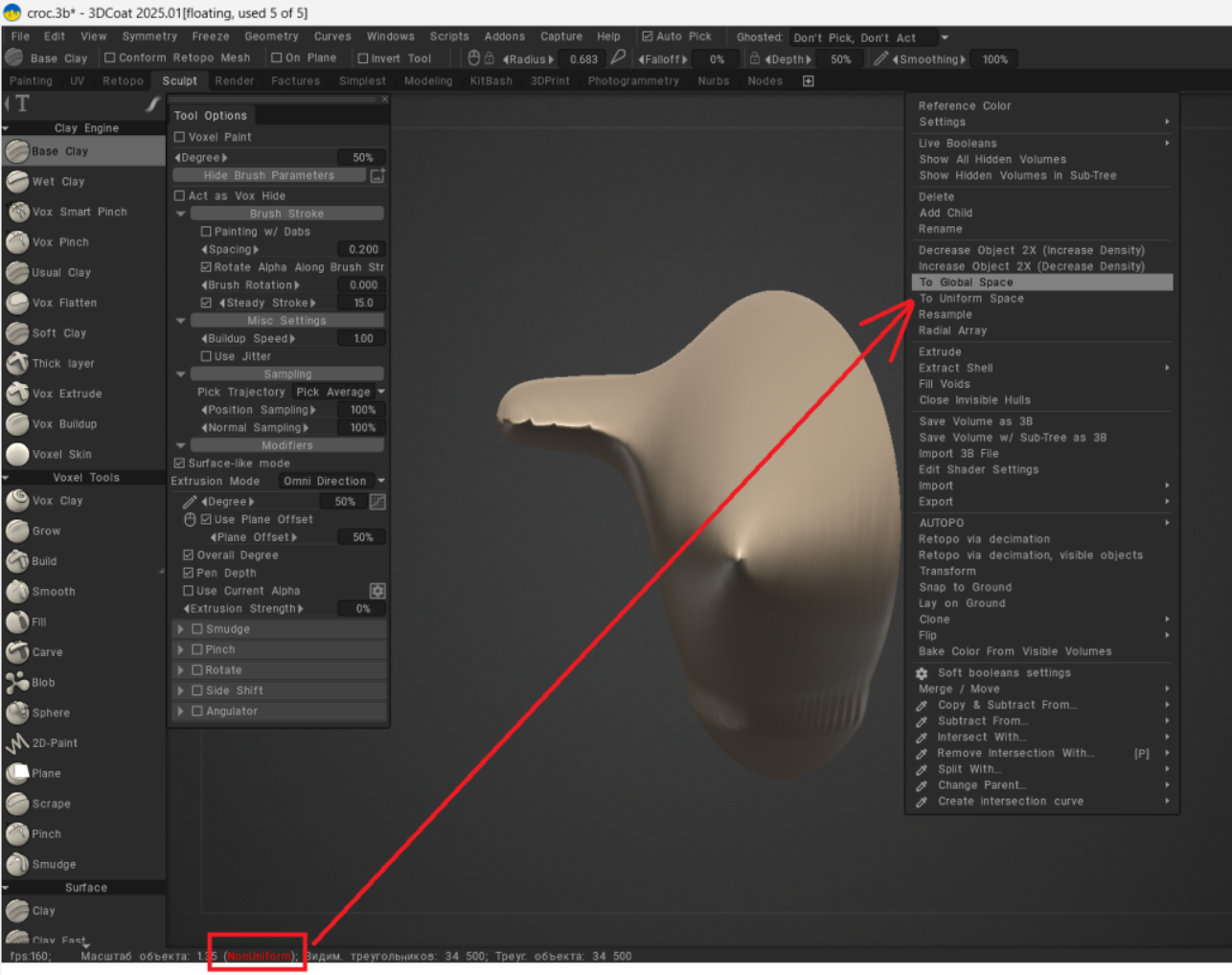

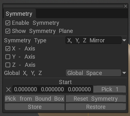

Will give this a try and change to global space.

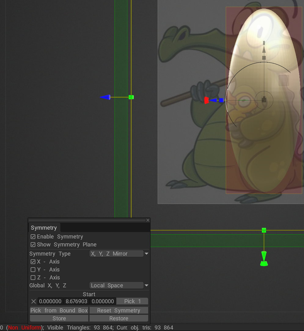

Symmetry enabled, Global space:

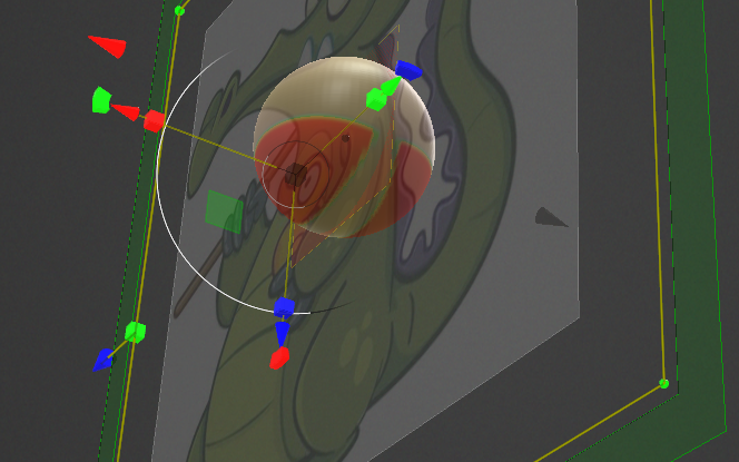

The problem repeat itself again. I tried switching between local and global. But the pose tool cannot choose the whole under side of the ball, as you can see it shooces 2 parts, and the middle is not chosen. I am truly clueless how this program works. With or without symmetry one, both ways pose tool cannot choose everything across.
Use square select tool. Any please? help? project is attached again. What setting in my 3D coat is wrong?

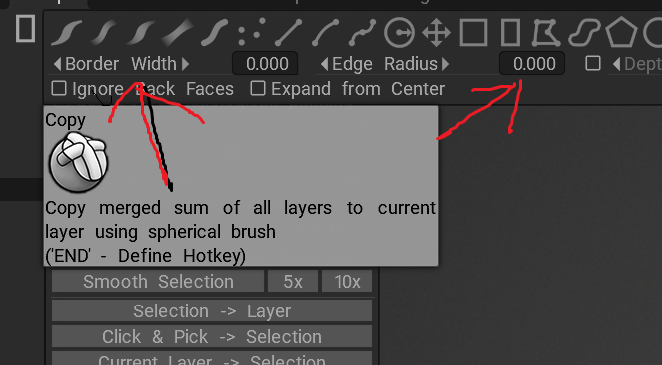

Found solution. I think it is a bug must be.
I changed the selection tool settings as seen in attached picture. increasing them, decreasing them, then set to zero. And voila . I can select everything now. Ignore faces is off, mirror is on. without mirror also can choose everything.
But, I got a new problem: now I can select also the voxels that I cannot see, Even if I enable option "ignore back faces"
Does not matter what setting, now I always select everything around a ball, also voxels I cannot see.
Help please : I found a new bug.
