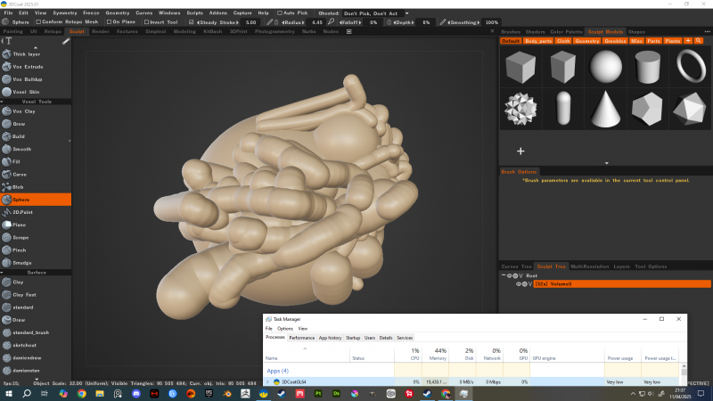

nearly 100m ... 19gb no single mesh should need that much but for curiosity purposes
I noticed in your image that the RAM usage is low, but the viewport is running at only 15 FPS, that’s quite slow.
thats my distance from the mesh , as i say i wouldnt use this dense of a mesh for anything , but i normally go up to 40-50 million , i normally get 10 fps far out and if im close in and small brush doing fine details then i get about 40-50 fps , most of the time its alpha stamping , stitching that sort of thing ..
