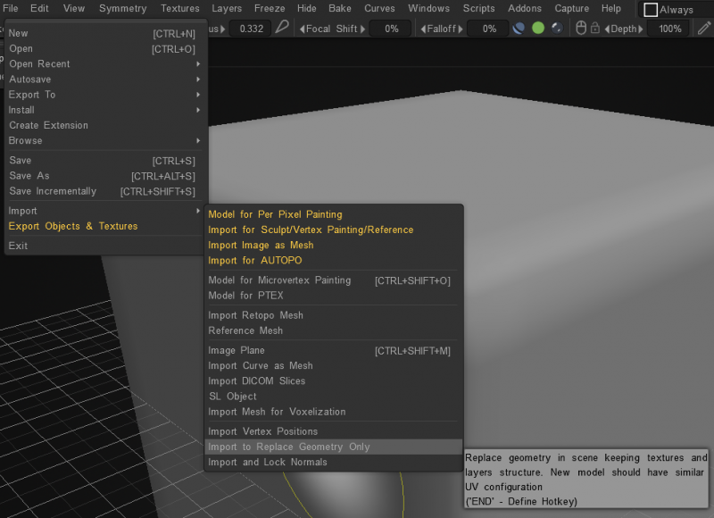

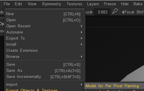

On Paint Room ? use this
  • 0
Thank you so much.  That works just fine.  :good:‍‍

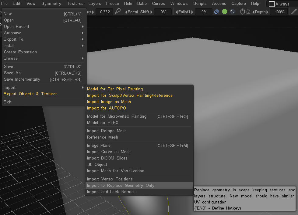

Use this
  • 0
Hmm, that sort of worked.  The head textures with lips and ears came in fine but the rest a no go.  I'll just bring them back in as I already did all fixes for the maps in Photoshop.  Thanks for all your help!

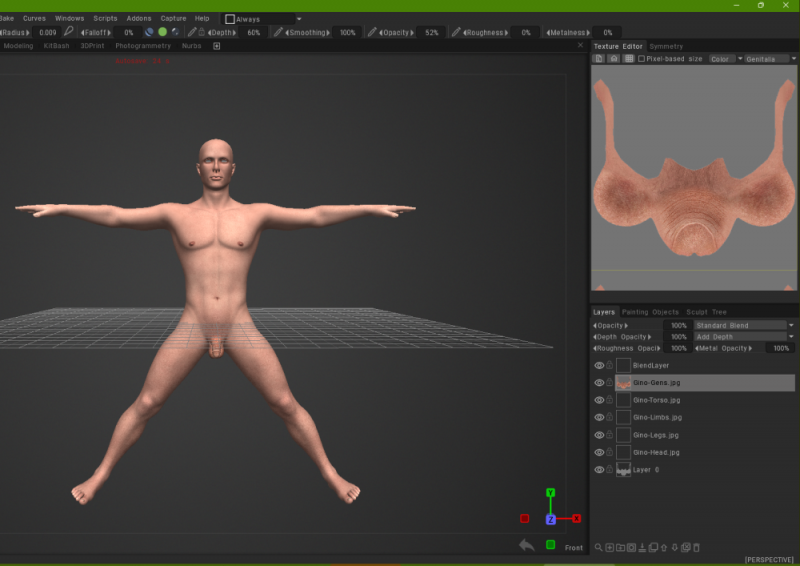

If this isn't acceptable I'll start a new thread but since this is the same ongoing issue for me I'll post here.  My next issue is that in DAZ Studio they have a figure called Genesis 8 Male, his genital conformer, when conformed, HIDES part of the torso and attaches to the surrounding polygons for better blending of the textures.  It's a good idea until you need to actually texture them both (Gens and Torso).  I've really tried my best to understand how to work around this issue but it's a no-go so I'm once again reaching out to the community here, esp if you have worked with the DAZ3D figures and know the tricks on how to work with this.
1 Posed Genesis for painting, I hid parts that didn't need to be exported like inner mouth and eyeballs, set resolution to base and exported.
2 Loaded up the genital figure, moved it as close to the body as I could and set the resolution to base and exported.
3 Brought both in and setup the base textures but not completely feeling safe about this.  I'm on my last tester try before they delete my product page and make me wait to try again for the store and I completely get it.  I thought I had the bits fixed but when I loaded up the figure I found that since I exported Genesis with the genitals conformed they came in as a whole mesh and of course the Torso texture is now missing part of the texture and was just filled in with a skin tone so he's got a triangle of texture missing from the Torso so now I'm trying to figure out how to blend that out properly.
If 3DCoats option to bring in a figure without loosing the textures worked properly I could probably do the blend with the genitals attached using that figure export and then switch out with the figure without the genitals and do some tiny fixes and fill in the center where the triangle with no textures is but the program doesn't do what it says it can do so MOST of the textures are NOT there, they have to all be reloaded and if they are not saved out from the previous session I loose that work.
Help?  Suggestions?  Tips and Tricks?
Thank you
Richard

Hi Oleg, it's OK.  It's all done.  The items, as explained above are brought into DAZ Studio, one is a conformer, the genitals, the issue with this set up is that when non conformed the ends of the polygons from the gens VS the figures body, do not fit snugly to the shape, it only does that when conformed.  So getting a blend between both areas is nearly impossible.  I'm on Discord as well and there is a DAZ Studio creators forum there, NO ONE likes this method and ran into the same issues when trying to blend both.  One person had a workaround but for my old brain it made little sense.
