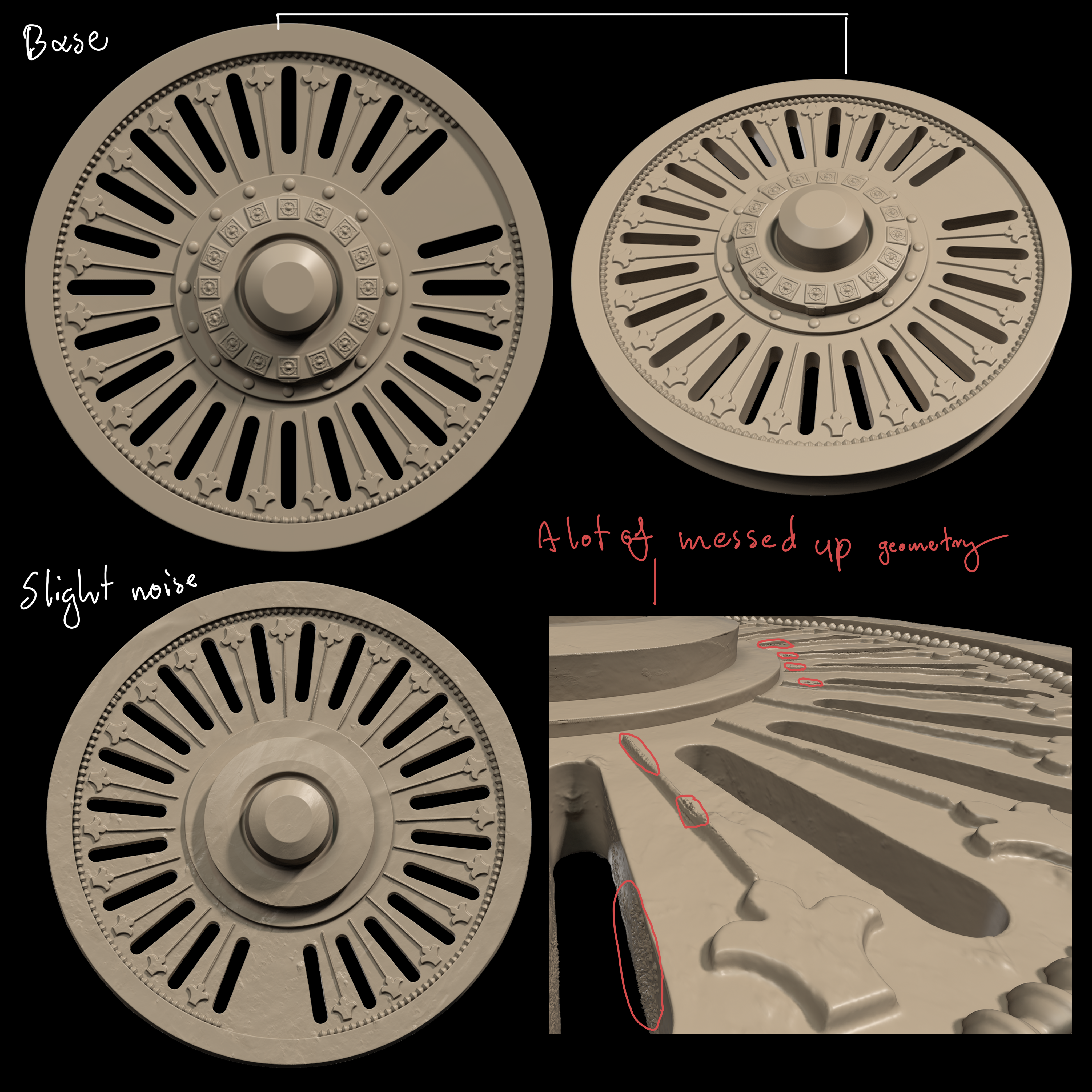

Advanced Member Mihu83 Posted April 25 Author Advanced Member Share Posted April 25 1 hour ago, Carlosan said: Show the base model and any references that you like to achieve. Here is an example - keep in mind that's only one part of the whole model, which is already over 100 million polys... This wheel, especially inner part(with cuts) is around 13 million polys. In this particular part, I wan't some metal surface noise, imperfections, pitting, etc. Now, there are also wood parts in this model and man, I've tried adding some wooden surface with 4096 x 4096 alphas and it's not very pretty. I really think, that I might end up somewhere in 200 million polys if I want to add decent detail to the whole model Quote Link to comment Share on other sites More sharing options...
Carlosan Posted April 25 Share Posted April 25 Are you using voxel mode ? Try switching to surface mode Voxel is for rough sketching, surface is for fine details. And you don't need so high polycount to add fine surface details. Quote Link to comment Share on other sites More sharing options...
Advanced Member Mihu83 Posted April 25 Author Advanced Member Share Posted April 25 (edited) 16 minutes ago, Carlosan said: Are you using voxel mode ? Try switching to surface mode Voxel is for rough sketching, surface is for fine details. And you don't need so high polycount to add fine surface details. That's not a voxel mode... I know the voxel/surface mode workflow, I'm using 3DC for quite some time... Yeah, then tell me how to add fine details, because no matter what, I'm getting this type of s****y result. With lower poly count, triangulation, weird artifacts or holes are even more visible or the details are blury, so... I rarely ask for advice, usually I will figure out things on my own, but in this case, there's something weird going on. Edited April 25 by Mihu83 Quote Link to comment Share on other sites More sharing options...

Carlosan Posted April 26 Share Posted April 26 Elemeno, you are working on Voxel mode... Mihu, try creating the low model on Modeling room, send it to Sculpt surface as multiresolution base mesh, bake and export Or create Voxel mesh using Live Booleans 1 Quote Link to comment Share on other sites More sharing options...
Advanced Member Solution Mihu83 Posted April 27 Author Advanced Member Solution Share Posted April 27 (edited) On 4/26/2025 at 6:09 AM, Carlosan said: Elemeno, you are working on Voxel mode... Mihu, try creating the low model on Modeling room, send it to Sculpt surface as multiresolution base mesh, bake and export Or create Voxel mesh using Live Booleans Gonna try that, but I might have found a bit different way - probably won't work for every piece of sculpt, but I'll be fine with that. So, the way would be - Plain mesh(no details) > Auto retopo > Sloppy UV's> Baking> Painting(Depth Only)> Paint mesh to Sculpt mesh> Reprojection to lower res copy of the object. I might combine this with Zbrush Noise maker, but that won't be needed for most parts, I guess. Edited April 27 by Mihu83 1 Quote Link to comment Share on other sites More sharing options...
