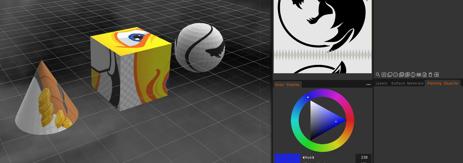

On 5/30/2026 at 10:14 AM, Carlosan said:
Testing version and... Successful ! (thanks !)
Import as OBJ is working fine.
As fbx = no result
Nomenclature must be:
example
Material_Albedo_1001.jpg, 1002, etc
sidenote: No paintintg object was created
* scene used for the test is attached
Thank you carlosan for the test Files. The resolutions of the textures are not recognized. This should be easy its udim 1001 (IMAGE RES)=texture resolution,,and so on.
