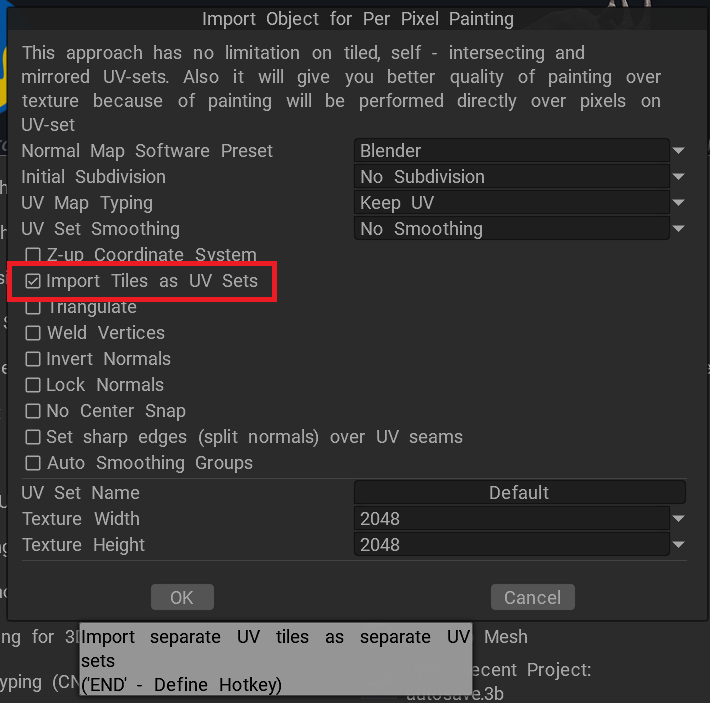

I have a character that uses UDIM and I need a proper way to load up all maps for him (Diffuse, Normal, Bump, Specular and Gloss maps) and for all parts (Head, Arms, Legs and Torso) and then need some advice on how to make sure when I'm trying to heal up noticeable seams I have the correct settings turned on so all the update brush strokes to the maps are applied correctly.  Thanks so much

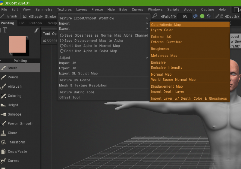

I think it may be helpful but right now I'm just adding things by hand which once saved I won't have to worry about that.  Right now I need a little more advice at understanding things in the import options.  I use the following maps
Diffuse
Normal
Bump
Specular
Gloss.
I see some of the options like Diffuse - Albedo and Normal but not sure what importer I would use to bring in the other three maps.  I have a screen shot attached so hopefully someone can steer me correctly in assigning these properly.  I'll just go in by hand and edit each layer as it comes in and is placed.  Like when I imported in the Head Normal it came in very generic, so I renamed that so I don't get mixed up (which isn't hard for me to do LOL )
Thanks so much
Richard
