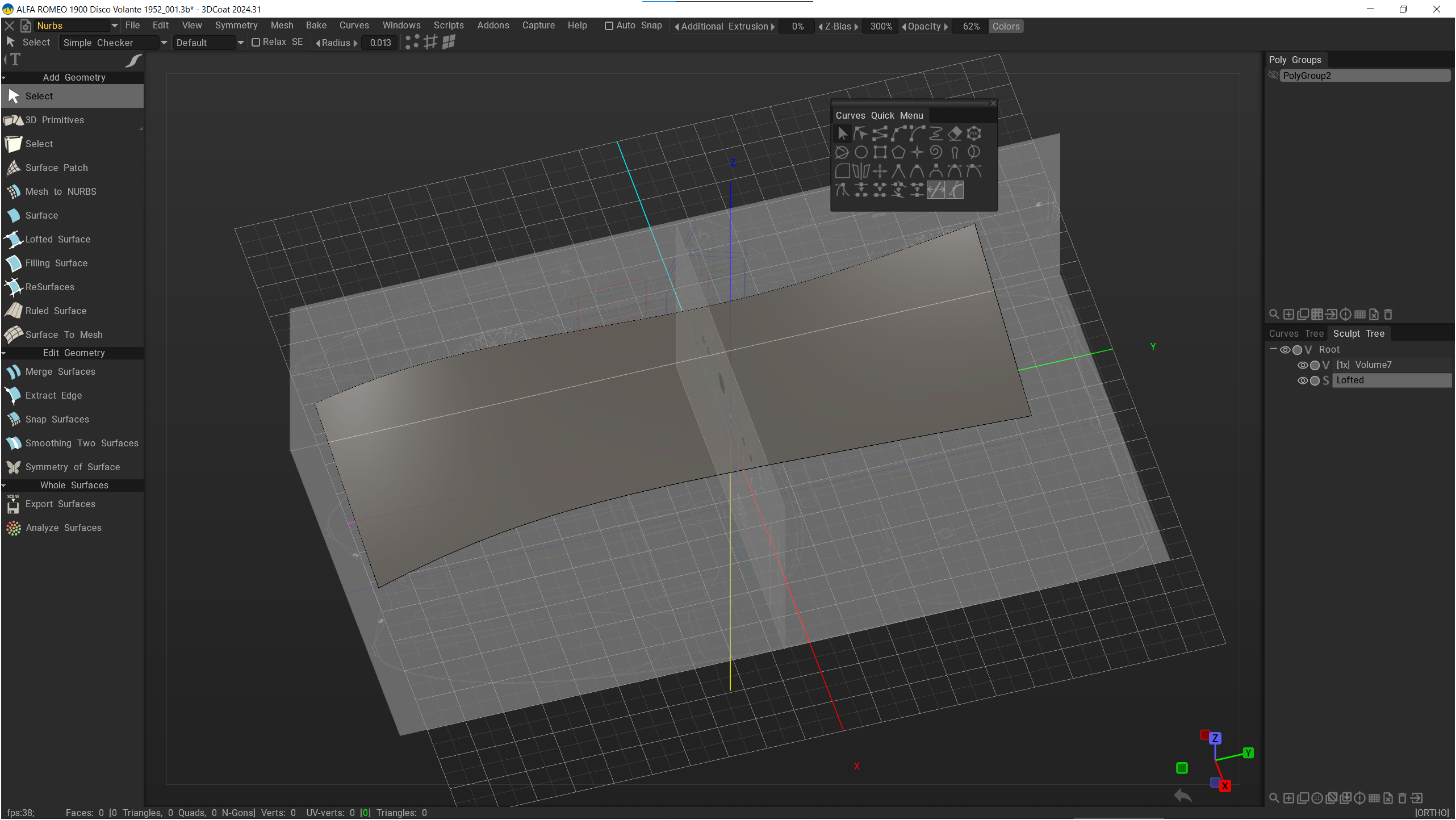

Reputable Contributor AbnRanger Posted June 5, 2025 Reputable Contributor Share Posted June 5, 2025 21 hours ago, pieralessi said: I tried doing it with a plane divided into four, but when I clicked on the circular area, nothing happened. The video omits an important part: if I'm using the curve tools, I must first go to... and then... to be able to select the faces without complications. See the video above about a non-intuitive step before selecting when using curves. You have to understand that when you are creating or editing CURVES, you are in an entirely different mode or stage of creating/editing a model. When you are done creating or editing Curves, you need to step out of that draw mode (hit the E-key to bring up the E-Panel and choose the mode you want to work with next), and into a Brush drawing mode or Shape SELECTION mode. I have to choose different selection modes in 3ds Max or Blender. Why does 3DCoat lose points for doing the same? When I am painting or working in the UV workspace, I know I may need to switch my drawing mode to something more appropriate for the specific tool or task. When you are creating & editing curves, you are in a CURVE draw mode. If you suddenly decided you want to select some polygons, edges or verts, you simply switch to the appropriate draw mode for that task. Again, please watch the Ian's series on "Low Poly modeling in 3DCoat." He covers a lot of ground and explains things in great detail, at a pace anyone can follow. If you really want to speed up the process of changing draw modes, you can assign hotkeys to them (some of the F keys might be suitable for that) by hovering your cursor over the desired draw mode (in the E-Panel) and hitting the END key. That will allow you to make the keyboard assignment. Another option to quickly switch and you don't even have to look down at your keyboard, is to use the HMC Voice Command software. You don't even have to fool with making custom hotkey assignments. Just say the name of the tool, menu item, draw mode, etc. and it selects it for you, while you continue to focus on the model. It's a 3rd party plugin that is worth exploring. Quote Link to comment https://3dcoat.com/forum/index.php?/topic/31490-this-is-by-far-the-hardest-software-to-get-to-grips-with/page/3/#findComment-199532 Share on other sites More sharing options...

Advanced Member pieralessi Posted June 5, 2025 Advanced Member Share Posted June 5, 2025 1 hour ago, AbnRanger said: You have to understand that when you are creating or editing CURVES, you are in an entirely different mode or stage of creating/editing a model. When you are done creating or editing Curves, you need to step out of that draw mode (hit the E-key to bring up the E-Panel and choose the mode you want to work with next), and into a Brush drawing mode or Shape SELECTION mode. I have to choose different selection modes in 3ds Max or Blender. Why does 3DCoat lose points for doing the same? When I am painting or working in the UV workspace, I know I may need to switch my drawing mode to something more appropriate for the specific tool or task. When you are creating & editing curves, you are in a CURVE draw mode. If you suddenly decided you want to select some polygons, edges or verts, you simply switch to the appropriate draw mode for that task. Again, please watch the Ian's series on "Low Poly modeling in 3DCoat." He covers a lot of ground and explains things in great detail, at a pace anyone can follow. If you really want to speed up the process of changing draw modes, you can assign hotkeys to them (some of the F keys might be suitable for that) by hovering your cursor over the desired draw mode (in the E-Panel) and hitting the END key. That will allow you to make the keyboard assignment. Another option to quickly switch and you don't even have to look down at your keyboard, is to use the HMC Voice Command software. You don't even have to fool with making custom hotkey assignments. Just say the name of the tool, menu item, draw mode, etc. and it selects it for you, while you continue to focus on the model. It's a 3rd party plugin that is worth exploring. My friend, if it's that obvious and simple, why isn't the start and end of a drawing session determined by a separate room or a good contextual palette, like polygonal modeling tools? I've been using programs for 30 years, and there's something called "UX Design" that determines "UI Design." You can research the acronyms on the web. I'm a user, and I've realized that I have to adapt to the thinking of a certain number of "collaborators" who should all follow the same work philosophy; otherwise, the software would remain a mess of hidden options, as if it were a video game. 3D Coat must adapt to the needs of users and improve the product. Not keep releasing dated versions with seemingly new features that are always in development. Fixing a bug isn't exactly a tool's advancement; modifying it and giving it more functionality is quite another matter. Do you know how much time I've wasted demonstrating things that are too complicated to understand, testing tools numerous times to figure out where the strange results come from, and researching first to test and then complain? I've made many complaints about tools on this forum, but they only respond to a few or ask for the original file because it's impossible to send them a video here. Do you think I'm having fun playing the hater when after three years I should be able to just use my program? If you sell me a car and tell me the wheels are being manufactured or I had to connect the battery from the hood, you know what to do. 1 Quote Link to comment https://3dcoat.com/forum/index.php?/topic/31490-this-is-by-far-the-hardest-software-to-get-to-grips-with/page/3/#findComment-199535 Share on other sites More sharing options...
