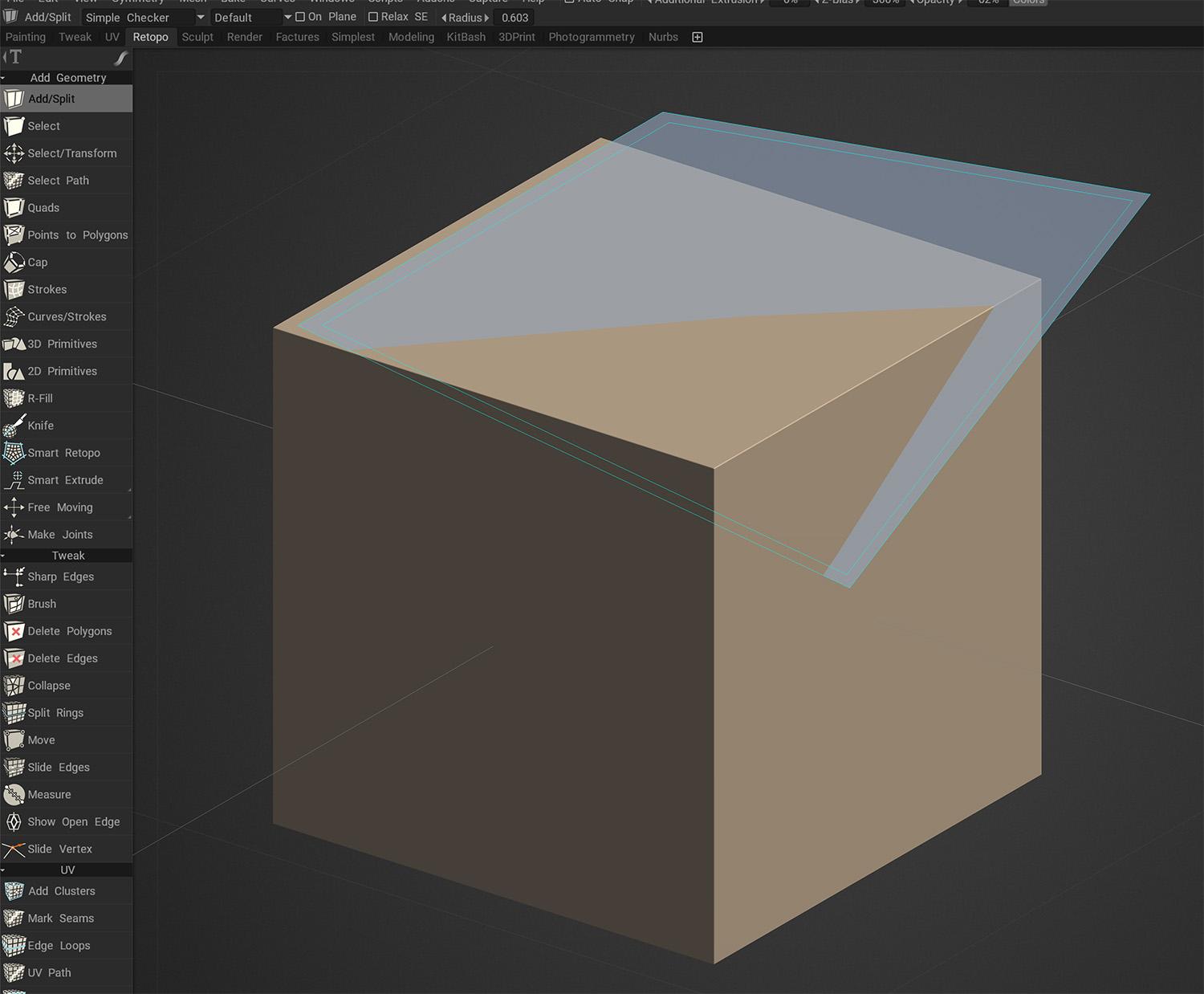

I am trying to retopologize a cube. I have a fair amount of experience retopologizing forms in an old version of 3DCoat, but things seem to have changed. The problem is that when I use the Add/Split tool to draw polygons on the cube, they don't conform to the cube's surface...if I draw outside the borders of the surface, the point gets drawn out in space.  Is there any way to make sure that any points I draw *stay* on the surface I'm trying to retopologize?

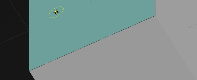

3. Very carefully, use the Add/Split, Quads, Move, and Slide Vertices tools to draw quad polys that match the edges of the cube. This is *extremely* difficult, because unless I work only in orthographic views, the vertices tend to slide off the model and out into empty space.

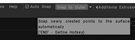

For organic and hard surface models, use Auto Snap option on middle of top panel

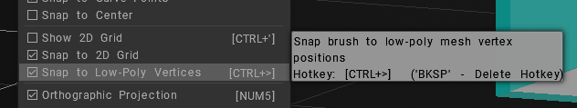

For precise snap as you mention, also activate on View Menu > Snap to Low Poly Vertices
To avoid any slide off
Hope this help
