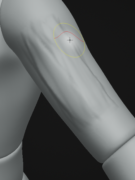

Member EvilMP Posted May 17 Member Share Posted May 17 Hi, I am having an issue with 3D coat Pro version 2025.1. I thought the install was corrupted so I did a fresh install and observed the same behavior. All the previous versions of the program ran on my 49 inch curved monitor. So I am not sure if that is even the issue because it only happens in sculpting and surface modes. It does a slight flicker in the paint room. I have a video of it below so you can see it first hand. I am at my wits end. Quote Link to comment Share on other sites More sharing options...

Member EvilMP Posted May 18 Author Member Share Posted May 18 Turned off Highlight and the same behavior. I even updated my video card drivers. Quote Link to comment Share on other sites More sharing options...

Member EvilMP Posted May 20 Author Member Share Posted May 20 Tried that I am still getting that bleed effect on both sides like the video I attached in the initial post. The autopick is also off. Quote Link to comment Share on other sites More sharing options...

Member Solution EvilMP Posted May 20 Author Member Solution Share Posted May 20 I found the problem this is so badword, and Nvidia needs to fix this ****** which has been a known issue for years. So when you install any new Nvidia driver you have to do the "Custom Installation" and clean out the previous settings,(fresh install). It hit me when I remember an IT client had a similar issue with accounting software. So when I updated the driver I did that and the 3D Coat issue is gone. Carlosan not sure if you want to put this into a Knowledge base or not, just in case someone else runs into this issue. 1 Quote Link to comment Share on other sites More sharing options...
