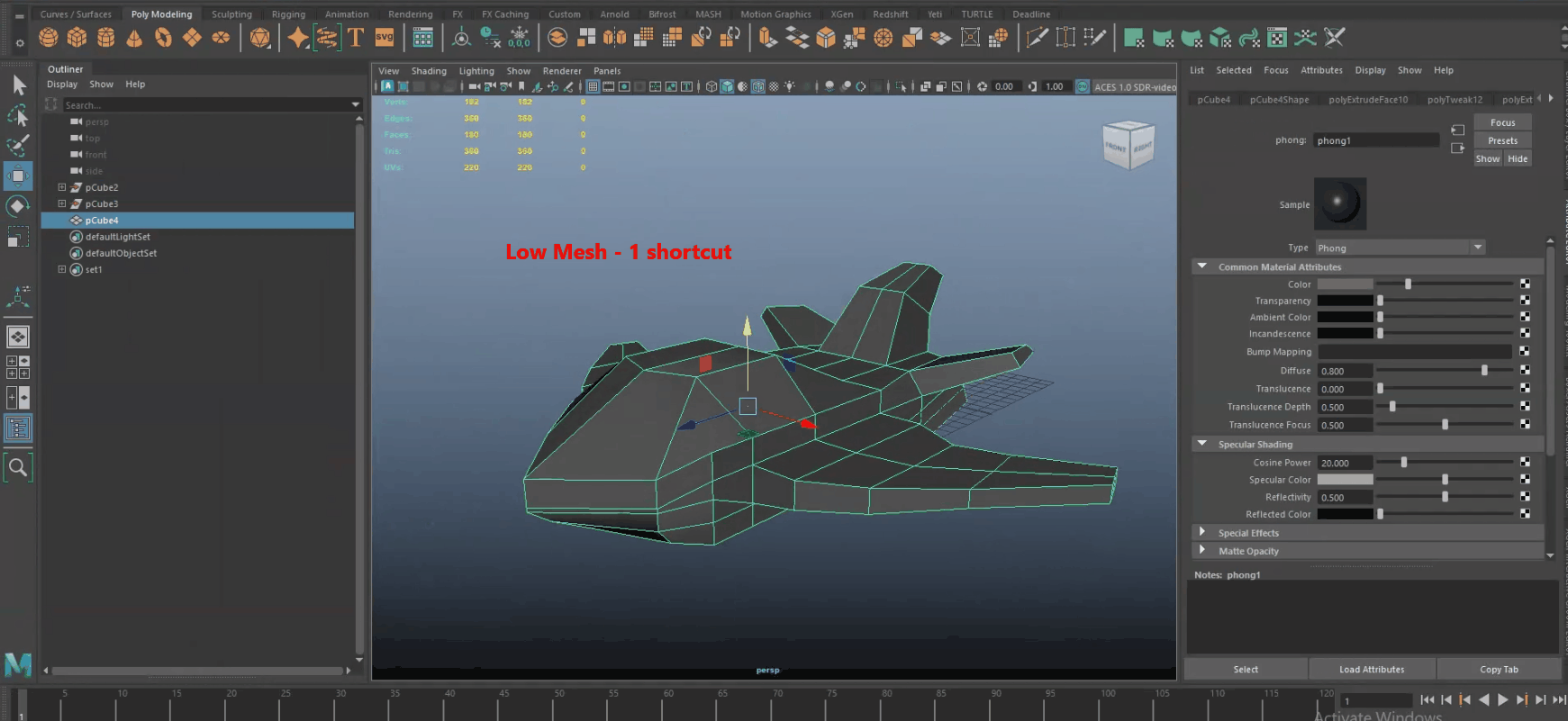

Advanced Member MJonathan Posted June 9, 2025 Advanced Member Share Posted June 9, 2025 (edited) In this other video one modeler in Pixar explain why use subdivision Surfaces AND he shows an example with toy story environment. SubD Surfaces is other type of entity used for preview, the subdivisions are not destructive. If Pilway want to have new users using modeling room, developers need to provide this workflow because It is used in most of the industries in real production. Live smooth is not the answer, because It creates an sculpt object instead of work with the same object, it's slow and the feedback is not in realtime, you can't choose the subdivision algorithm. For standard workflows developers should provide the necessary tools to the artist. This is one of them that is missing in the modeling room. Please don't reinvent the wheel for this standard workflows. You can find the same workflows in other 3d modeling softwares. Here are more documentación about subdivision Surfaces workflow. http://wiki.polycount.com/wiki/Subdivision_Surface_Modeling https://download.autodesk.com/us/maya/2009help/index.html?url=Subdivision_surfaces_overview_What_are_subdivision_surfaces_.htm,topicNumber=d0e248732 https://download.autodesk.com/us/support/files/subds.pdf https://graphics.pixar.com/library/Geri/paper.pdf https://rmanwiki-26.pixar.com/space/REN26/19661421/Subdivision+Surfaces https://rmanwiki-26.pixar.com/space/RFM26/21037087/Subdivision+Surfaces+in+Maya Edited June 9, 2025 by MJonathan I've added more links 1 2 Quote Link to comment https://3dcoat.com/forum/index.php?/topic/31577-subdivision-surfaces-subd/ Share on other sites More sharing options...

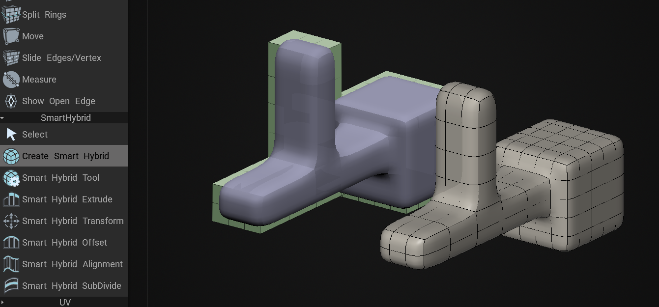

Gorbatovsky Posted June 9, 2025 Share Posted June 9, 2025 See, please video part-2 Smart Hybrid uses sub division when created from Lov Poly Mesh. 2 Quote Link to comment https://3dcoat.com/forum/index.php?/topic/31577-subdivision-surfaces-subd/#findComment-199627 Share on other sites More sharing options...
Gorbatovsky Posted June 9, 2025 Share Posted June 9, 2025 Smart Hybrid is probably not quite what our designers wanted. Quote Link to comment https://3dcoat.com/forum/index.php?/topic/31577-subdivision-surfaces-subd/#findComment-199628 Share on other sites More sharing options...

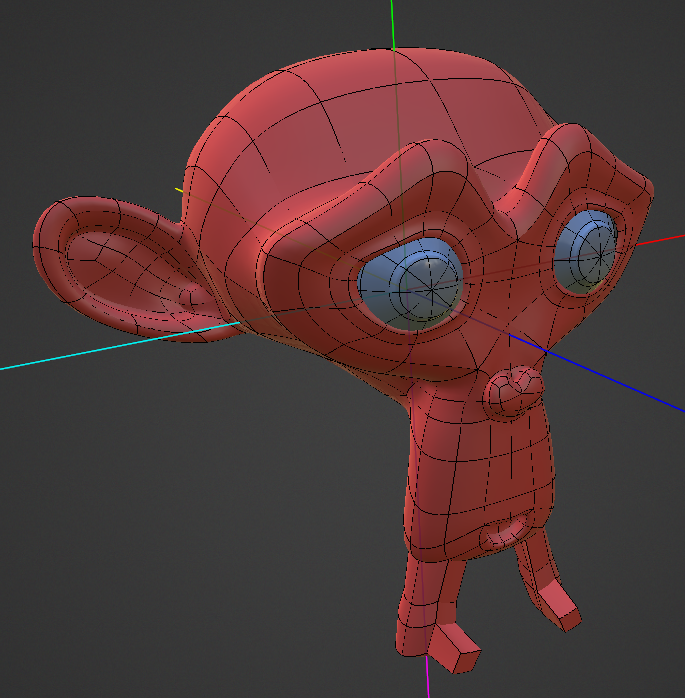

Advanced Member MJonathan Posted June 9, 2025 Author Advanced Member Share Posted June 9, 2025 Thanks for the videos! It will be a great update! I made this fast modeling using subd, it takes me 5 minutes. I hope this can be implemented in 3dcoat, as you can see I'm switching all the time to see the low poly and edit it in subd mode. There is an intermediate view mode that is the cage, where you can see both low poly/ subd. If this is implemented, I could start a youtube series about how to modeling for animation and vfx using 3dcoat. 2 Quote Link to comment https://3dcoat.com/forum/index.php?/topic/31577-subdivision-surfaces-subd/#findComment-199634 Share on other sites More sharing options...
Gorbatovsky Posted June 10, 2025 Share Posted June 10, 2025 17 hours ago, MJonathan said: I hope this can be implemented in 3dcoat, In Smart Hybrid Subdivision is used only in the initial stage when transforming faces into surfaces based on the Catmull Clark algorithm. Quote Link to comment https://3dcoat.com/forum/index.php?/topic/31577-subdivision-surfaces-subd/#findComment-199639 Share on other sites More sharing options...
