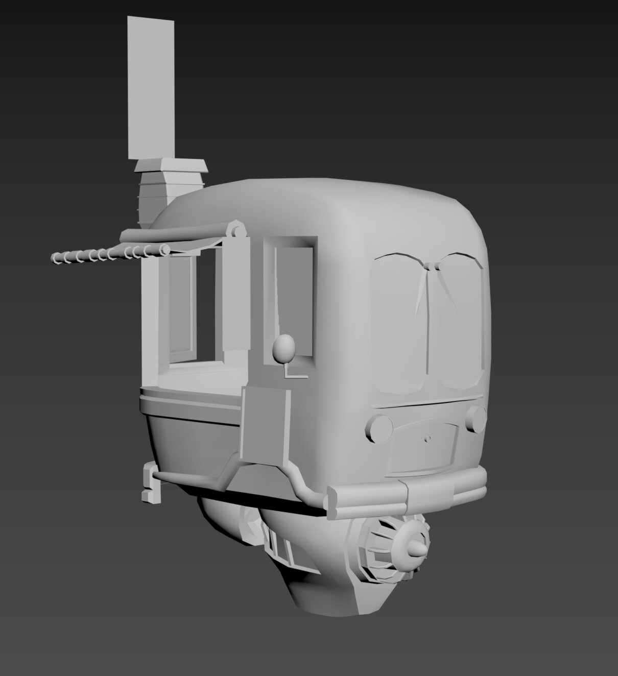

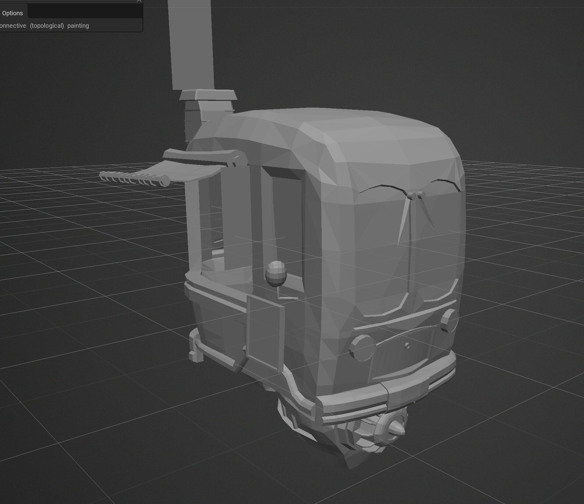

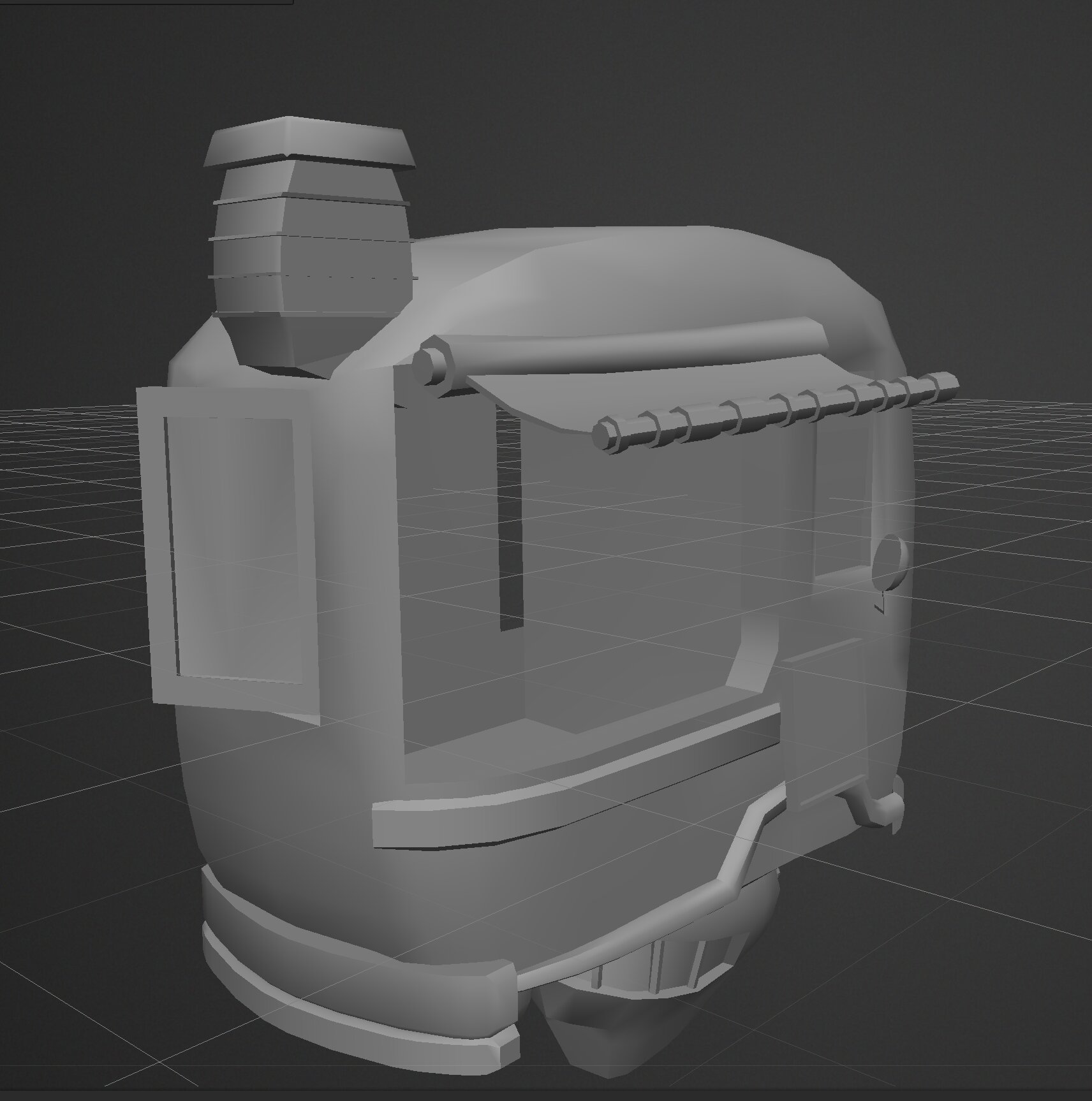

New Member hyujii Posted June 10, 2025 New Member Share Posted June 10, 2025 I’ve completed modeling and smoothing group work in 3ds Max, and now I’m trying to texture the model in 3DCoat. However, when I export the model from 3ds Max as an FBX or OBJ file and import it into 3DCoat, the smoothing groups don’t appear as they did in Max. Sometimes all the smoothing groups are gone, or they all seem to be merged into one, which makes the model look different from what I originally created. How can I properly import my model so that 3DCoat retains the smoothing groups as they appear in 3ds Max? Thanks in advance! in 3dsmax / fbx in 3d coat / obj in 3d coat Quote Link to comment https://3dcoat.com/forum/index.php?/topic/31578-how-can-i-import-smoothing-groups-from-3ds-max-to-3dcoat-correctly/ Share on other sites More sharing options...

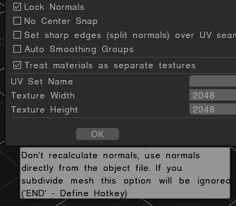

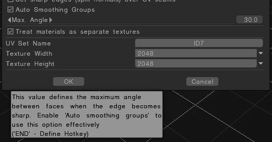

Carlosan Posted June 10, 2025 Share Posted June 10, 2025 Hi 3DCoat does support smoothing groups from other software with out using the auto-smoothing groups feature. Smoothing groups are supported via OBJ format. But you need to export normals also from your 3D-model app. 3DCoat uses normals in OBJ file to recover smoothing groups. Import the normal map using "Textures menu > Import > Normal map" You can send/receive models using the MAX applink. Here's a link to all the Applink. Also try turning on Lock Normals if the Normals was edited on the mesh model. * On the other hand, 3DCoat by default sets the smoothing groups to your object to 90 degrees when importing objects to the paint room or baking from the retopo room. In the import panel, choose auto-smoothing groups and set it to the degrees so desired. Start at 30 and then change it if necessary. Hope this help Quote Link to comment https://3dcoat.com/forum/index.php?/topic/31578-how-can-i-import-smoothing-groups-from-3ds-max-to-3dcoat-correctly/#findComment-199636 Share on other sites More sharing options...

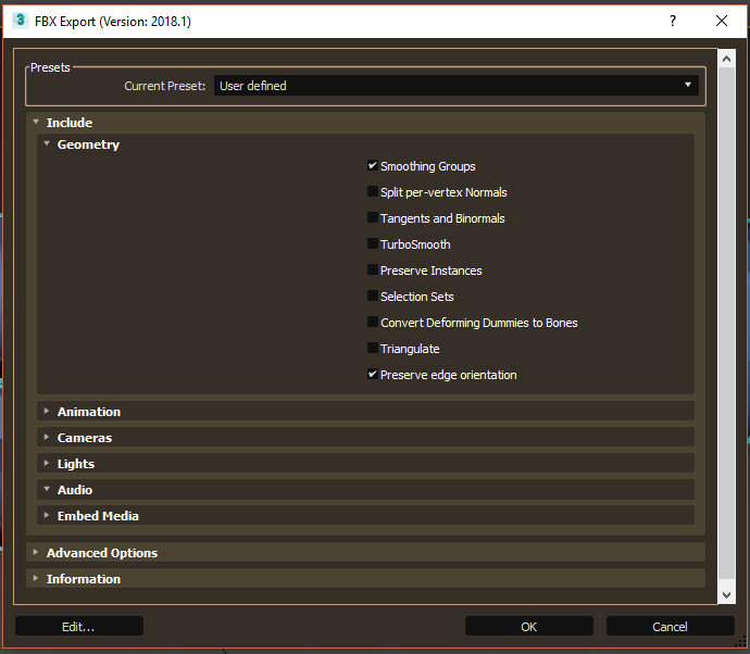

Carlosan Posted June 11, 2025 Share Posted June 11, 2025 I am afraid it is not possible... uncheck the normals box on export of an obj, but keep your smoothing group and optimize normals settings, it may be imports the OBJ file with the original hard edges. Sorry I don't have MAX installed to try it. * I'm not sure if this is ideal for your workflow Quote Link to comment https://3dcoat.com/forum/index.php?/topic/31578-how-can-i-import-smoothing-groups-from-3ds-max-to-3dcoat-correctly/#findComment-199671 Share on other sites More sharing options...

Carlosan Posted June 12, 2025 Share Posted June 12, 2025 What about fbx export ? Quote Link to comment https://3dcoat.com/forum/index.php?/topic/31578-how-can-i-import-smoothing-groups-from-3ds-max-to-3dcoat-correctly/#findComment-199679 Share on other sites More sharing options...
