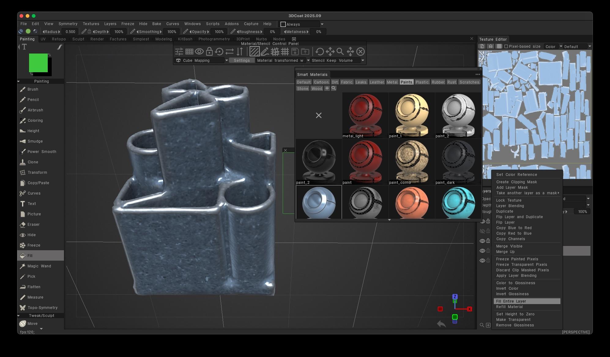

In 3DCoat 2025.09 for macOS, I performed the following steps: Voxel Sculpting > the largest sphere > Commands > Res+ four times to create a sphere with 62 million triangles, utilizing 12GB of memory (see the attached screenshot). I was able to save and load this sphere in a file of 535MB in size. Activity Monitor displayed 11.2GB of memory after loading the file. Then I downloaded your "PenHolder2000Blur.obj" and inspected it. 14+ million vertices. 29+ million tris. You cannot directly paint on this model. To make it proper, do: 3DCoat > File > Import > Import for AUTOPO > PenHolder2000Blur.obj > Required Poly Count = 20000 > [V] Bypass Density Painting & Stroke Guides > OK > UV/Mark Seams > Commands/Auto-Map > Bake > Bake w/ Normal Map (Per-Pixel) > OK > OK
To quickly paint the model: Windows > Panels > Smart Materials > Paints > paint_metal > OK > OK > Layers > [RMB] VolumeX > Fill Entire Layer
Please refer to the attached screenshot for reference.

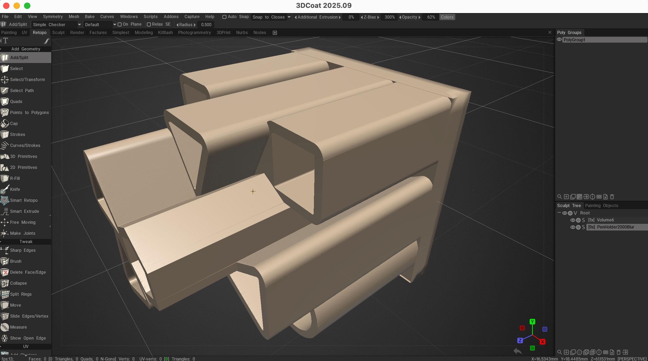

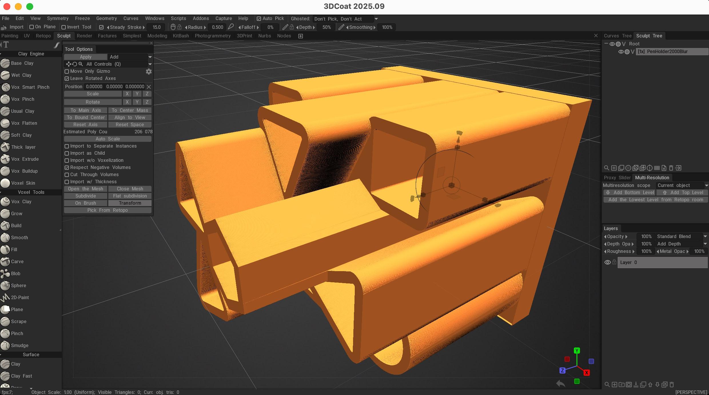

Today, I have rebuilt "3DCoat 2025.09" for macOS:
https://pilgway.com/~sergyi/links-macOS.html
The rebuild contains a fix from Pilgway developer which allows loading the model "PenHolder2000Blur.obj" using these steps in "3DCoat:
1. Startup dialog > Perform Retopology > Import huge reference mesh
2. File > Import > Import Mesh for Voxelization
