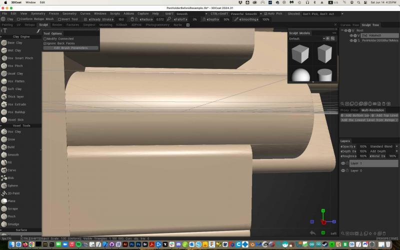

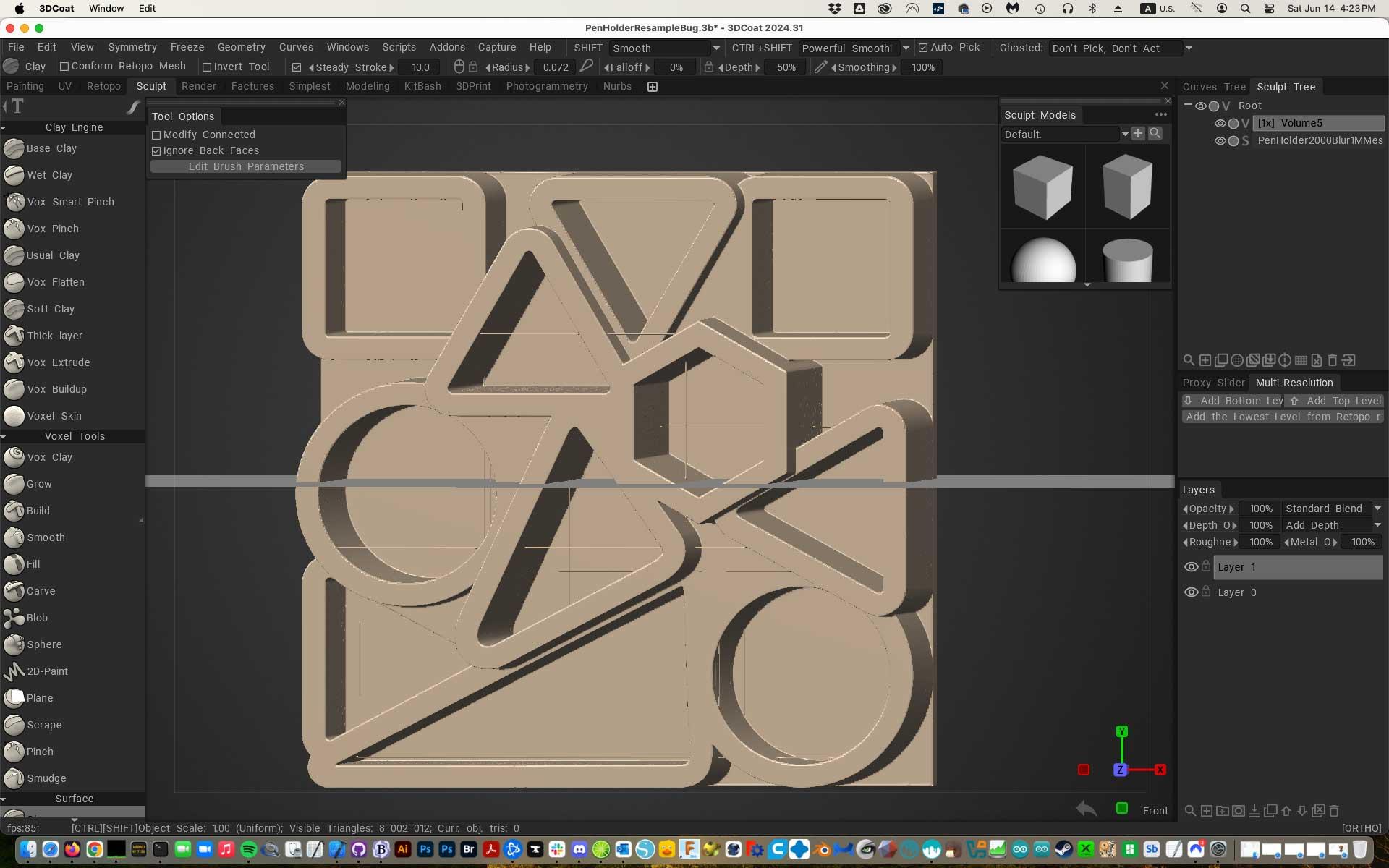

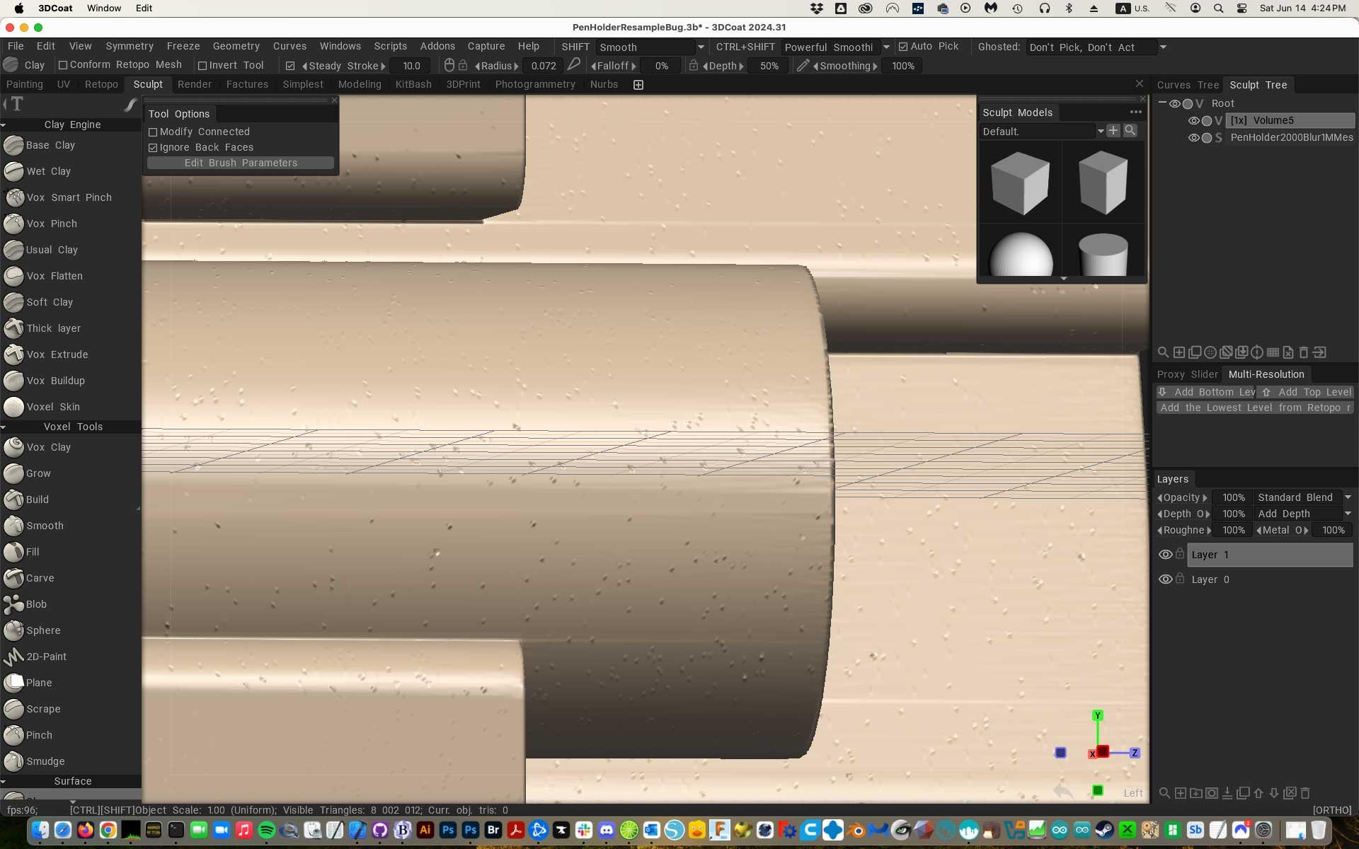

Member chriscox Posted June 14 Author Member Share Posted June 14 Here is the interior before resampling. Interior After Resampling. Note the thin rods connecting interior geometry that shouldn't be there. They are real geometry and can be edited - but there's a bug in the code that is connecting unrelated parts. Outside before. Outside after. Note the dings/divots/artifacts. Quote Link to comment Share on other sites More sharing options...
Solution Dmitriy Nos Posted June 15 Solution Share Posted June 15 10 hours ago, chriscox said: Note the thin rods connecting interior geometry that shouldn't be there Yes, there is such a problem in 3dcoat. Please send me a .3b scene so that I can remind the developer about this ancient bug. Quote Link to comment Share on other sites More sharing options...

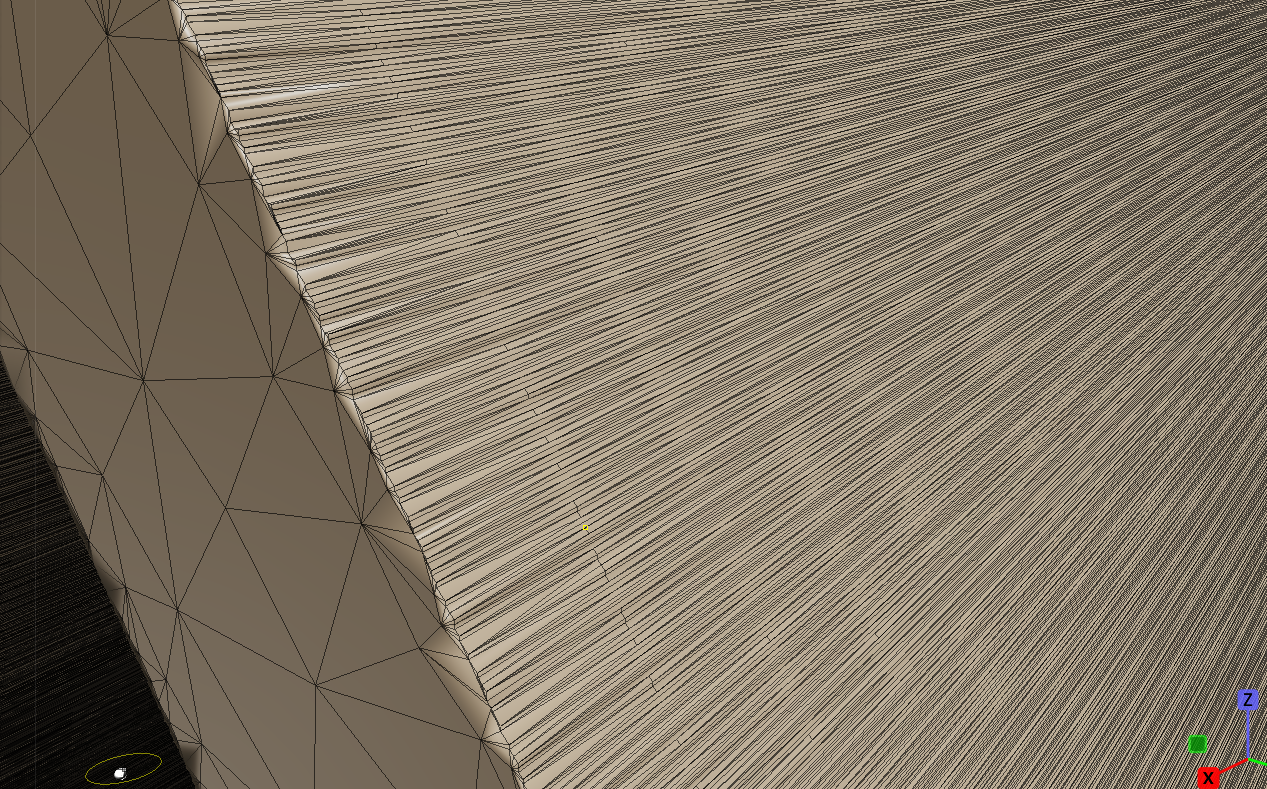

Dmitriy Nos Posted June 16 Share Posted June 16 15 hours ago, chriscox said: Ok, I sent you a direct message with a link to the example files (before and after). Thank you! I'll pass it on to the developer as a bug. But the mesh is stretched too much. Quote Link to comment Share on other sites More sharing options...
Member chriscox Posted June 17 Author Member Share Posted June 17 Yes, I know. That is something that I'm working on - it is an extreme extrusion, and my current extrusion code simply extrudes without altering the mesh beyond the edges of the extrusion map. And even with the stretched mesh, it works well for printing and texturing. But as an extreme case, it also seems to expose bugs in applications pretty frequently. 1 Quote Link to comment Share on other sites More sharing options...
