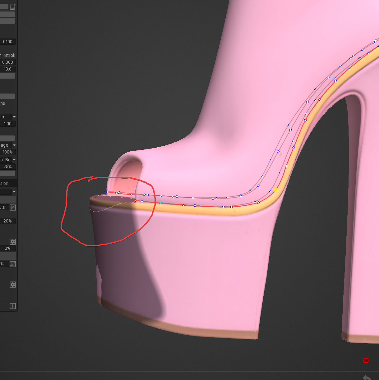

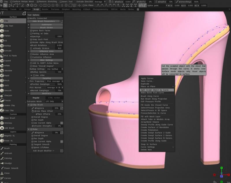

Member VRNardodaVinci Posted June 22 Member Share Posted June 22 I have a object I am trying to split by curves and encountering following issues. 1 .The object curve split is not honoring the actual curve definition. 2. To try and fix this I freeze the area that is getting adversely affected but the split is also not honoring the frozen area. See attached images. How do I fix this issue ? Thank you. Quote Link to comment Share on other sites More sharing options...
Carlosan Posted June 22 Share Posted June 22 What if you use Objects > Split ? Quote Link to comment Share on other sites More sharing options...

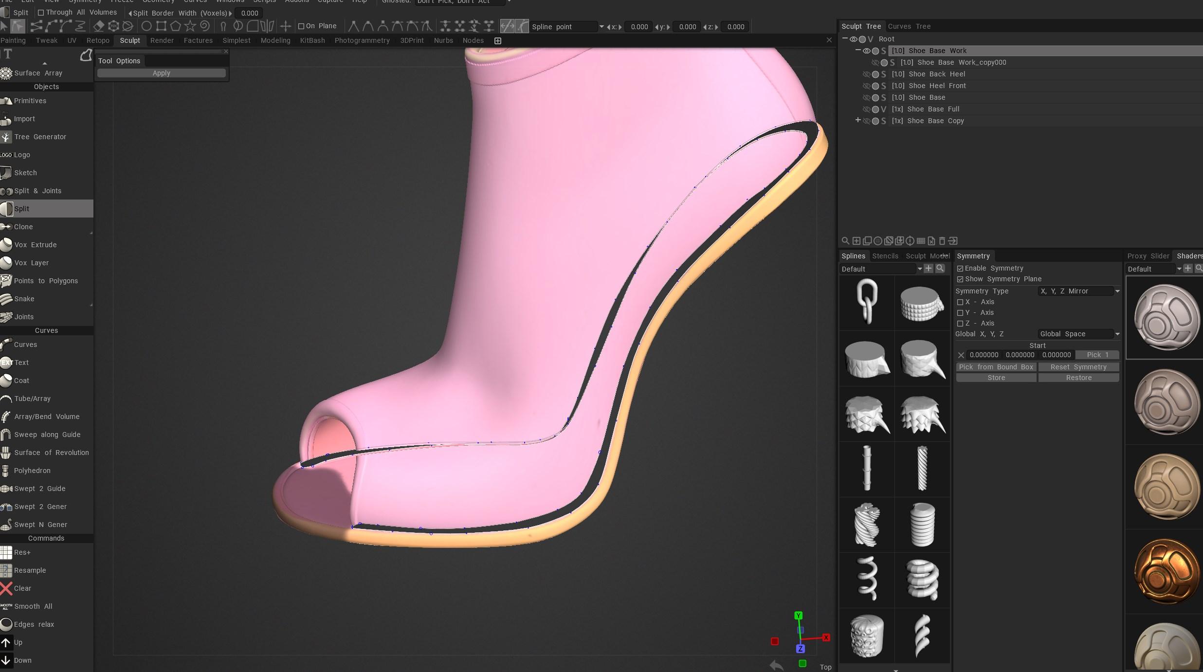

Member VRNardodaVinci Posted June 22 Author Member Share Posted June 22 That does not split out the entire shoe top, only the outlined curve which is not what I am after. Quote Link to comment Share on other sites More sharing options...
Member VRNardodaVinci Posted June 22 Author Member Share Posted June 22 Split object by curve does this , which is perfect other then the front area also being cut which I dont want nor even know why its happening at all. Quote Link to comment Share on other sites More sharing options...
Member VRNardodaVinci Posted June 22 Author Member Share Posted June 22 (edited) Also the fact it splits though a frozen area is a bug is it not ? Should all tools respect a frozen area ? Edited June 22 by VRNardodaVinci grammer edit Quote Link to comment Share on other sites More sharing options...

Member VRNardodaVinci Posted June 22 Author Member Share Posted June 22 23 minutes ago, Elemeno said: freeze doesnt work with voxels , never has , only in surface mode If you look at the attached images you will see I am using surface mode. Quote Link to comment Share on other sites More sharing options...
Carlosan Posted June 22 Share Posted June 22 Are you working on orthographic mode ? if not try switching to it. Quote Link to comment Share on other sites More sharing options...
Member VRNardodaVinci Posted June 22 Author Member Share Posted June 22 (edited) 6 minutes ago, Carlosan said: Are you working on orthographic mode ? if not try switching to it. yeah if you look in bottom right corner of image I am in Ortho, why would that matter if something is frozen or not , is it not just supposed to honor the freeze no matter those things ? @Carlosando you have access to files that are uploaded to support? I uploaded the file there you can try it out and take a look for yourself if you can figure out what is going on with it. Thanks Edited June 22 by VRNardodaVinci edit Quote Link to comment Share on other sites More sharing options...

Member VRNardodaVinci Posted June 22 Author Member Share Posted June 22 35 minutes ago, Elemeno said: mine seems to work I can't see from the image you sent what steps you used, did you use curve in the e and then freeze a area that was getting deleted and then split object via curve in the right click menu ? Quote Link to comment Share on other sites More sharing options...
Advanced Member Elemeno Posted June 22 Advanced Member Share Posted June 22 27 minutes ago, VRNardodaVinci said: I can't see from the image you sent what steps you used, did you use curve in the e and then freeze a area that was getting deleted and then split object via curve in the right click menu ? no youre right , the cut tool doesnt respect freeze areas either Desktop 2025-06-22 20-22-36.mp4 Quote Link to comment Share on other sites More sharing options...
Member VRNardodaVinci Posted June 22 Author Member Share Posted June 22 5 minutes ago, Elemeno said: no youre right , the cut tool doesnt respect freeze areas either Desktop 2025-06-22 20-22-36.mp4 1.93 MB · 0 downloads Thank you for taking the time to confirm. Quote Link to comment Share on other sites More sharing options...
Carlosan Posted June 22 Share Posted June 22 Bug confirmed. thanks for point it up Quote Link to comment Share on other sites More sharing options...
