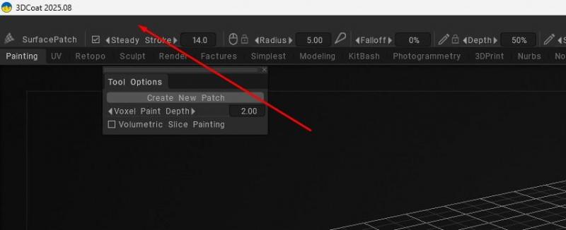

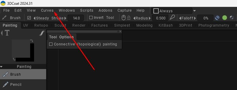

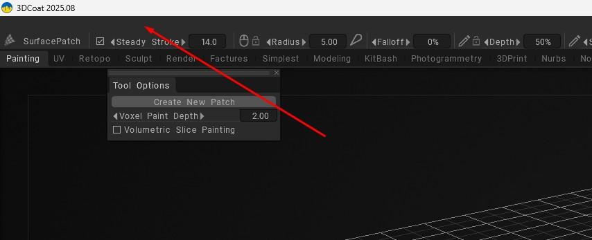

I have been trying to figure out why the title bar menu ie the File Edit View Curves menu bar is missing from 3DCoat-2025-08 see screen shots below the title bar is showing in my pervious version 3DCoat-2024-31 but not in the new release any assistance would be greatly appreciated I have uninstalled and reinstalled the new version both as an update from my pervious and as a clean install and it still does not work. Any help would be truly appreciated.

Hi
Try installing latest version 2025.09
Then delete the folder
C:\Users\<username>\Documents\3DCoat\UserPrefs\Rooms\CustomRooms
*3DC recreate it at the new start.
Thank you so much that worked truly appreciate the help
