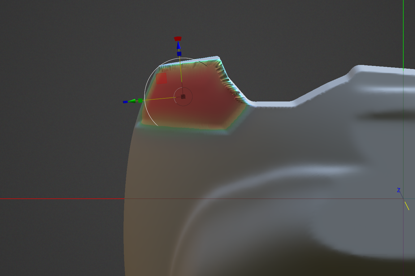

Member nikonb Posted June 28, 2025 Member Share Posted June 28, 2025 Hi, Why does the geometry gets pinched distorted when using pose tool ? what is the best way to solve this ? I have pretty high poly count resample, more than 1 million, Quote Link to comment https://3dcoat.com/forum/index.php?/topic/31625-pose-tool-geometry-issue/ Share on other sites More sharing options...

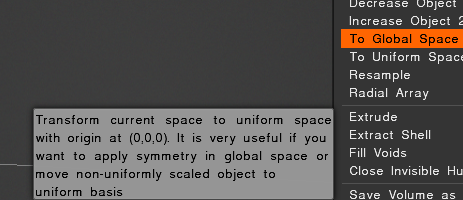

Carlosan Posted June 28, 2025 Share Posted June 28, 2025 Is your model on Non Uniform Scale ? If yes, try RMB over the model and apply "To Global Space" The model may have a high density of voxels in the total mesh distributed proportionally. I cannot see the entire model, in small sectors the mesh density will be lower and causes those pinches. Quote Link to comment https://3dcoat.com/forum/index.php?/topic/31625-pose-tool-geometry-issue/#findComment-199947 Share on other sites More sharing options...
Member nikonb Posted June 29, 2025 Author Member Share Posted June 29, 2025 ok super thank you ! I wasnt even aware of this ! 1 Quote Link to comment https://3dcoat.com/forum/index.php?/topic/31625-pose-tool-geometry-issue/#findComment-199964 Share on other sites More sharing options...
