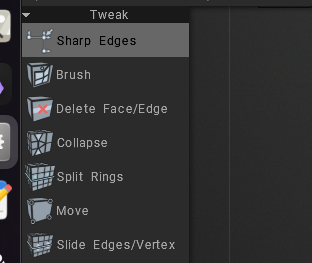

Contributor SreckoM Posted September 4, 2025 Contributor Share Posted September 4, 2025 I think if you mark it as Sharp Edges it should crease it. 1 Quote Link to comment https://3dcoat.com/forum/index.php?/topic/31807-live-smooth-mesh-in-sculpt-room-with-move-brush/#findComment-200704 Share on other sites More sharing options...
Advanced Member Henry Townshend Posted September 5, 2025 Author Advanced Member Share Posted September 5, 2025 (edited) Question: Why can't I Live Smooth single sided geo, but can Smooth(CC) it? Should this not theoretically be the same? https://www.dropbox.com/scl/fi/e5w5mzvstybp1v65o6i1u/2025-09-05-15-31-45.mp4?rlkey=7ap42ral2hpfgm0b8jr0nit6p&dl=0 And to ask again: Is there there no "dynamic thickness"? Like solidify? Also @SreckoM: Awesome! Creasing works. thx! Edited September 5, 2025 by Henry Townshend make clearer, typo Quote Link to comment https://3dcoat.com/forum/index.php?/topic/31807-live-smooth-mesh-in-sculpt-room-with-move-brush/#findComment-200710 Share on other sites More sharing options...

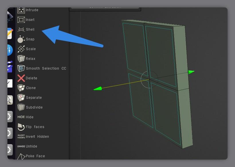

Contributor SreckoM Posted September 8, 2025 Contributor Share Posted September 8, 2025 On 9/5/2025 at 3:35 PM, Henry Townshend said: Question: Why can't I Live Smooth single sided geo, but can Smooth(CC) it? Should this not theoretically be the same? https://www.dropbox.com/scl/fi/e5w5mzvstybp1v65o6i1u/2025-09-05-15-31-45.mp4?rlkey=7ap42ral2hpfgm0b8jr0nit6p&dl=0 And to ask again: Is there there no "dynamic thickness"? Like solidify? Also @SreckoM: Awesome! Creasing works. thx! Live Smooth is voxelizing the mesh, and voxel does not work with single sided meshes, has to have thickness. Subdividing is just subdiving of polygonal mesh. Dynamic you mean procedural? There is thickness in Retopo room, named Shell. Not sure why it is not in Modeling too. I am having hard time understanding why Modeling is separated and things like this are happening, making more confusion than necessary but ... 2 Quote Link to comment https://3dcoat.com/forum/index.php?/topic/31807-live-smooth-mesh-in-sculpt-room-with-move-brush/#findComment-200730 Share on other sites More sharing options...
Advanced Member Henry Townshend Posted September 8, 2025 Author Advanced Member Share Posted September 8, 2025 (edited) 2 hours ago, SreckoM said: Live Smooth is voxelizing the mesh, and voxel does not work with single sided meshes, has to have thickness. Subdividing is just subdiving of polygonal mesh. Dynamic you mean procedural? There is thickness in Retopo room, named Shell. Not sure why it is not in Modeling too. I am having hard time understanding why Modeling is separated and things like this are happening, making more confusion than necessary but ... Thanks again for the tip! Makes sense that Flat Planes do not work with Voxels. Seemed to me tho that Live smooth uses Surface, judging at least from the layer icon in Sculpt Room. I was referring to what is called in ZBrush "Dynamic Thickness", which lets you temporarily add thickness to a mesh, like the Solidify modifier in Blender. Edited September 8, 2025 by Henry Townshend correction Quote Link to comment https://3dcoat.com/forum/index.php?/topic/31807-live-smooth-mesh-in-sculpt-room-with-move-brush/#findComment-200731 Share on other sites More sharing options...
