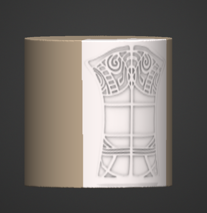

Member pabstblue Posted October 4 Member Share Posted October 4 I was wondering if there was a setting or something to to make my alpha brush curve around a curved surface? Quote Link to comment Share on other sites More sharing options...

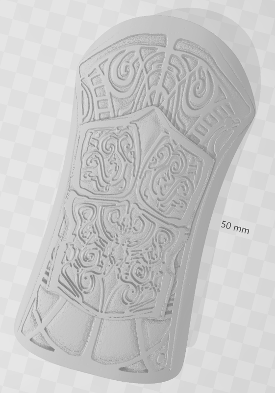

0 Member pabstblue Posted October 7 Author Member Share Posted October 7 Carlosan Thanks for the information. Now how would I make it part of the model so it would be 3D printable and not just a skin on a model? Quote Link to comment Share on other sites More sharing options...

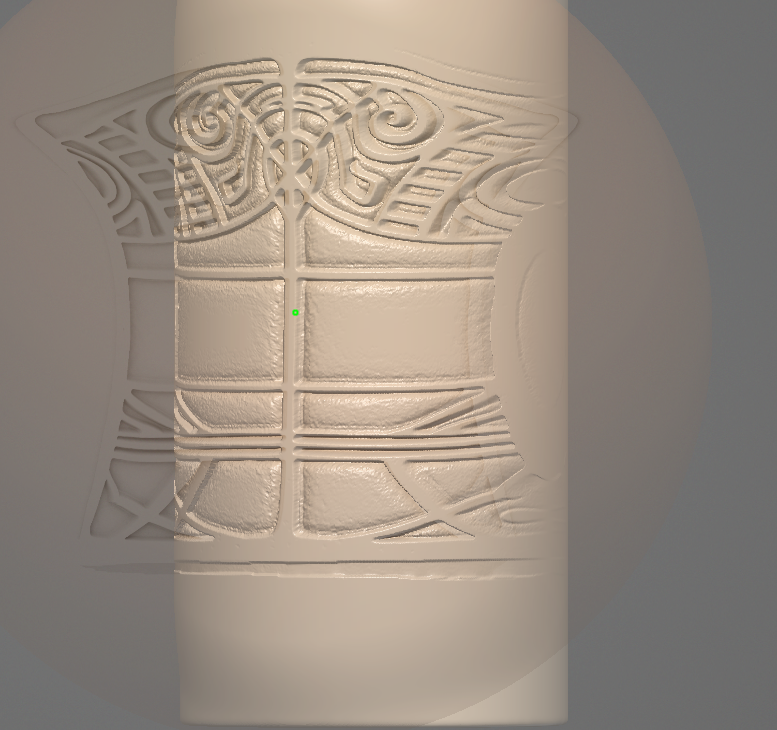

0 Member pabstblue Posted October 9 Author Member Share Posted October 9 Thanks but I cannot get the stencil to work either. It distorts on the edges around the curve just like the alpha. Quote Link to comment Share on other sites More sharing options...

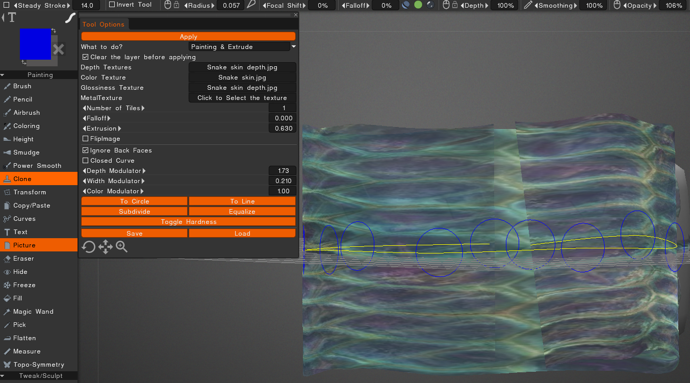

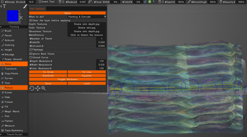

0 Carlosan Posted October 9 Share Posted October 9 Did you try Picture Tool ? 1 Quote Link to comment Share on other sites More sharing options...
0 Member pabstblue Posted October 11 Author Member Share Posted October 11 Thanks for the help. I think I got what I needed. 1 Quote Link to comment Share on other sites More sharing options...
