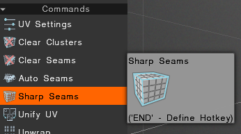

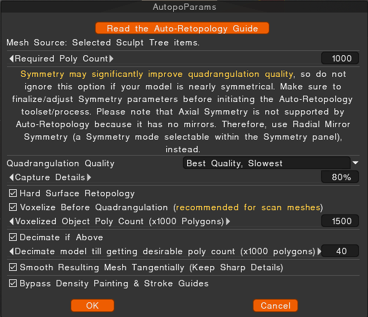

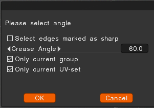

Carlosan Posted October 28, 2025 Share Posted October 28, 2025 You can draw strokes to help autoretopo to follow the edgeflow Hope this help Try this settings for autoretopo on hard surface models After autopo, you can mark edges as sharp. Or when select "Mark Seams", assign Sharp Seams automatically for Unwrap Quote Link to comment https://3dcoat.com/forum/index.php?/topic/32131-hard-edges-for-edge-flow-in-autotopo/#findComment-201328 Share on other sites More sharing options...
