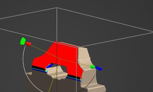

Member Matadem Posted November 2, 2025 Member Share Posted November 2, 2025 (edited) Hello I cannot figure out why the pose tool does not select all the way thru. I made a sphere and when trying the pose tool it only selects half way. I have selected ...through all volumes.. Where else do I need to look? Also when I am drawing lines curves how to make sure they are running straight to x,y and z...like cad drawing lines..or like blender it snap to the axis? is there a way to snap from the middle of your drawing? Tnx! Edited November 2, 2025 by Matadem Quote Link to comment https://3dcoat.com/forum/index.php?/topic/32185-pose-tool-not-selecting-thru/ Share on other sites More sharing options...

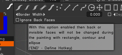

Carlosan Posted November 2, 2025 Share Posted November 2, 2025 Yes, check the Strokes Panel (E) -> Ignore backfaces = OFF Quote Link to comment https://3dcoat.com/forum/index.php?/topic/32185-pose-tool-not-selecting-thru/#findComment-201425 Share on other sites More sharing options...
Member Matadem Posted November 2, 2025 Author Member Share Posted November 2, 2025 Tnx ...I would have never find it lol. 1 Quote Link to comment https://3dcoat.com/forum/index.php?/topic/32185-pose-tool-not-selecting-thru/#findComment-201426 Share on other sites More sharing options...
