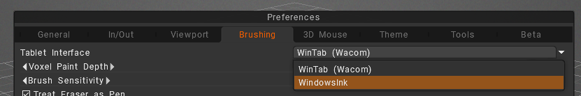

Hi
Try swapping to WindowsInk driver on Edit Menu > Preferences > Brushing Tab
The 2025 license doesn't work with 2021.
If the problem remains, we will give you an extra 2021 license, write an email to business@pilgway.com

Hi
I mentioned in my original post it doesn't have anything to do with Tablet Interface modes Wintab / WindowsInk. It doesn't effect the freeze at all. Brushing in all versions works fine. UNDO freezes the 2024-2025 3DCoat version for some reason.
I had another Finnish friend try the latest version 2025.10 and he experienced the same micro freeze. he doesn't even have a drawing tablet installed and did it with a mouse. is it an issue with windows language install or something like that? like Photoshop has a known issue where your binds don't work with certain windows language packages.
