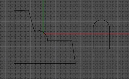

Member Matadem Posted November 14, 2025 Member Share Posted November 14, 2025 (edited) Hello I am trying to model a daft punk helmet gold one. There are 2 shapes that I need to make for the pose tool. I manage to get close...but I cannot figure out if I use the curves editor..if I can manipulate the shape (of the curves)after it is made? I saw a video that you can use imported shapes as well...would this be a better option? or is there a better way to do this? wouldnt it be nice to have something like shape builder like adobe has? combining shapes to make a new one? or can 3dcoat do it? Tnx! Edited November 14, 2025 by Matadem Quote Link to comment https://3dcoat.com/forum/index.php?/topic/32260-how-would-you-do-this/ Share on other sites More sharing options...

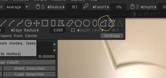

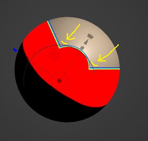

Member Matadem Posted November 14, 2025 Author Member Share Posted November 14, 2025 (edited) Hello what I meant is the curves editor attached menu.jpg is there a tutorial on that tool? If I use is how can I move the points after the shape is made? in Moi3d I can just drag the points around. on the other pics ... I can combine them but I cannot really align the good so there would be cleaning to do on the last pic with yellow arrows I am trying to add some fillets....but cannot figure out how to do it. Tnx! Edited November 14, 2025 by Matadem Quote Link to comment https://3dcoat.com/forum/index.php?/topic/32260-how-would-you-do-this/#findComment-201585 Share on other sites More sharing options...
Carlosan Posted November 14, 2025 Share Posted November 14, 2025 This curves type stroke it is not editable once you apply the selected tool. You can try with the Smart Hybrid System Quote Link to comment https://3dcoat.com/forum/index.php?/topic/32260-how-would-you-do-this/#findComment-201586 Share on other sites More sharing options...
