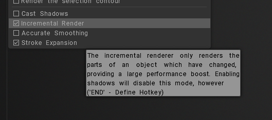

Carlosan Posted July 2 Share Posted July 2 Could you please try this simple test: Geometry > Incremental Render = ON Quote Link to comment https://3dcoat.com/forum/index.php?/topic/33520-3dcoat-2026-development/page/8/#findComment-205493 Share on other sites More sharing options...
Contributor wendallhitherd Posted July 2 Contributor Share Posted July 2 9 hours ago, Carlosan said: Could you please try this simple test: Geometry > Incremental Render = ON Hello! incremental render on / off does not seem to make difference 1 1 Quote Link to comment https://3dcoat.com/forum/index.php?/topic/33520-3dcoat-2026-development/page/8/#findComment-205502 Share on other sites More sharing options...

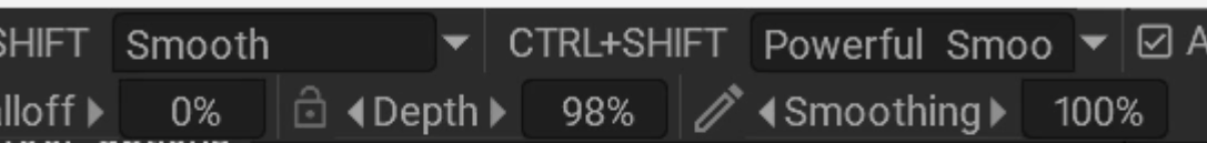

Contributor wendallhitherd Posted July 2 Contributor Share Posted July 2 As well more things seem to be broken or bugs: - Stroke mode doesn't any longer seem to be being saved into brush presets when set to lasso for freeze brush. resets back to hard paint. I think the storage hash in the brush xml is invalid for lasso. Sus is "EModeHash" Before (previous versions of 3dcoat this woulsd store lasso) <EModeHash>000087EA</EModeHash> After. I assume this is supposed to encode lasso brush but it resets back to hard-paint <EModeHash>000086EB</EModeHash> 2026-07-02 15-51-34.mp4 - when decimating a surface, the shift / ctrl shift mode changes to decimate. it seems likely that the ui command for the geometry -> decimate and the brush mode -> decimate are identical and so mapping a shortcut to the geometry decimate will also invoke the shift-menu decimate 2026-07-02 15-48-52.mp4 - when using detail brush modifier while in voxel mode, and then switching to surface mode, the mesh will be broken. 2026-07-02 15-38-36.mp4 1 1 Quote Link to comment https://3dcoat.com/forum/index.php?/topic/33520-3dcoat-2026-development/page/8/#findComment-205507 Share on other sites More sharing options...
