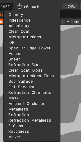

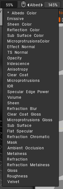

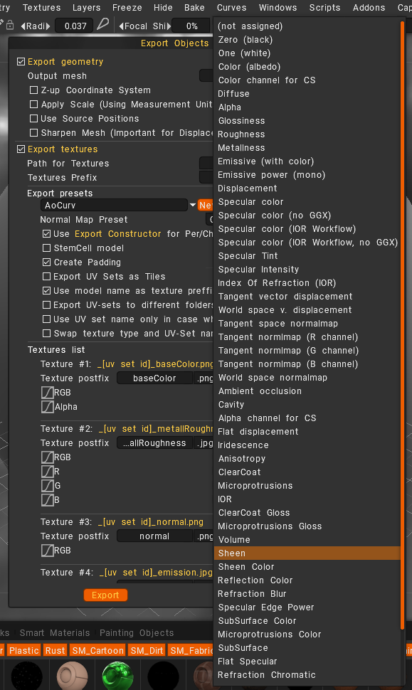

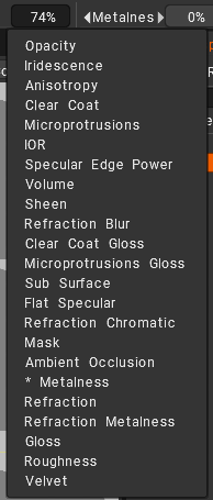

Carlosan Posted May 20 Share Posted May 20 New Feature: Press with RMB over Albedo, Gloss, Metalness to change channel type. This channels are also show on Constructor export options 1 Quote Link to comment https://3dcoat.com/forum/index.php?/topic/34175-3dcoat-2026-gpuppp-development/page/2/#findComment-204891 Share on other sites More sharing options...
