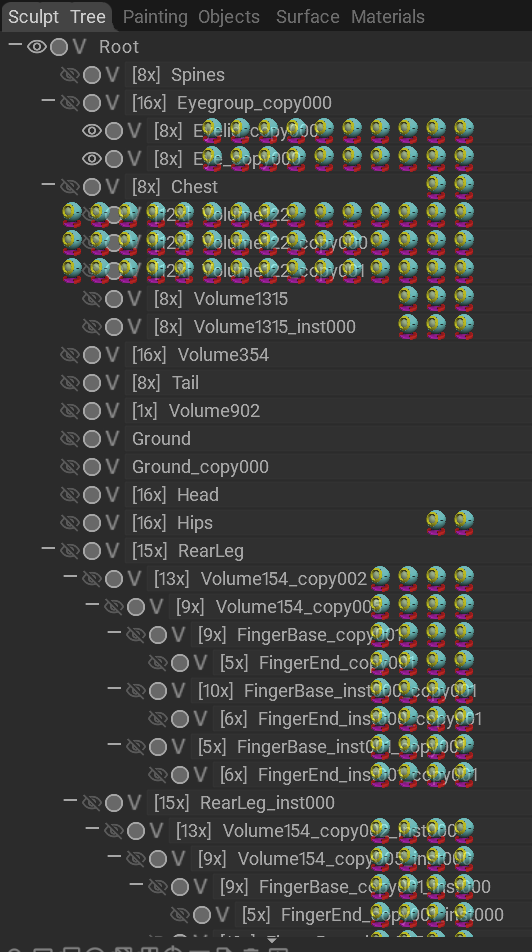

Advanced Member gbball Posted June 6 Advanced Member Share Posted June 6 I just reopened one of my projects in 2026.02 and this is what I'm seeing in the Voxtree Is this happening to anyone else on sculpt meshes after working in the paint workspace? I didn't look like this when I closed the file previously. Quote Link to comment https://3dcoat.com/forum/index.php?/topic/34175-3dcoat-2026-gpuppp-development/page/4/#findComment-205142 Share on other sites More sharing options...

Reputable Contributor AbnRanger Posted June 6 Reputable Contributor Share Posted June 6 14 hours ago, gbball said: I just reopened one of my projects in 2026.02 and this is what I'm seeing in the Voxtree Is this happening to anyone else on sculpt meshes after working in the paint workspace? I didn't look like this when I closed the file previously. I don't get as many as you do, but I already reported this and there should be a resolution in the next build. 1 Quote Link to comment https://3dcoat.com/forum/index.php?/topic/34175-3dcoat-2026-gpuppp-development/page/4/#findComment-205150 Share on other sites More sharing options...

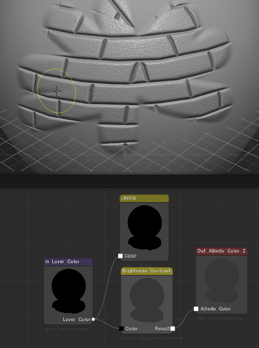

Carlosan Posted June 14 Share Posted June 14 Adding filters to the layer delete color channel sidenote: - to add "M" key to mute on/off any selected Node - delete any Node using Delete key - add an option to replace Node when pressing RMB 1 Quote Link to comment https://3dcoat.com/forum/index.php?/topic/34175-3dcoat-2026-gpuppp-development/page/4/#findComment-205199 Share on other sites More sharing options...

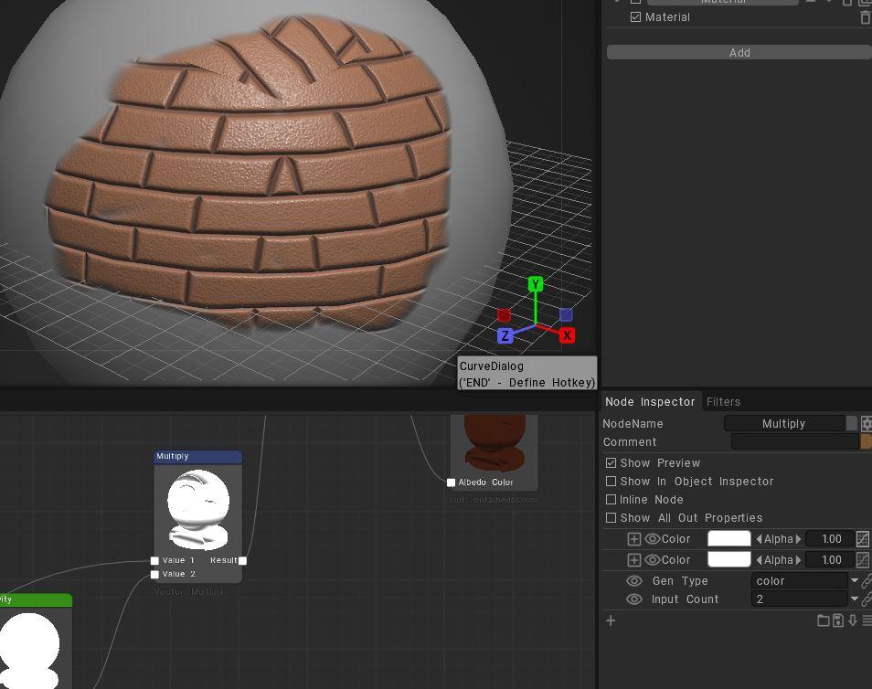

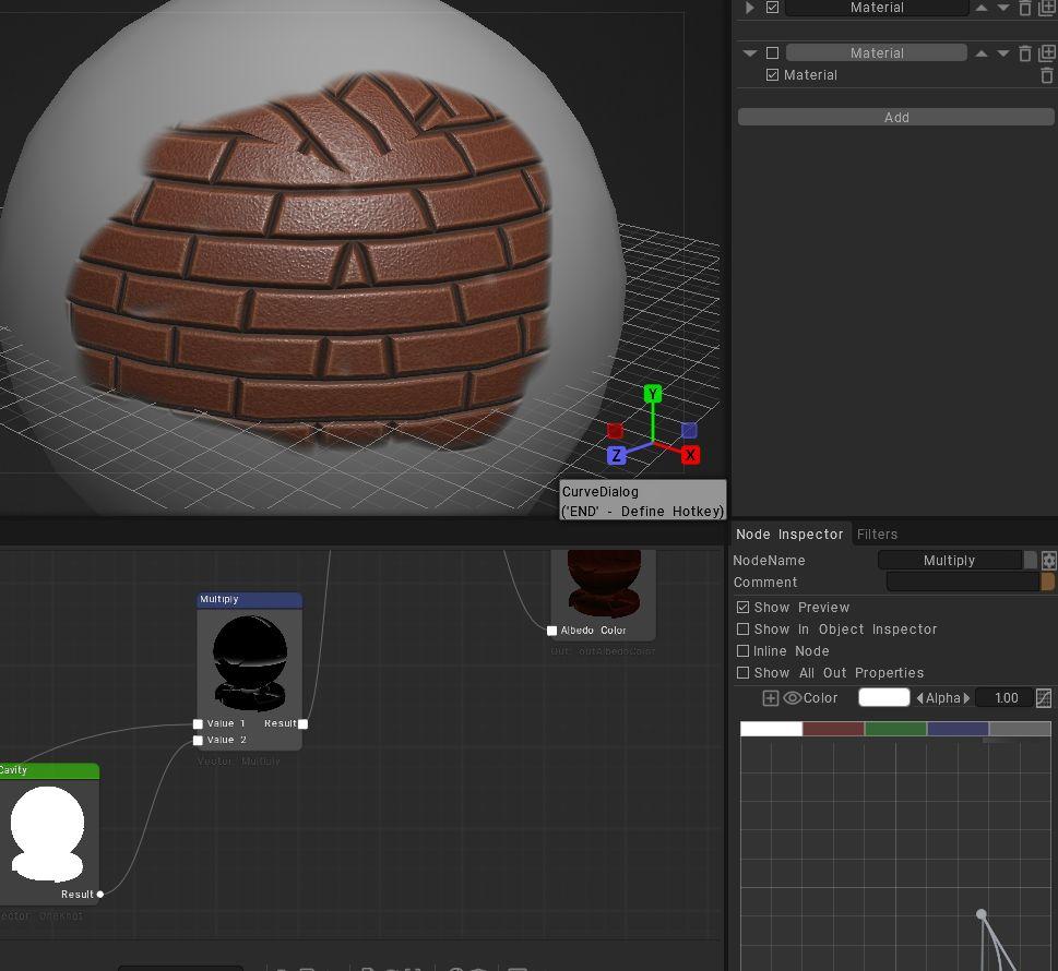

Carlosan Posted June 14 Share Posted June 14 Multiply or Mix Nodes (any node with CurveDialog): compress/expand CurveDialog change saturation Curve dialog expanded Curve dialog compressed Quote Link to comment https://3dcoat.com/forum/index.php?/topic/34175-3dcoat-2026-gpuppp-development/page/4/#findComment-205200 Share on other sites More sharing options...
carrots Posted June 14 Author Share Posted June 14 40 minutes ago, Carlosan said: Adding filters to the layer delete color channel `InLayerColor` is the color you used to paint on the layer with the brush (this allows the material to generate differently based on the brush color); it is not the color present on the material itself or on underlying components. If you need the color from underlying layers, use `InLowerLayer`; if you need the color from underlying components, use `InColorProperty`. Quote Link to comment https://3dcoat.com/forum/index.php?/topic/34175-3dcoat-2026-gpuppp-development/page/4/#findComment-205201 Share on other sites More sharing options...
carrots Posted June 14 Author Share Posted June 14 31 minutes ago, Carlosan said: Multiply or Mix Nodes (any node with CurveDialog): compress/expand CurveDialog change saturation Curve dialog expanded Curve dialog compressed Currently, curves are simply not processed when hidden; you aren't just hiding them, you are disabling them. If the curves graph takes up too much space, you can switch to gradient mode, but it is better to use Simple or Levels modes, as they are faster and consume fewer resources. 1 Quote Link to comment https://3dcoat.com/forum/index.php?/topic/34175-3dcoat-2026-gpuppp-development/page/4/#findComment-205202 Share on other sites More sharing options...
