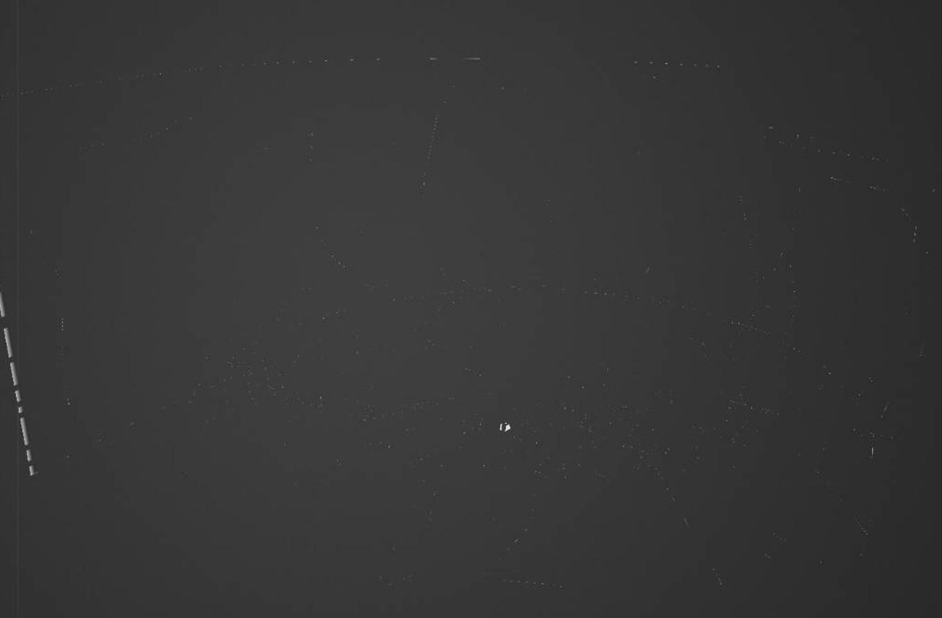

This leading me to another thing - when I am uploading my mesh - it has white aliased borders, with no texture applied at all. I dont know what the issue here with Viewport, but changing its settings does nothing too - it just broke. Below is screenshot of model, with Layer 0 disabled, no textures applied in Flat shading mode. Thode white boders are being on top of everything is just annoying..
Same mesh on my 2025.11 Textura relese have no such problem, Low-Poly option in Viewport working correctly.
