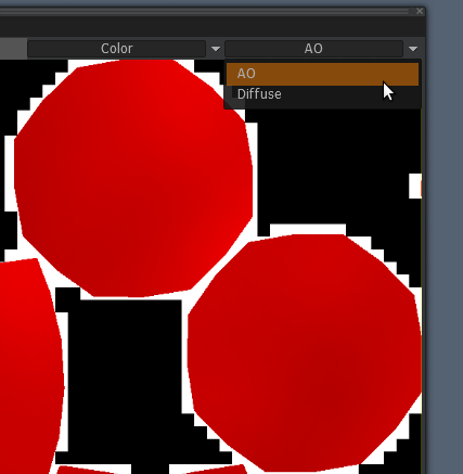

Reputable Contributor digman Posted August 26, 2012 Reputable Contributor Share Posted August 26, 2012 "Support multiple UVs per vertex/face", You can have this in 3DCoat. You have to do a little setting up in the retopo room but it is not hard... The picture shows a AO uv set and a Diffuse uv set I created. They both share the same mesh with identical but separate uv sets so they share the same faces/vertices. Each UV set can be exported separately also. I do not work in the industry but tried to understand what is needed and if I can figure it out for 3DCoat I work at it... The uvs are just for show, nothing is done to them yet... If this what you are looking for maybe I can do a video. EDIT: The picture is from the retopo room right before I merged into the paint room showing the two uv sets I created sharing the same faces/vertices... Again forgive the uv set as I'm just showing that it can be done... This is something I had to figure out so if it works in all cases or meets all your needs, I would not know... I also might not understand entirely what you are asking for and the above is something, well at least I know how to make multiple uvs set per face/ vertex... Quote Link to comment https://3dcoat.com/forum/index.php?/topic/6065-introduce-yourself/page/14/#findComment-79509 Share on other sites More sharing options...
Member megatrousers Posted August 26, 2012 Member Share Posted August 26, 2012 "Support multiple UVs per vertex/face", You can have this in 3DCoat. You have to do a little setting up in the retopo room but it is not hard... Can you elaborate a little please? Do you mean via uvTiling, uv sets, or both? What is the workflow? I just tried to import an fbx with 2 uv sets, but while both sets are listed in the import dialogue, and selectable in the rooms, only one of the sets contains a uv map, the other is completely empty. I know both sets are intact in the original file though because if I open it in the ultimate unwrap 3d demo, both sets are present and correct. Using 3dc 3.7.13 - perhaps I need a newer version? Quote Link to comment https://3dcoat.com/forum/index.php?/topic/6065-introduce-yourself/page/14/#findComment-79510 Share on other sites More sharing options...
Reputable Contributor digman Posted August 26, 2012 Reputable Contributor Share Posted August 26, 2012 My workflow was through retopo room / creating the uv sets / merging into the paintroom. How are you importing your mesh, into the paint room, into the retopo room. Remember this something I'm working out as I go. (for some reason I like figuring out problems) I been using 3DCoat for about 5 years so I know a few tricks and aware of some things you can do with it that a new user might be unaware of. Creating only Uv sets, no tiling... The fbx problem, since I don't have access to it, I can not really tell what is happening with it... I will test one of my fbx files... Edit: I exported the ball mesh with the uv sets as a fbx. Opened a new scene in 3DCoat. Imported the Fbx file and both uv sets were correctly imported. Quote Link to comment https://3dcoat.com/forum/index.php?/topic/6065-introduce-yourself/page/14/#findComment-79511 Share on other sites More sharing options...

Member megatrousers Posted August 26, 2012 Member Share Posted August 26, 2012 I import the model (fbx) for per pixel painting. The retopo room and how it relates to the other rooms is something of a mystery to me at the moment. Actually, all the merging stuff confuses me a bit. If I import as a retopo mesh, 3dc doesn't ask about uvs at all, but imports (and displays in the uv preview window) one uv set. I had a look at your thread here: http://3d-coat.com/forum/index.php?showtopic=7263 Do your methods require the sets be created in 3dc? I think if the process is this involved, I would ultimately lose more time than I save. Thanks for your efforts though. I suppose what I'd like is to be able to import a model with 2 sets each covering the same polys, switch between them (and see them!) freely in the uv and paint rooms and export the model with the sets intact. An additional option in the UV room to [Copy selected faces to] in addition to moving them would be gravy. Maybe if enough people deemed such a level of support useful, a feature request would be appropriate, but I know Andrew is swamped with a million other things. Quote Link to comment https://3dcoat.com/forum/index.php?/topic/6065-introduce-yourself/page/14/#findComment-79518 Share on other sites More sharing options...
