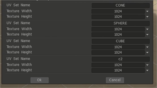

Carlosan Posted March 3, 2016 Author Share Posted March 3, 2016 Still trying to find a workflow obj, fbx dae... 3DC > import model for ppp > all the materials are listed as uvset suppose i have a model with 3 objects: cube, sphere, cone every model have their own uvset and materials: cube, sphere, cone Thread retopo objects as paint objects = ON When i import the fbx model for ppp there is 3 paint objects, 3 surface materials, 3 uvset When i import the obj model for ppp there is 3 paint objects, 3 surface materials, 3 uvset Thread retopo objects as paint objects = OFF When i import the fbx model for ppp there is 3 paint objects, 3 surface materials, 3 uvset When i import the obj model for ppp there is 3 paint objects, 3 surface materials, 3 uvset IF i add a new material to one object, example i a ssign a new material to one cube face... When i import the obj model for ppp there is 3 paint objects, 4 surface materials, 4 uvset why ? i still have 3 uvset, one by object... not 4 im lost 3.zip Quote Link to comment Share on other sites More sharing options...

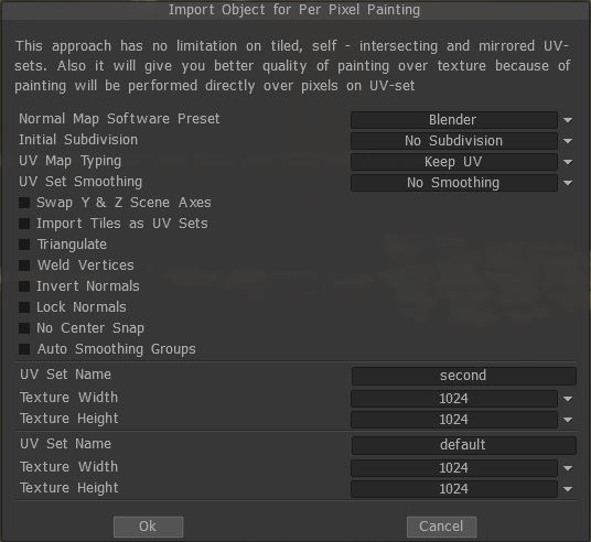

Reputable Contributor digman Posted March 4, 2016 Reputable Contributor Share Posted March 4, 2016 (edited) The OBJ file format though can support more than one UV set per mesh... 3DC will recognize the multiple uv sets for one mesh in an obj file.. See attached image. It has to be written a certain way, I have not studied enough to know yet... The cube in my example had the two uv sets created inside 3DC and exported from the retopo room. I then imported the cube into PPP mode in the paint room It is a simple cube with two uv sets and a surface material associated with each uv set... This imports into 3DC correctly as one model with 2 uv sets and a surface material for each uv set. If I misunderstood your statement, then please inform me. Edited March 4, 2016 by digman Quote Link to comment Share on other sites More sharing options...

Carlosan Posted March 5, 2016 Author Share Posted March 5, 2016 The obj model exported from Blender 2.77 import into SubstancePainter show the same problem. 3 models but 4 uvsets obj file system = no good im rethinking my workflow, i need to import/export one model with some subobjects without troubles Quote Link to comment Share on other sites More sharing options...
