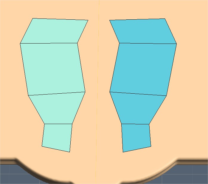

Advanced Member Gary Dave Posted March 17, 2016 Advanced Member Share Posted March 17, 2016 Hey,v4.5.19 I'm having a real bad time trying to do some manual retopo. I've always disabled virtual mirror mode as I like to work on whatever side of the mesh I'm looking at, but I can't go 2 clicks without it telling me that the symmetry is broken. If using the points/faces tool I can't even click once without it telling me I don't have perfect symmetry. (though this could be normal, as it resets to perfect symmetry after first poly creation) I used to be able to move verts close to the symmetry line together and they would just snap, symmetry would remain. But now, without virtual mirror mode it breaks the symmetry 100% of the time for me. Also, as soon as I get that red bit of text at the bottom saying "Partial_symmetry x.x%", it's basically game over, everything goes screwy. Image to prove I'm not crazy: I'd also like to provide a massively trimmed down version of the file if someone wants to take a look at it? Although this is definitely not file specific, I can re-create it 100% in a new file. https://drive.google.com/file/d/0B_uuF_LuV3aldWwtMlRRSEpQa3M/view?usp=sharing Quote Link to comment Share on other sites More sharing options...

Advanced Member Gary Dave Posted March 17, 2016 Author Advanced Member Share Posted March 17, 2016 (edited) Hey Carlosan, thanks for checking it out. Is 4.5.31 a stable build or a beta? I run it via steam so I'm on whatever version is published there. Did you try to move the verts toward the symmetry line? I have no problems getting what you have in your image, but the moment I try to join a mesh on one side to the other by snapping the verts together on the X, that's when it tells me symmetry is broken. Edited March 17, 2016 by Gary Dave Quote Link to comment Share on other sites More sharing options...
