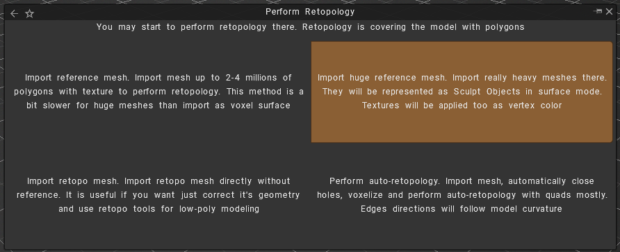

The below works best for creating a uv-set for a model that has no prior uv set creation. In this method, make sure your model has no errors.
- Use the Perform Retopology under the New Menu.
- Look at the 4 ways of importing the mesh closely. One of the top two are the best in this case.
- Next go to the Retopo room, Import your mesh using the import function under the Retopo Menu. Choose no on snapping the retopo mesh, there is no need of doing that in this case.
- Create your seams and unwrap.
Side Note: if you have errors in the mesh, yes you will have remove the error mesh from the retopo room and re-import the corrected one. You of course will lose your former seam selections. 3DC assumes you have a clean mesh to start with.
- Export the model and its Done.
