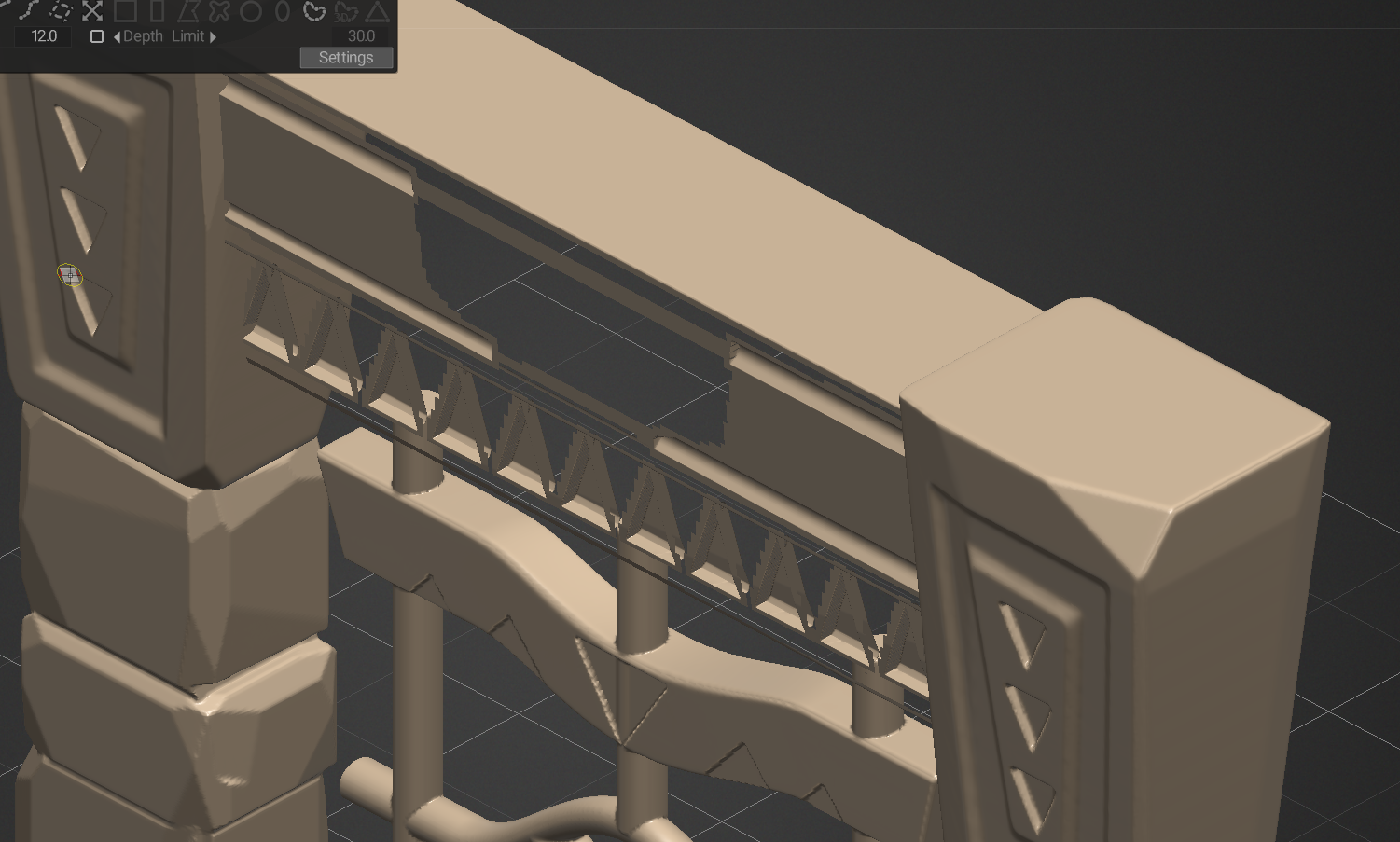

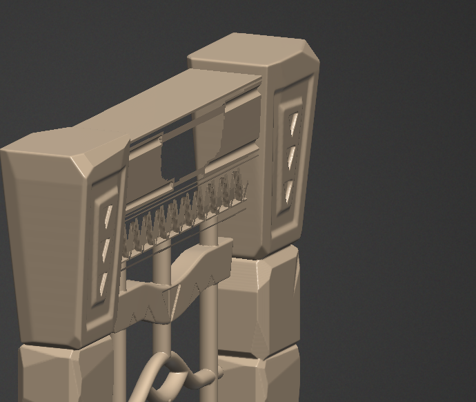

New Member Mikelon Posted March 3 New Member Report Share Posted March 3 Hello, I have this problem whenever I open a project that I worked on the day before, objects, or meshes, appear in my project that are transparent and it seems that something is missing, do you know how to solve that to return it to normality? Quote Link to comment Share on other sites More sharing options...
Solution Oleg Shapov Posted March 4 Solution Report Share Posted March 4 Hello, sometimes this happens when you have a thin volume in surface mode (S) and you transfer it to voxel mode (V). Quote Link to comment Share on other sites More sharing options...
