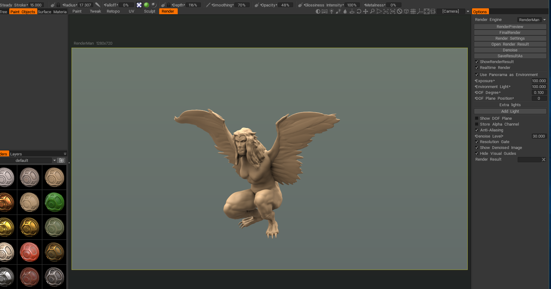

    RenderMan render
    When RenderMan appear for 3d-coat? p.s. sceernshot from official community on vk.com
