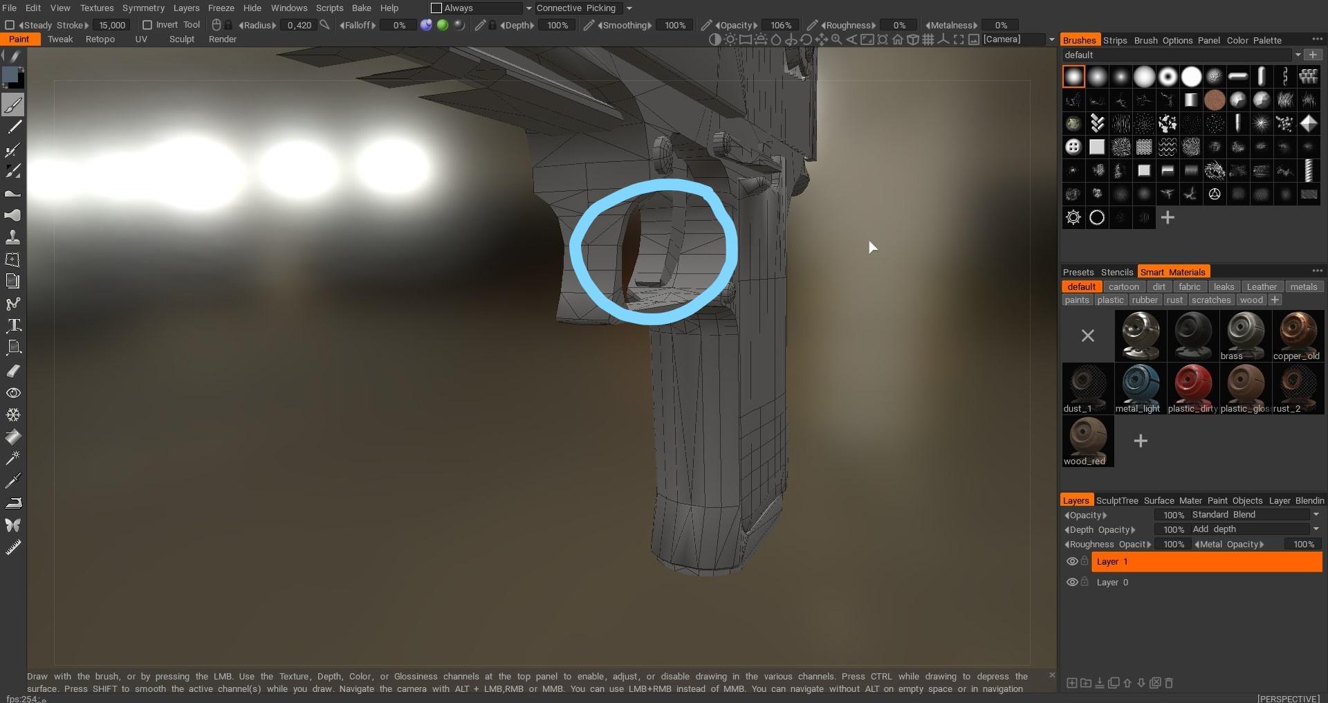

New Member tim3y Posted March 5, 2023 New Member Share Posted March 5, 2023 @Carlosana i need usp-s marked error in the picture Quote Link to comment https://3dcoat.com/forum/index.php?/topic/25652-solved-csgo-weapon-skin-models-import-holes-invisible-problem/#findComment-187048 Share on other sites More sharing options...
Carlosan Posted March 5, 2023 Share Posted March 5, 2023 Original usp-s looks ok usp-s.obj Quote Link to comment https://3dcoat.com/forum/index.php?/topic/25652-solved-csgo-weapon-skin-models-import-holes-invisible-problem/#findComment-187050 Share on other sites More sharing options...
New Member tim3y Posted March 5, 2023 New Member Share Posted March 5, 2023 1 hour ago, Carlosan said: Original usp-s looks ok @Carlosan when this model is loaded, what you sent to further is the hole that was marked in that photo Quote Link to comment https://3dcoat.com/forum/index.php?/topic/25652-solved-csgo-weapon-skin-models-import-holes-invisible-problem/#findComment-187053 Share on other sites More sharing options...
Carlosan Posted March 5, 2023 Share Posted March 5, 2023 You right, as obj = error (missing faces) as fbx, looks ok usp-s.fbx Quote Link to comment https://3dcoat.com/forum/index.php?/topic/25652-solved-csgo-weapon-skin-models-import-holes-invisible-problem/#findComment-187054 Share on other sites More sharing options...
New Member tim3y Posted March 5, 2023 New Member Share Posted March 5, 2023 @Carlosan due to the fact that I am a very beginner, is this how all models for cs go should be changed from obj to fbx? thank you for your help, YOU ARE THE KING!!!! Quote Link to comment https://3dcoat.com/forum/index.php?/topic/25652-solved-csgo-weapon-skin-models-import-holes-invisible-problem/#findComment-187055 Share on other sites More sharing options...
