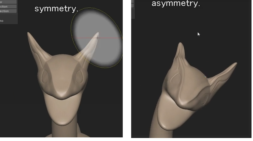

Advanced Member jene Posted January 27, 2024 Advanced Member Share Posted January 27, 2024 hello . this is Multi resolution and Sculpt layer problem. version is 2024.01 when I use pose tool on multi resolution and sculpt layer , symmetry is broken. low level resolution -> posing -> high resolution -> asymmetry. please watch this video. symmetry.mp4 and, when I change resolution level after I delete sculpt layer, the base mesh is broken. please watch this video. mlshape.mp4 if this problem fix , 3D-coat posing method will become excellent. anyone, do you know how to do? 1 Quote Link to comment https://3dcoat.com/forum/index.php?/topic/29878-multiresolution-and-sculptlayer-problem/ Share on other sites More sharing options...
Advanced Member Elemeno Posted January 27, 2024 Advanced Member Share Posted January 27, 2024 remove multires after deleting layer , should reset this Quote Link to comment https://3dcoat.com/forum/index.php?/topic/29878-multiresolution-and-sculptlayer-problem/#findComment-192819 Share on other sites More sharing options...
Advanced Member Elemeno Posted January 28, 2024 Advanced Member Share Posted January 28, 2024 yes i just done it quickly , it does in fact work if you remove multires after deleting layers and i followed your video step by step and can confirm my side done the exact same ... but for now remove multires is the work around 1 Quote Link to comment https://3dcoat.com/forum/index.php?/topic/29878-multiresolution-and-sculptlayer-problem/#findComment-192820 Share on other sites More sharing options...
Advanced Member jene Posted January 29, 2024 Author Advanced Member Share Posted January 29, 2024 On 1/28/2024 at 9:01 AM, Elemeno said: yes i just done it quickly , it does in fact work if you remove multires after deleting layers and i followed your video step by step and can confirm my side done the exact same ... but for now remove multires is the work around OK, I will try it. response thank you. (but I want to find the best way to remain multi resolution. ) 1 Quote Link to comment https://3dcoat.com/forum/index.php?/topic/29878-multiresolution-and-sculptlayer-problem/#findComment-192853 Share on other sites More sharing options...
