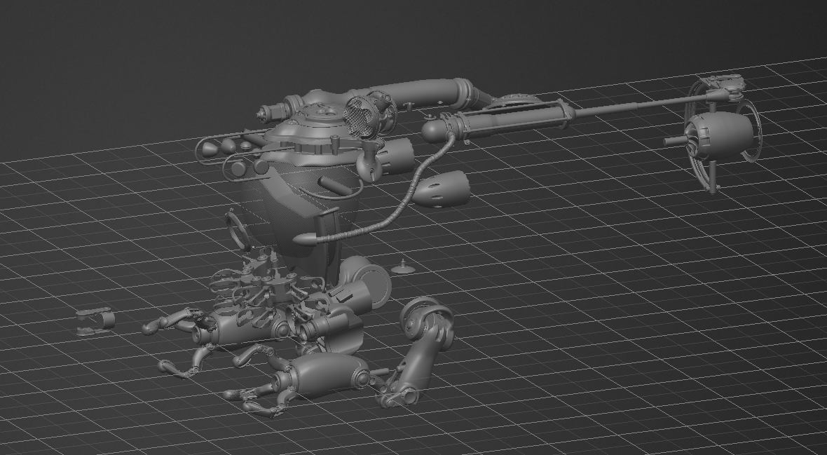

I was importing vox objects from another 3b file to the scene I was working on. I tried creating a new layer and right click, import. The objects I was importing showed up correctly, but the objects I already had showed some errors in both placing and scaling. Some of them were scattered all over the scene. Any clues?

Check if before export the model, global coordinates are freeze. (with RMB over the model to find on the Panel)

That's weird. Some objects were imported from fbx and thereby in surface mode. But others were created and sculpted in vox mode. And when I was working, I tend to apply to global space frequently, so there shouldn't have been so many errors. Anyway, I checked them again and the objects were indeed set to global space.

A picture would help.
Are the imported models at the same scale as the current 3DC file you are working on.
Just looking at all possible reasons. Of course, 3DC will ask you if you want to rescale the models to fit the current scene.
  • 0
Did you exported it as scene without any sculpt layer ghosted or hidden ?
