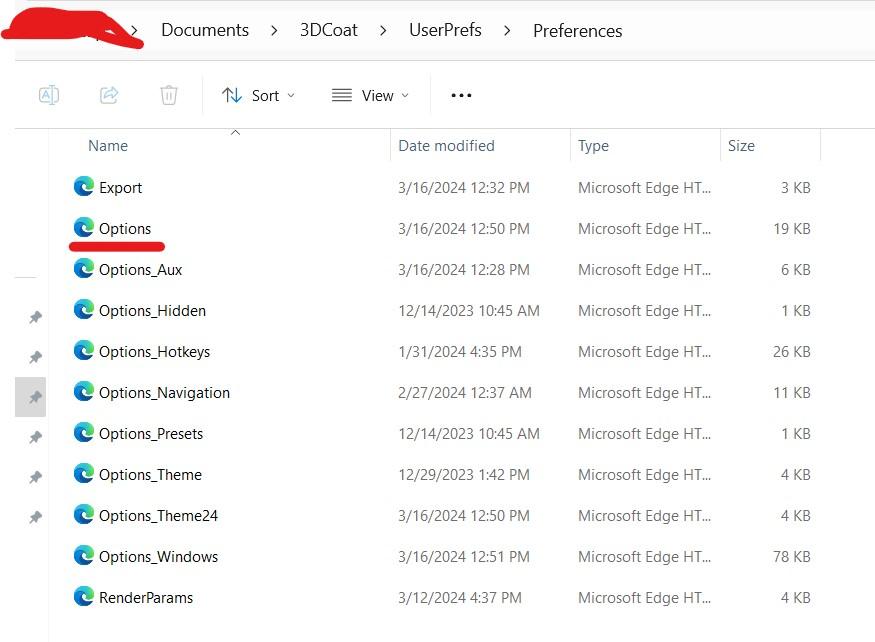

Reputable Contributor digman Posted March 16, 2024 Reputable Contributor Share Posted March 16, 2024 This post was recognized by Carlosan! digman was awarded the badge 'Helpful' and 1 points. Windows version---2024.14. Windows 11 There is "No Crashing" switching Fonts on my end. The Last Resort: In the edit menu---Choose reset to default settings. The picture shows the next screen to appear. Keep all boxes selected. 3DC will restart and then try changing your font size. I do not know your setup so of course you might lose some user settings. ------------------------------------------------------------------------------------- Before trying the above, you could try just deleting the Options.xml. Make sure 3DC is closed when you do this. 3DC will auto create a new options.xml file when reopening 3DC. Then try changing your font size. Location of options.xml file shown in picture. Quote Link to comment https://3dcoat.com/forum/index.php?/topic/30216-v_202414-fonts-and-icons-too-small-no-point-in-enlarging-them/#findComment-193940 Share on other sites More sharing options...

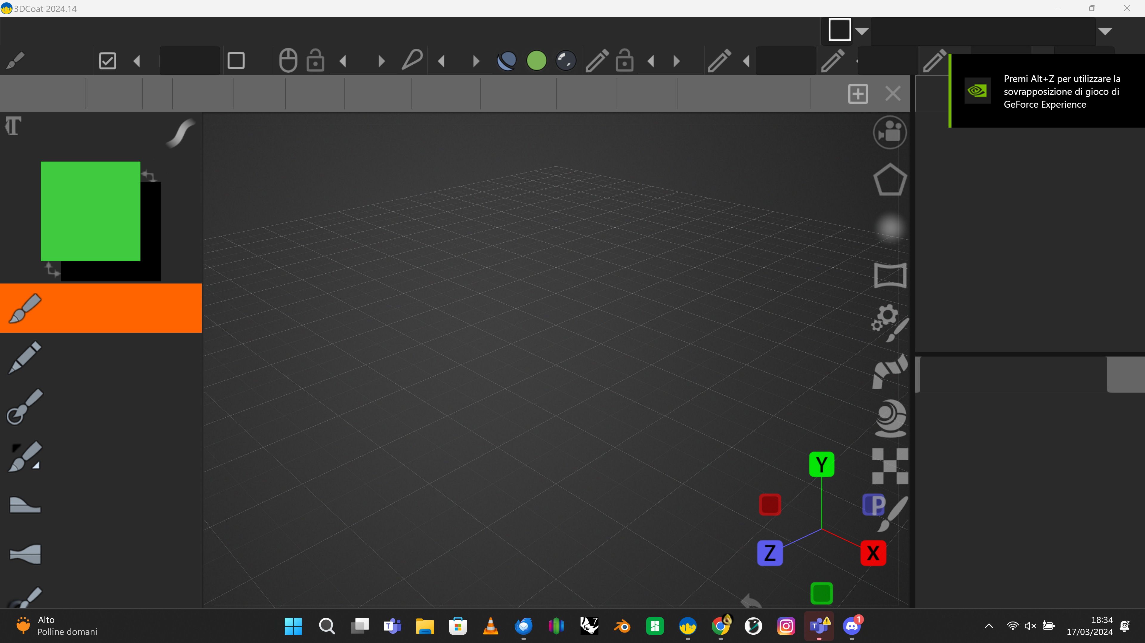

Member andreamelo Posted March 17, 2024 Author Member Share Posted March 17, 2024 Dell PC 15 9570 RAm 32gb win11 , 3dcoat 2024.14; after a long wait (20 minutes) I managed to enter font value 18 and ( and medium ) the result is the one in the attached photo. Now everything is too big and I can't access the preferences menu at the top left. I also reinstalled 3dcoat 2024.14 but everything remains the same. I deleted Options (3dcoat closed) but everything remains unchanged, I don't know what to do anymore. tell me please. Thank you Quote Link to comment https://3dcoat.com/forum/index.php?/topic/30216-v_202414-fonts-and-icons-too-small-no-point-in-enlarging-them/#findComment-193965 Share on other sites More sharing options...
Member Solution andreamelo Posted March 17, 2024 Author Member Solution Share Posted March 17, 2024 Hi, I solved it by renaming the User/document/3dcoat folder, and he recreated it with default settings and font too small (it doesn't reset by only deleting Option file from preferences), then I inserted font_size medium and font with value 10 in Preferences/theme and after many minutes finally everything appears correct. Thank you :-) 1 Quote Link to comment https://3dcoat.com/forum/index.php?/topic/30216-v_202414-fonts-and-icons-too-small-no-point-in-enlarging-them/#findComment-193966 Share on other sites More sharing options...

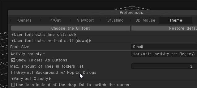

Member andreamelo Posted March 26, 2024 Author Member Share Posted March 26, 2024 I don't know what to do anymore, if I right click on the sculpt tree a gray screen appears and I don't see the options, if I'm in voxel mode everything is clearly visible (why?). I have size 10 fonts, if I insert size 9 everything appears perfectly, this is a BUG please fix it; I'm old and wear glasses, I can't work with small dimensions, and in any case I use many other software and only with 3dcoat do I always have viewing problems Quote Link to comment https://3dcoat.com/forum/index.php?/topic/30216-v_202414-fonts-and-icons-too-small-no-point-in-enlarging-them/#findComment-194043 Share on other sites More sharing options...
Carlosan Posted March 26, 2024 Share Posted March 26, 2024 Edit > Preferences > Theme Grey-out Background w/... is turned OFF ? Quote Link to comment https://3dcoat.com/forum/index.php?/topic/30216-v_202414-fonts-and-icons-too-small-no-point-in-enlarging-them/#findComment-194044 Share on other sites More sharing options...
