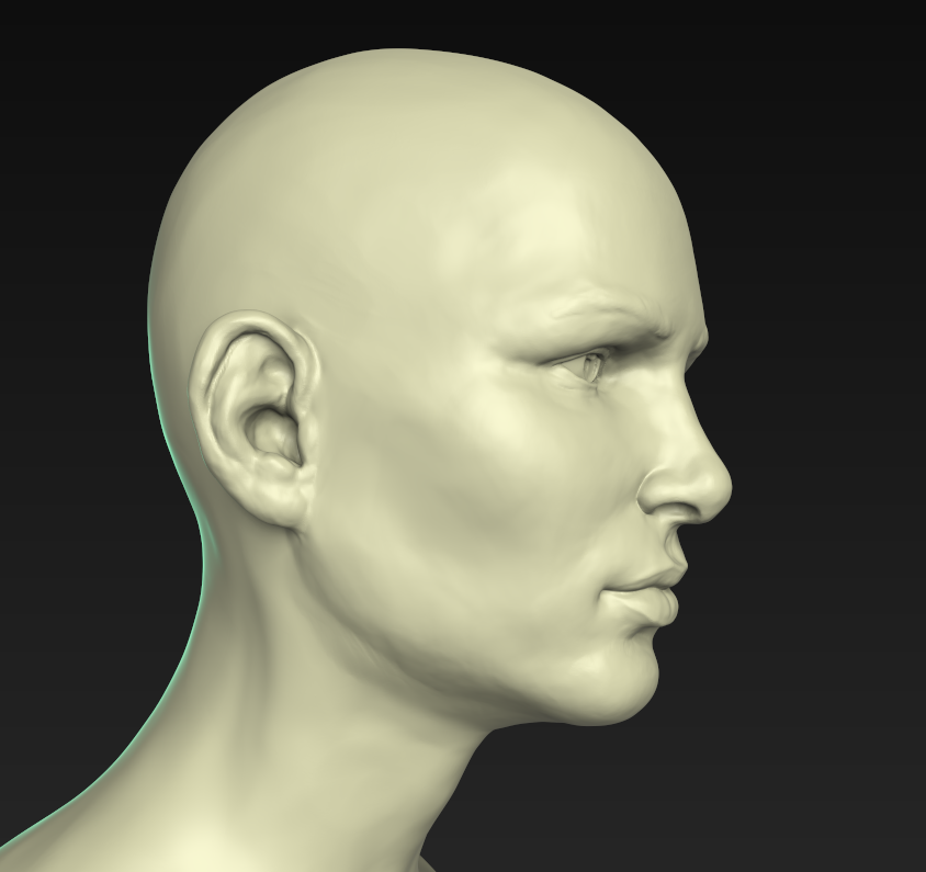

I have finished this sculpt now to where i am happy here is the finished shot of sculpt and retopology
High detail below -
Projection -
Projected onto new topology -
and Wireframe below nothing to spectacular.
I hope you guys like it.

Hi Scary M,
These are all great! But a question for you, I dont know if i am being dumb or not. A few posts back up the thread there is an image of a retopoed wire frame and you say Its projected. Whats all that about? I an not sure I am understanding it.
The way I work these days is ... I  sculpt in 3dcoat, vertexpaint then export it to Blender and render it ,as long as I keep under about 20 million polys , everything works out fine for me. Quick and simple
But Im always willing to learn  something new ( if its not to difficult!)
Or... when you say projected do you mean baked ?  I can do  retopo and bake , but life is generally to short for me to do that when I can get where I want to go as detailed above. And I think i have heard of projecting details but thats about it.
ta  Stu

Hi Stuart, there are two ways to look at it, and it depends on what the result will be used for.
The first, I predominantly want stuff game engine or animation, therefore baked is a term to transfer detail to the game/film asset. dependant on the level of detail required I like to do a pass in zbrush or sculpt completely in zbrush, we get better results detail wise from the brush engines in ZBrush if we used an optimiesd quad poly mesh. re projecting detail is taking a high poly in this case voxel or surface sculpt form 3D coat and retopologising the subdividing retopolgy and projecting the fine details from the high poly sculpt to high poly retopology. This way if we have UV on the retopology it remains intact and it is a direct transfer of detail rather than a projected normal.
This is why 3d coat asks if we want to subdivde our mesh before we bake. A common workflow would be to take 3dc sculpt into zbrush, with retopology and re project details through all levels of subdivision on the retopology, then we can do very fine details in ZBrush then bring mesh back into coat for map baking. as the UV of retopology remains consistent this give best results
Games/Animation require a much optimised mesh for realtime and deformation, try animating a 20 mil poly mesh and watch even the most highspec system turn into a slide show. you mention as long as the mesh is around 20 million. retopologising may help you simply from  work with sense. The diffenrence working with a optimised 20k mesh compared to trying to work with a 20 mil heavy mesh is night and day.
or The Second if all your doing is sculpts for still images with no animation or game engine in mind simply sculpting in Surface or Vox is fine though i would say optimising the mesh wouldnt hurt for both detailng and work with. Hope that explains it.

Hi, Thanks for the reply Scary M, Yeah I think I am getting it. I think I was looking at your sculpts and thinking what is he doing all that for when he can just render what he has already. So basically with these sculpts you are just thinking ahead,with thoughts about animation and games.
I used to retopo everything and then have a load of assorted maps to apply. So everyting used to take days to complete. The novelty of drawing little squares has worn off now . I used to use zremesher which saved a bit of time sometimes . But having just passed another significant birthday, the days are just flyng by so I try to spend only acouple of days per project. I have had an actual 'client' recently and I think part of the reason he asks me is that he knows he will get 3 characters emailed  out in about 2 days!
I always wanted to do it the 'proper' way with all the maps and everyfink. But it turns out there is no proper way is there . Unless you are sending stuff down a pipeline.
